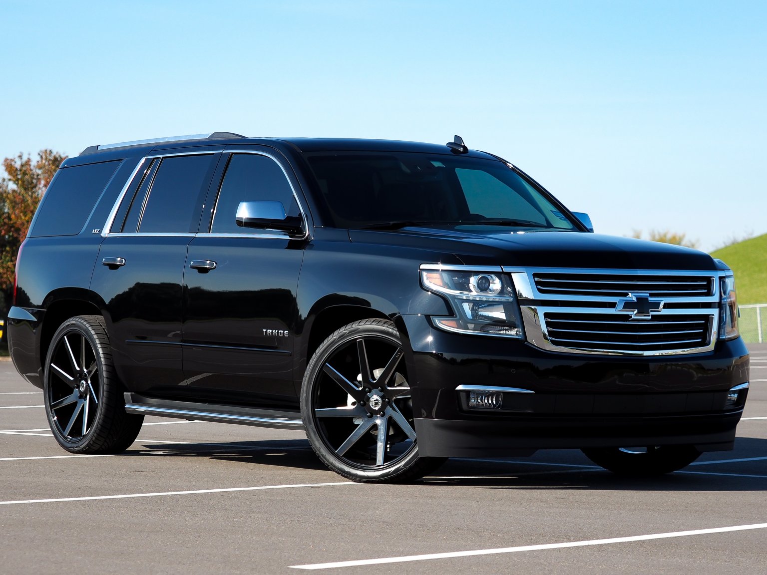

Took this shot about a month ago. Not the greatest, but at least you can see the annoying gap difference between front and rear.

1) remove upper spring insulator and the the 5\8 heater hose mod I've been doing on them
2) my autoride links to get it to sit lower
3) you will need to cut bracket off frame to get a decent ride if going lower.
4) my endlink kit will fix the away bar angle for better ride and cornering and will need my bumps top if cutting off bracket

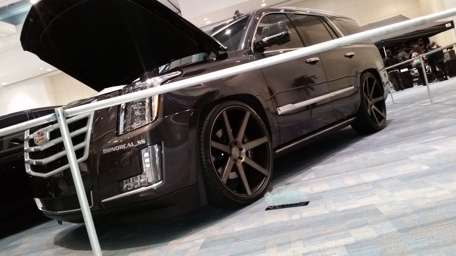

Attached one done recently. My custom 2/4.5 kit

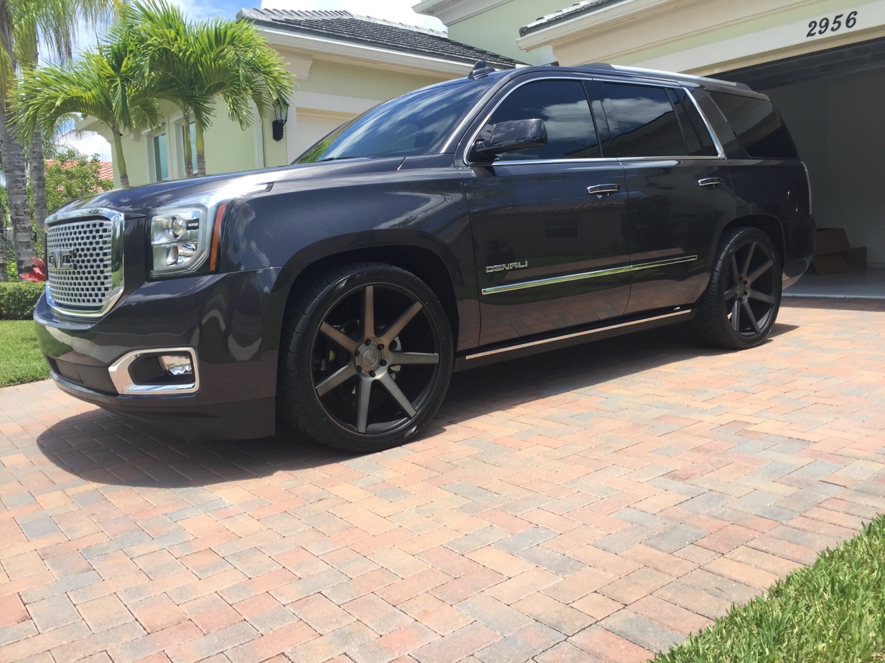

My escalade with my custom 3/6 kit
295 30 26
32 7/8 front ground to fender lip front
33 3/16 ground to fender lip rear
