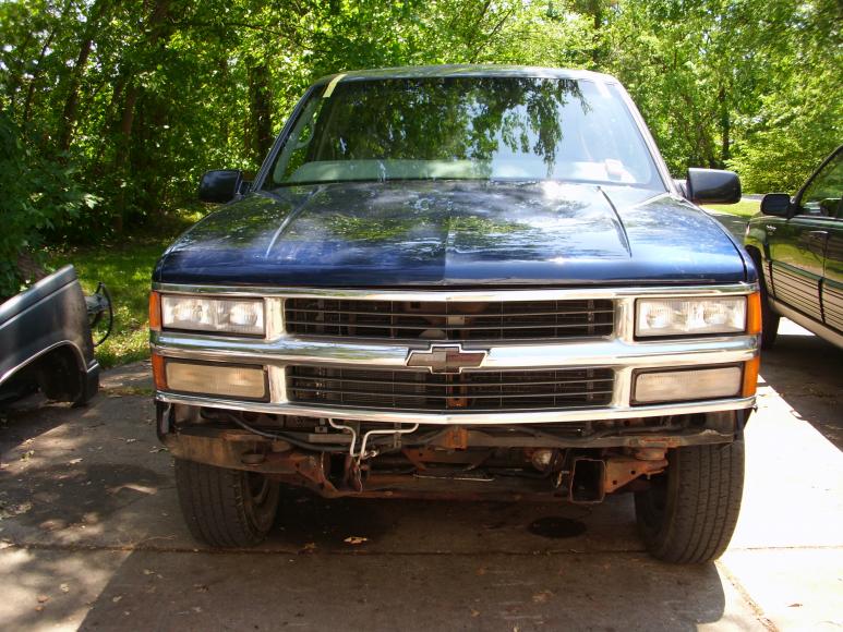

Well, I ended up doing some trading.
Traded a car that I was getting ready to send to the bone yard, and a 100 bucks, and brought the front clip home. Now I need to figure out the best way to get the black paint or what ever is, on all the lights, off, geez ! black head lights :shocked:

I was able to do some work on it in spite of the 100 degree weather.
Got another piece of the puzzle at the JY today.

Awsome project bro.. cant believe it only has 56k miles. it should run like a cream puff. Good score on the clip. Ebay has the complete light set up (8 peices) for about $75 or $85 shipped.

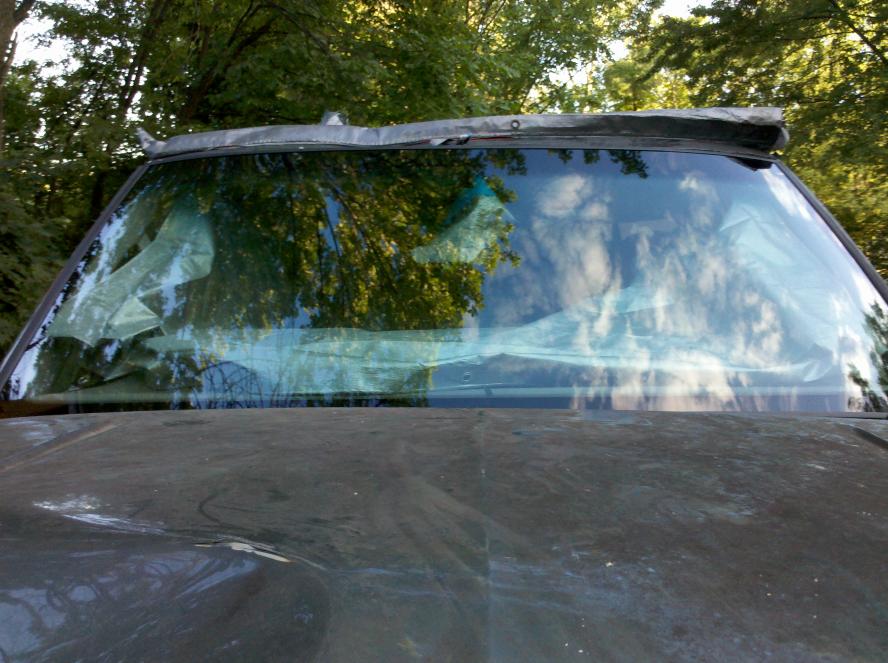

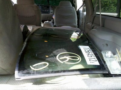

Old,Windshield cut out, New JY,Windshield installed.
Fuel pump DOA
Dropped gas tank, cleaned tank, wired new fuel pump wire harness

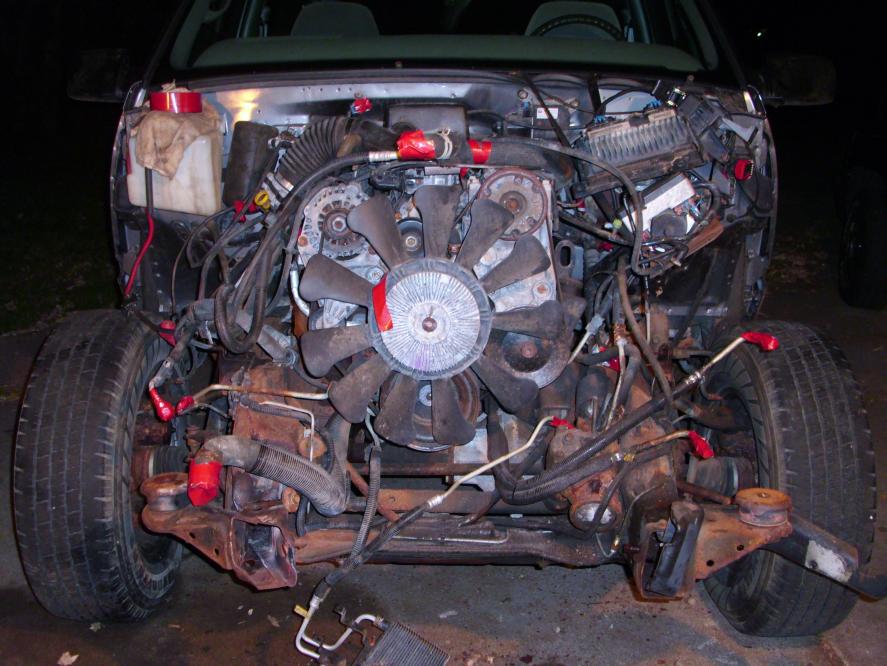

I got the Hoe running good, then I push on the brake pedal and blew a brake line upfront that was rusted,. It runs across the front to the right wheel, it's kind of hard to get to, but the good thing is, once I pull the front clip off , I will have easy access to it, and that's the next order of business to pull the front end off.

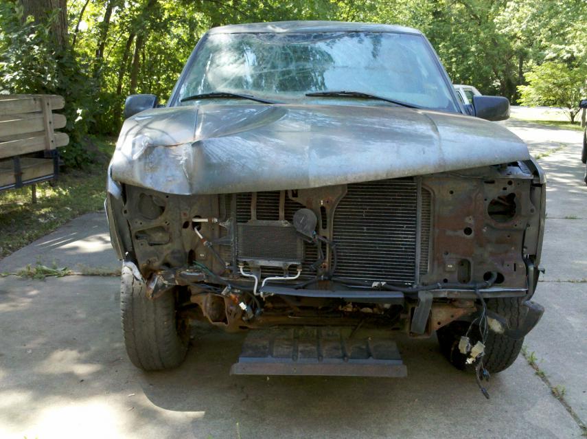

I made some good progress
First Pic Before, Second Pic Yesterday, Last Today

Nice!!! How did you get the roof fixed and squared up again??
50,943
19,377
Bumped it out and put a little extra urethane in there, no leaks

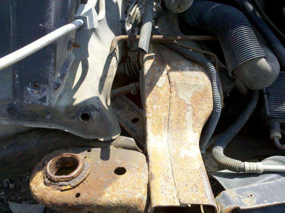

I notice on the passenger side that your frame is still bend in pretty bad. Have you gotten to a shop yet to see if they can pull that out for you?
The front end of the frame is mangled, I have to chop off 8 inches, go to the junk y, cut off a new 8 in , and weld it on. So I can mount the center support and bumper properly. I found the donor Suburban at the JY with the center support already removed. As matter if fact I got a pic of the Burb.
I put it together temporarily, so I could start it and move it , I still have to pull the center support back off but, I don't have to remove the radiator, just raise it up. I made a big boo boo, tore it apart in the wrong place, I need it where I can reach it with the 220V welder that has a short cord :lol2:
