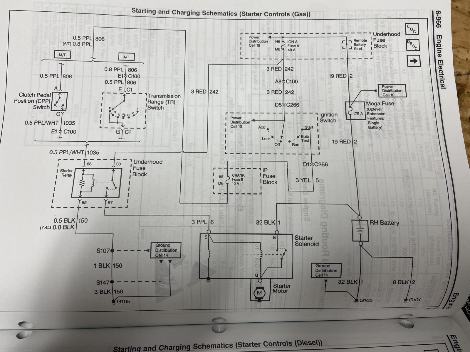

Here’s the wiring diagram for the starting circuit. With someone holding the ignition in start, check for voltage on the small purple wire at the starter. See if that wire is even intact - I’ve broken two during starter replacements.
If no voltage there, start checking further back - the CRANK fuse and starter relay are the more accessible points.
Edit: Does it start in neutral?
