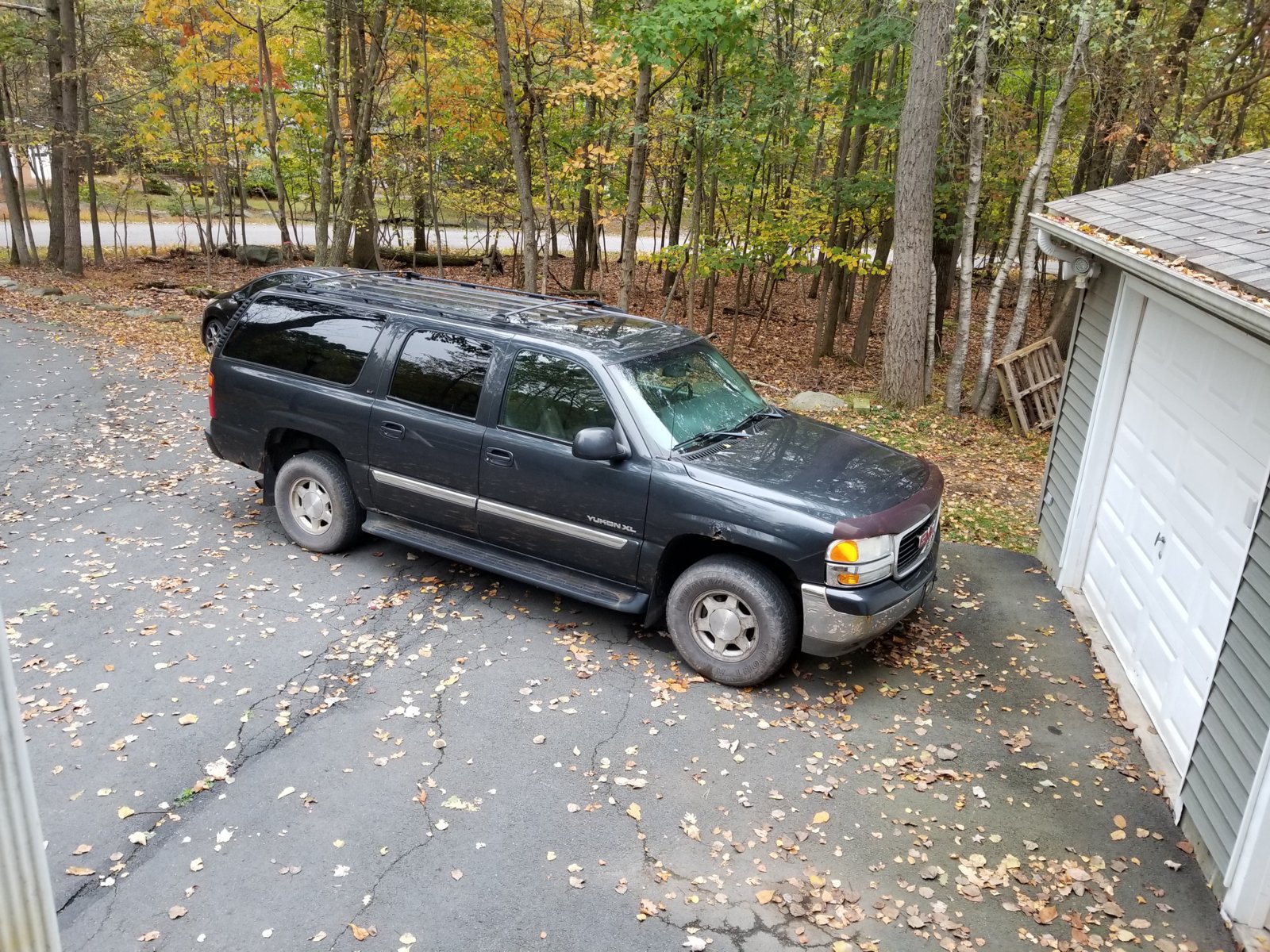

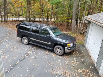

Hey guys, just picked up a 2003 yukon xl 1500 slt.
Got it from original owner with aboiht 150k miles. It was siitting for about 5 months before he sold it to me for $1800.
On my way home engine and tranny ran great with no leaks anywhere underneath. Although some panels are rusted pretty good. Basically around the fenders.
The one issue I had is a message to service stability popped on. And got the tc and abs lights on. Then the left front abs kept kicking on when slowing down. When starting, I'd get reduced power due to stability.
I believe All this points to the abs sensor needing cleaning or replacement.
Any thing else it could be or is it most likely the sensor?
