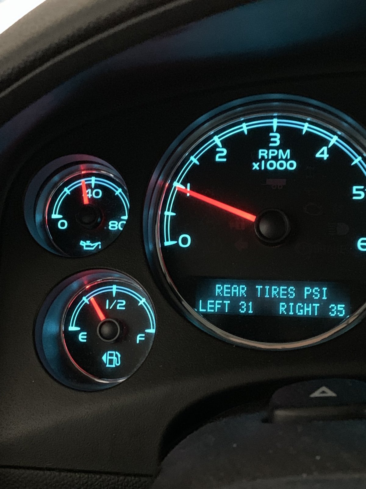

If the press sensors doesn’t fix it, this likely will too.
Today I tackled my constantly low oil pressure by replacing the oil ring that fits on the oil pickup tube just as it connects to the oil pump.
The pictures below are the cold before and after the fix; hot before and after. My Yukon has 178K miles and I run 5W-30 with an AC Delco oil filter.
I would call this a success. I'll let you know if it quiets the cold (as in 30 or 20F) cold starts in the morning as my lifters have the LS usual tick for the first 10 or so seconds.
Photos are Cold and Hot before fix and then Cold and Hot after fix:
View attachment 217442 View attachment 217440
View attachment 217438 View attachment 217441
