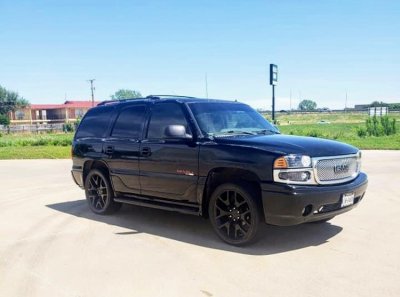

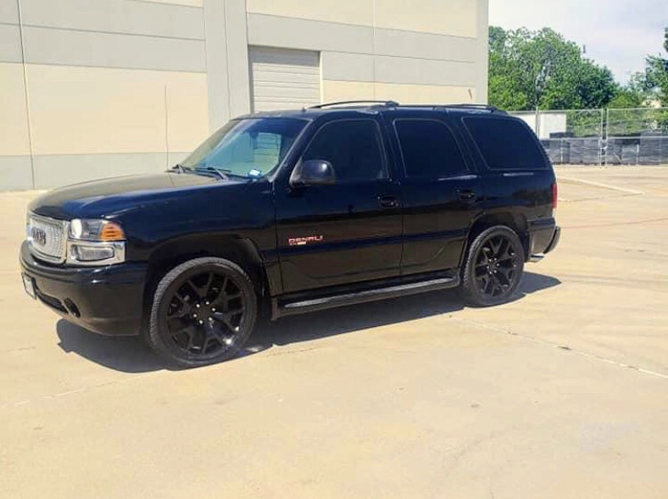

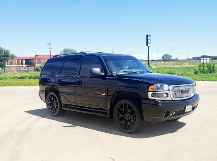

Here's how she sits now. She's a little rough but I like a project haha
