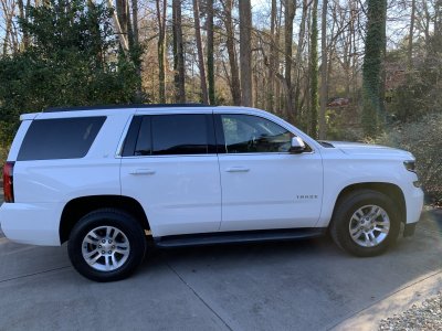

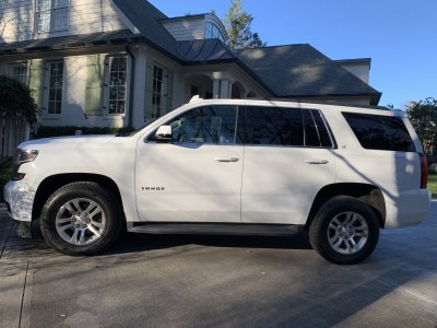

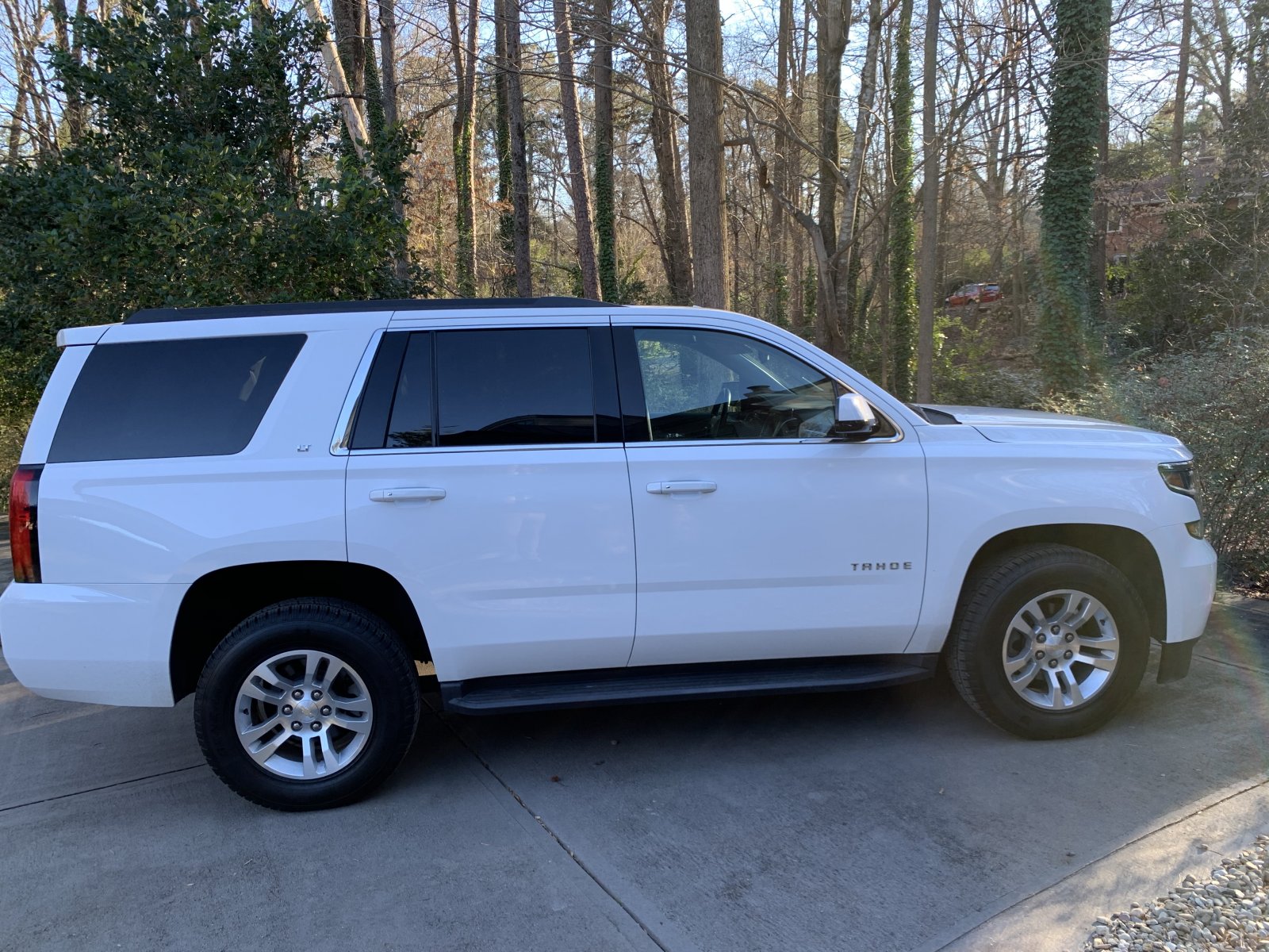

I just got my first Tahoe, it is a 2016 Summit White LT with Black interior and luxury package. (no dvd or sunroof). It has new Genera Grabber HTS60 tires installed. Wheels are the 18” size. Had 43,000 miles on it when I got it.
I have a few questions:
1) I noticed that the front looks slightly lower than the rear around the wheel. It appears that a lot of people have leveling kits installed to correct this? What are the advantages or disadvantages of doing this? Seems like it would look better.
Anyone have any pics of one like mine with this done?
which kit do I need? I don’t want to lift the back anymore just level the front.

Welcome from Virginia. Leveling can be done either way. Raise the front or drop the rear. It’s a matter of taste. I prefer lower but not everyone does. As long as it’s done right there’s not much risk going either way. Both can be done in your garage there are tons of posts here.

I had thought about if that was possible to level the back, thanks for the tip.
Why do these trucks come stock with the front lower than rear? IS that typical of other SUVs? I'm just wondering if there is a good reason to leave it alone?
In case you are towing something
