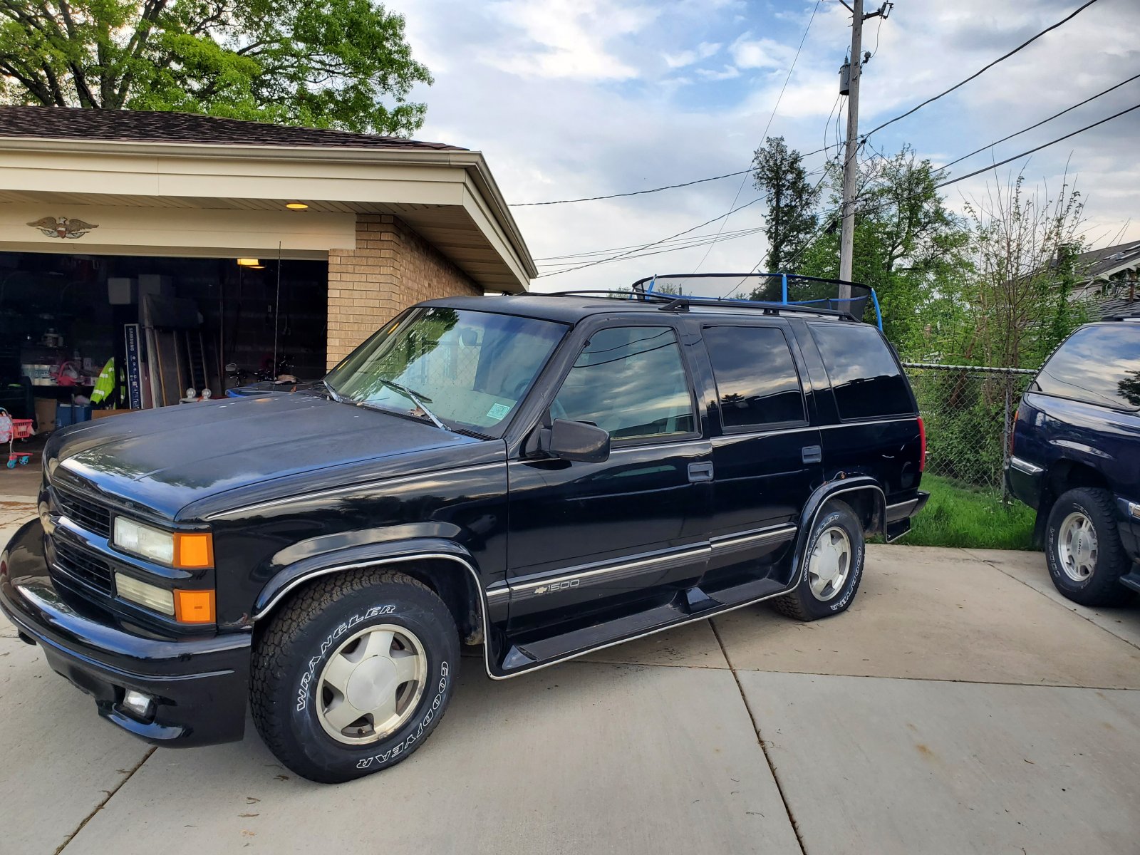

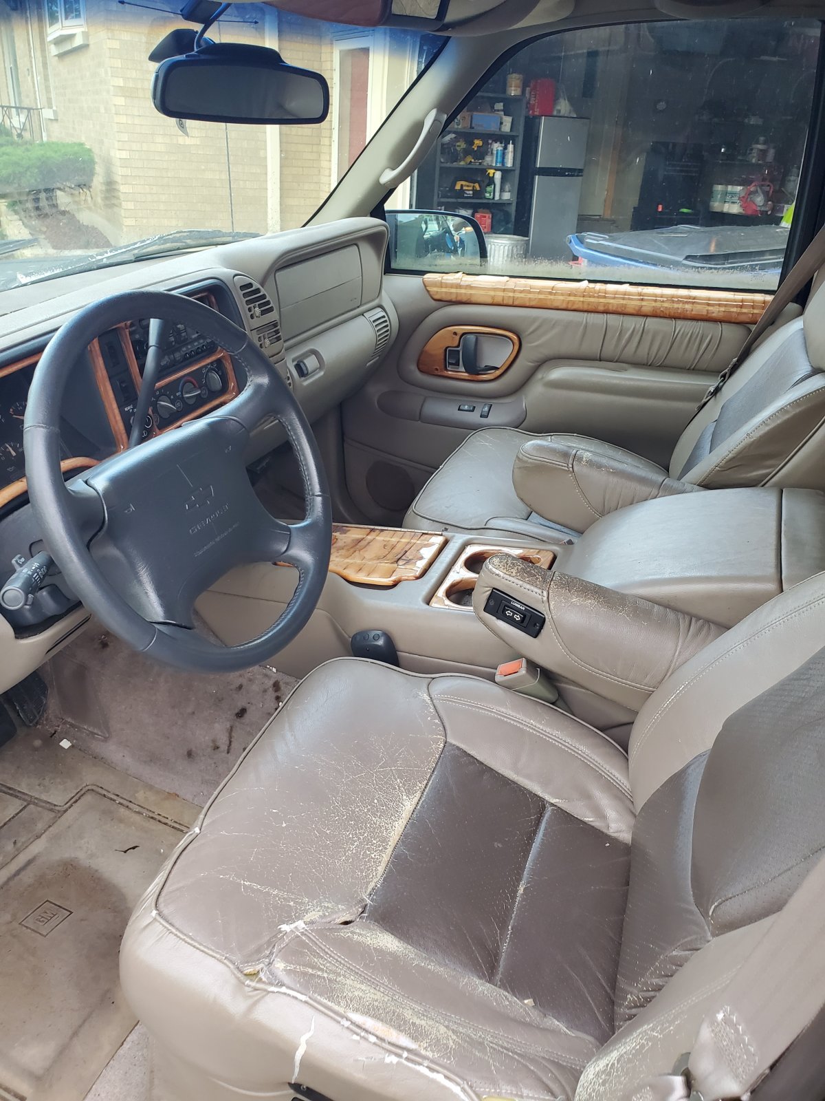

Here are some pics

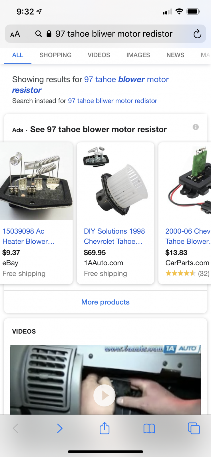

Now any help would be fantastic. I was messing with the blower to see if i can get that started, but no luck.
Here's whats happening, when i turn the fan switch on nothing in 1-3, but when i put it into 4=HIGH i hear and felt the relay under the passenger dash flick like its trying to start. Would that mean a new blower or another issue?

actually probably the resistor...9x out of 10 which is right near the blower motor... they go bad. i have heard of the dash switch going out but easier and cheapest is the resistor first.
Thanks I will check it out and update
