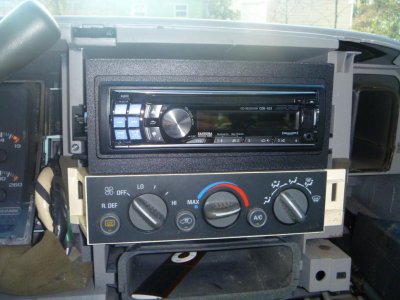

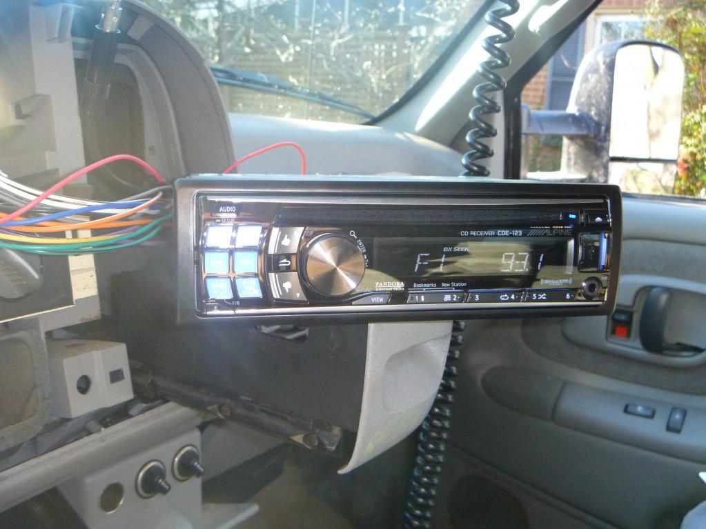

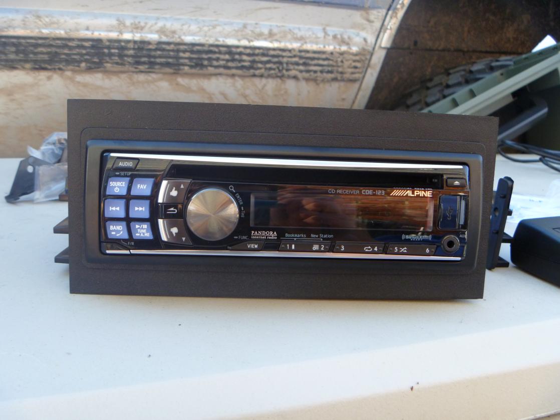

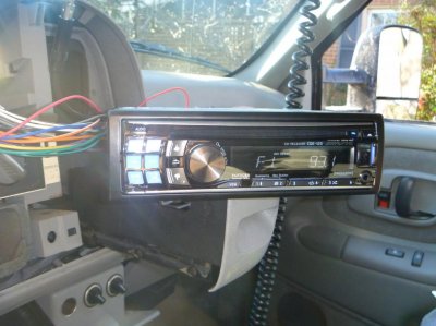

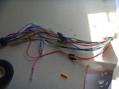

added pics of install. kinda a step by step of some sort

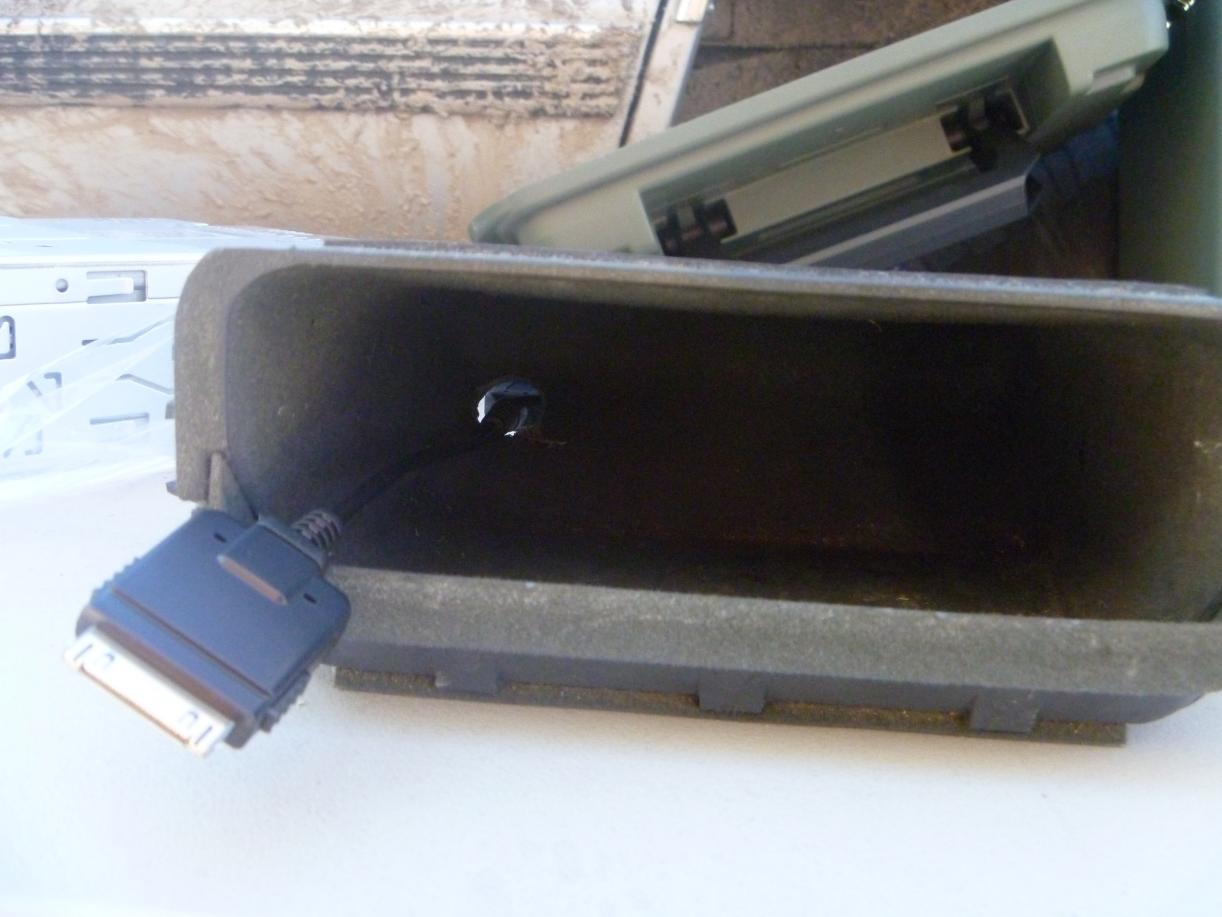

all in all not too bad for my first install. maybe 2 hrs or 3 but i get distracted easily lol and my buddy was over so i was helping him 4high his dakota in the time i was doing my radio. longest was the harness just soldering it all up. then plug it in and all works but rear doors :/ drilled a hole in back of the cubby and ran the ipod cable there. they gave me so much i could prob run it to the glove box bt i like the location right now its nice and clean. all the stuff was picked up at auto zone besides the radio was real happy when they had all i needed and i had gift card there

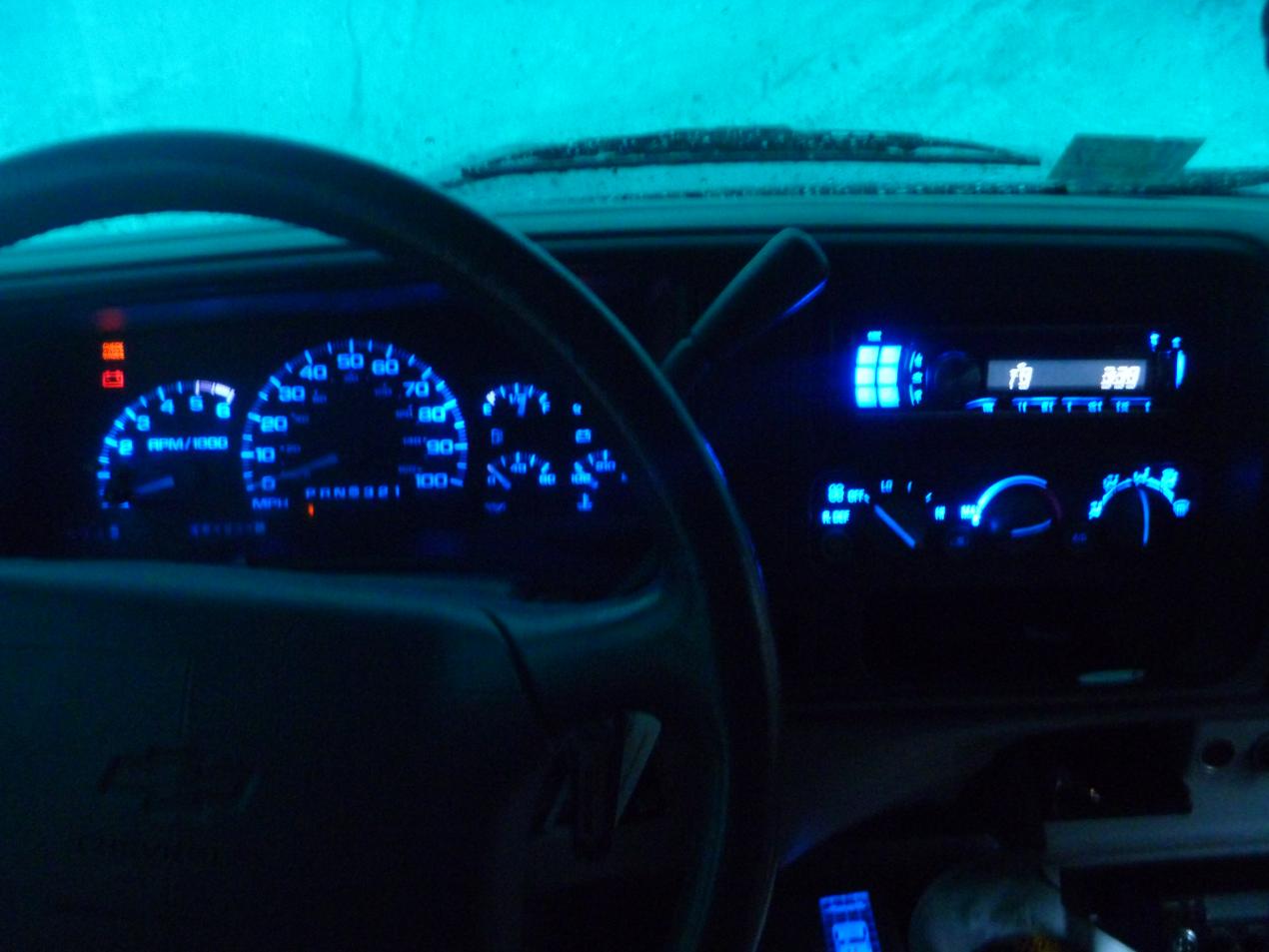

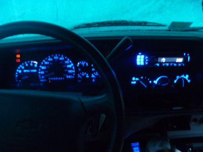

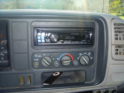

night time shot...
did some messing around and found out the amp gets power when the radio is on tunner but in the other functions its not so i ran a wire from the power connector on the amp plug to the remote wire from headunit and solved that problem.
