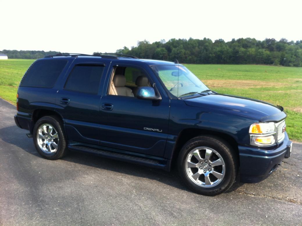

I think that's about it for now. I've attached a pic of the new ride below!

Looks great! I love the wheels and the slight drop it has from the factory. I want that on mine!

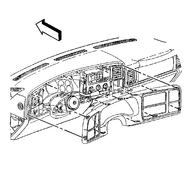

There are many different ipod inputs that you can get. I am sure someone will chime in on that. Removing the radio is a piece of cake. You just pop the bezel off around the radio. Make sure steering wheel is all the way down. Also, put the gear selector in 1st. Careful when pulling it out because the hazard switch can scrape that extra-delicate soft touch grey paint off.

Welcome bud. The vehicle itself, the unique color, and rare rims looks GREAT!

Those CK805s are so perty I'd never take them off. :)
Dash:
Awesome! Thanks for the quick reply. Maybe I'll look into what I can do about the 20s from my '99 looking so bad. The previous owner didn't take care of them - so they're peeling like crazy. I hate to throw rims that look so bad on the new ride - even if it is winter.
I figured the dash was a piece of cake. Thanks for the diagram! That will help. I'm thinking I might just go with a DD that has built in Bluetooth and Aux. I don't see why I'd spend upwards of $200 for the Aux only. One question I do have for those that have installed DDs - do you lose any of the rear entertainment features? I saw that asked in another thread but it wasn't answered. I want to keep everything as is, other than adding Bluetooth and Aux.
