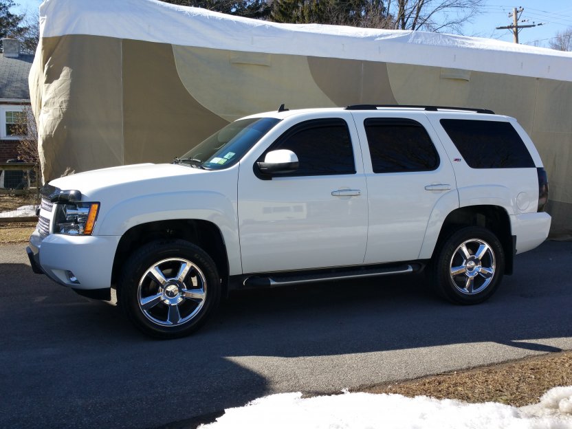

Went 2 in the front and 1 in the rear. (Insert joke here) gives it just a slight rake.
Word of advice for the install. Rent a spring compressor for the rears. It was a pain in the ass without it.

39 in the back and 38 1/4 front with 3/4 tank of gas.
