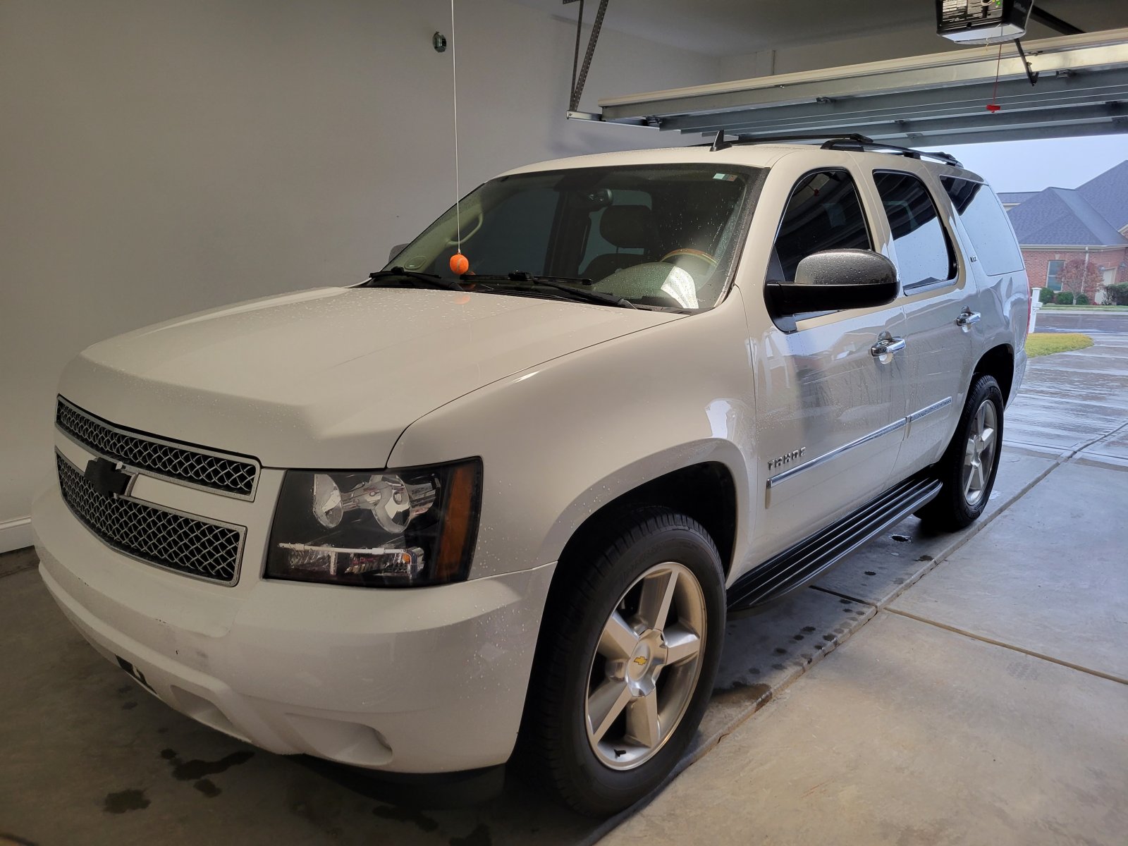

Hey what's up everyone, new member here. I am trying to figure out the best look/fit for my wife's 2014 Tahoe LTZ 2wd. I have already ordered a 1.5" Front Strut Leveling Kit because that's all I need to level the front with the rear. I am really wanting to go with a off-road style black/milled wheel in either a 20x9 or 20x10 but I keep leaning more towards the 20x10. What I currently looking at is the Black Rhino Sierra 20x10 with a -12 offset on either a 275/60/20 or a similar size tire. What tire will fit/look best? Also, according to https://tiresize.com/wheel-offset-calculator/ the wheel/tire will stick out 1.69" further than my current setup. Do y'all think that is too much? I am definitely not wanting a really wide or aggressive stance, but I don't want them flush or tucked. Feel free to post pics of your setup so I can see some options! Thanks!

To be completely honest, I am probably not the best guy to ask about wheel and tire set-ups, but keep in mind that your wheels are just shy of being flush with your fender. If you kick it out 1-5"+ further, you will be slinging road grime and such all along your nice white Tahoe.
I like the look of the rim, just not the idea of kicking your wheels out that far.

Yeah you don't wanna be grinding them LOL. Welcome! She looks nice!

I lifted mine 2" in the front and 1" in the back to sort of level it but keep a slight rake. I added 1.5" spacers to each corner to keep the height-to-width proportions even. This was all purely for appearance and only because I had some mildly aggressive tires at the time. It's a 2WD, I don't go off road and I planned to lower it. Which, I did about a year later.
As mentioned, you will throw dirt, rocks and road debris up onto the paint.

^^x3^^ You will eventually ruin that nice finish on the fenders and doors, if you go with tires that protrude from the wheel wells.
I don't know for sure what the offset of your OEM wheels, but I can tell you that a 20" x 8.5" wheel will most likely allow you to go with a 305/50 x 20 tire with no rubbing.
