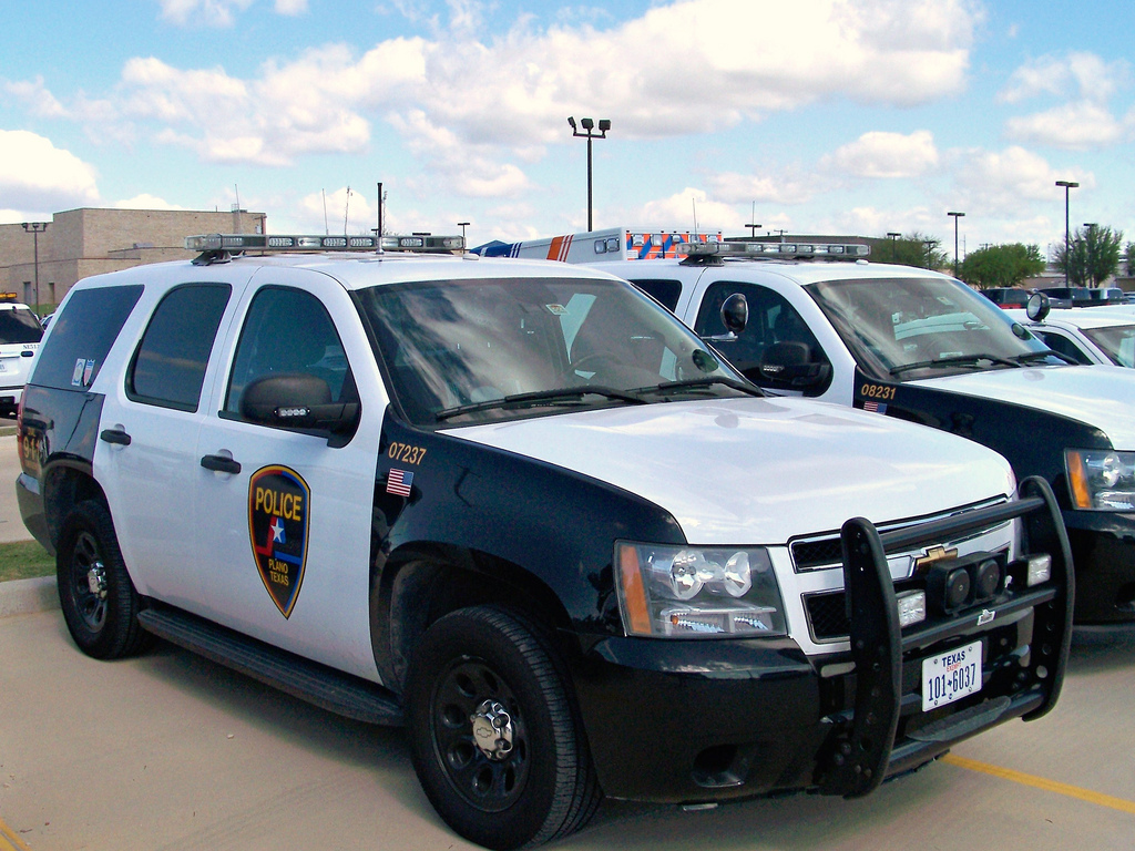

Im new to this forum, and honestly after looking at online forum for quite some time for reference help, I decided to drink the kook-aid and join in. Ive owned many GM full-size, and have fallen in love with my latest project. Its a 2007 tahoe PPV. Vehicle was bought in Plano texas with hopes the plans to build it back to a highly optioned truck on a budget. The whole budget thing quickly went out of the window. Cant wait to get some helpful insight and build ideas.

Thanks all for the welcome. I apologize as i don't get around the computer much but its nice to have this kind of resource around. @iLikeEggs . My tahoe started out with just over 110k. Its now sitting at 128K so I haven't gone crazy with the miles. I will have to post some pics of it currently. Possibly do a build thread. If only i could figure out how to do that....
