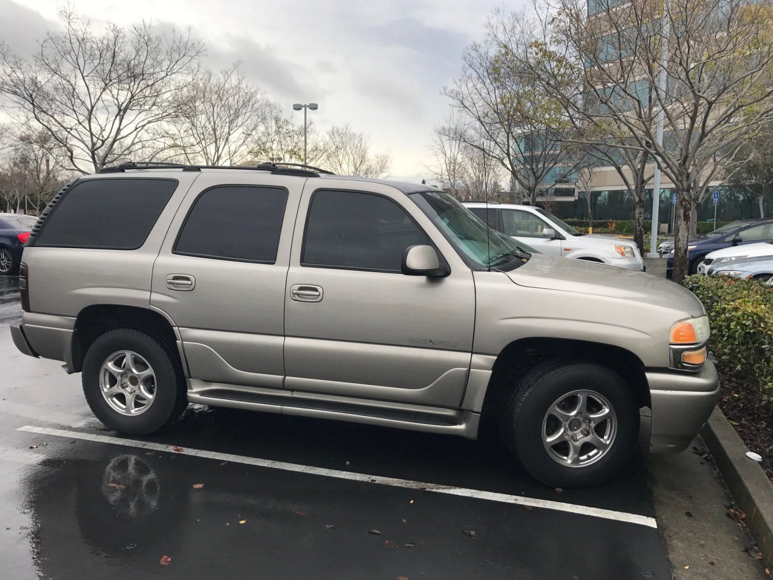

Hi. So recently became a proud new owner of a 2001 Denali.
2001 with 112k, well kept and serviced.
Mods include dual flow-master exhaust, tinted windows, after market stereo deck.
Love the engine and the ride so far but the mod bug is creeping in.
Searched but have a few questions:
1. Have a few scrapes on the body but can't find the paint code for touch up paint. where is it located? Can someone recommend touch up paint brand that matches up well?
2. Looks like denali All wheel drive system does not have a 4-low which is fine.. i do see a "towing" button on the shifter. What exactly does it do?
3. what is the largest size tire i can fit on the stock 17inch rims without rubbing?
4. if i wanted to upgrade to 20 inch wheels from escalade, newer GMCs, etc. do i need any leveling kits?
5. my understanding is that if i went with 20inch wheels, perfect tire size is 275/55r20 or 275/6R20. Would a wider 285/50/20 tire fit without rubbing?
Your RPO sticker should be in your glovebox with a bunch of code numbers.
http://www.automotivetouchup.com/?A=437&SubAffiliateID=Automotivetouchup_e
By looking up your year and model at the above site and your picture, it looks like you are one of these colors. Try to cross reference what is on your RPO code sticker.
11, 382E, WA382E Pewter Metallic
14, 391E, WA391E Storm Gray Metallic
