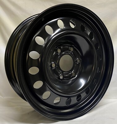

17’s are alright on the NBS Denali but our NNBS / Gen 3 / 07-14 Denali requires a min of an 18” rim due to the offset and larger brakes on the 6.2L.
18” (5.5” wide) steel spare rims are an option but really inadequate for a 6.2L AWD platform.

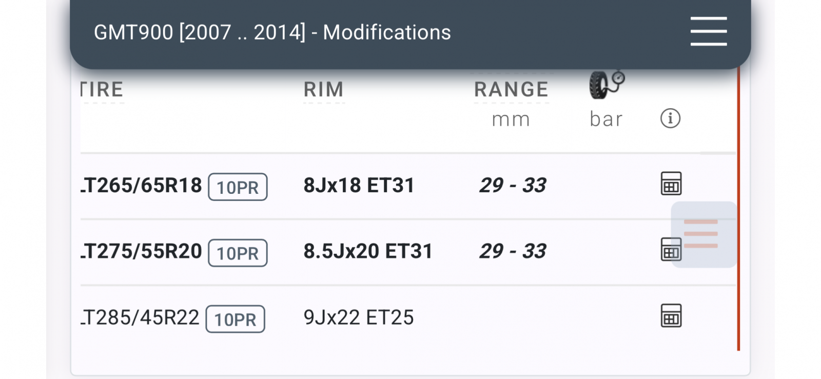

18x6.5 is the factory offset for a NNBS Denali with 18”. This means you can use the 2015-2020 Tahoe rim selection of 18x6.5.

So I did a brief comparison between 265/70r17 tires and 275/55r20 tires because that is the size you currently have and would likely be going to so that the overall diameter stays the same. For most tires, the 20" tires were the same price, within 30 bucks or so of the 17s or were in some cases much cheaper. Like for Michelin Defender LTX MS/2 the 20s were actually $54 per tire cheaper. Plus there were more tire options to choose from in 20s as well. Might be a better idea to stay with the stock wheels unless there is something wrong with them and need replacing and even then I would stay with a 20 for the larger tire selection.
