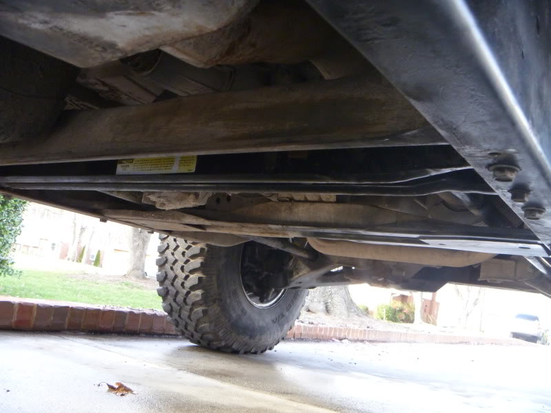

so i got a problem... a while ago i put in truck bars so i could level my truck with 2inch bar. all was wellfor a while but last night out muddin i hit a big ass hole and poped one out was a pain in the ass getting the bar back in in the mud.... now the truck bars are 2 inches longer so thats part the reason. im lost as what to do. eithe swap my stock bars back and put my 33s letting me save gas, ride better and save more money to lift it right. or try and cut down the bars and keep the 35s on. i want to straight axle it and be doen with the ifs. mine feels liekits going to fall apart and ive replaed everything. ti has the slopiest steering ever and worst brakes. he did his tahoe not too long ago and he said he could help me find all the parts for around 1k probably a lil more. would be 14ff rear and d44 from a f250 upfront. id then ditch the bl and be all suspension. or i could do ifs lift and ditch bl.. but it woudl still ride and handle the same and i realy dont like all of the moving parts up front and i dont think they like the 35s too much either. really only options i have are a) downsixing to 33s and save for either b) ifs lift and put 35s back on or c) straight axle this summer and be done with all the crappy steering and brakes

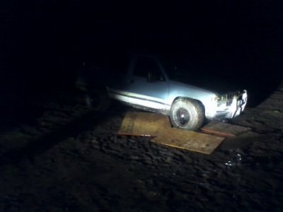

the damn thing poped out last night again and bent my fender and broke the plastic piece by the bumper. i got it home and it sits now till i get that crossmember tomorrow

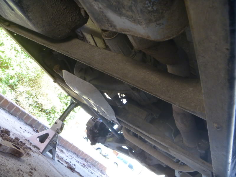

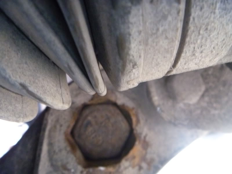

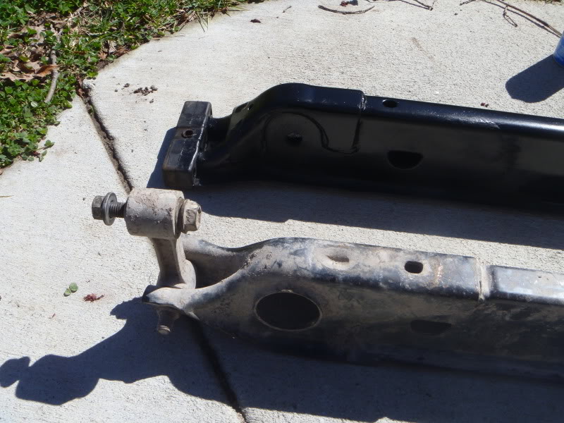

well killed to birds with one stone this weekend. got the crossmember off a suburban installed. was a royal pain. drilled 6 holes and its all good to go. it moved back an inch and a half. its perfect now no more of the t bar stickingout of the control arm. also got a 4wd actuator from the junkyard too and swaped the plug and now i got a working actuator :) anyone on here have any interst in getting the skid plats off the burban? i can go back and get em. saw 3 overhead consoels too and a white gmc grill but a corner was broke :/ and the yukon had fender flares but i missed em :(
