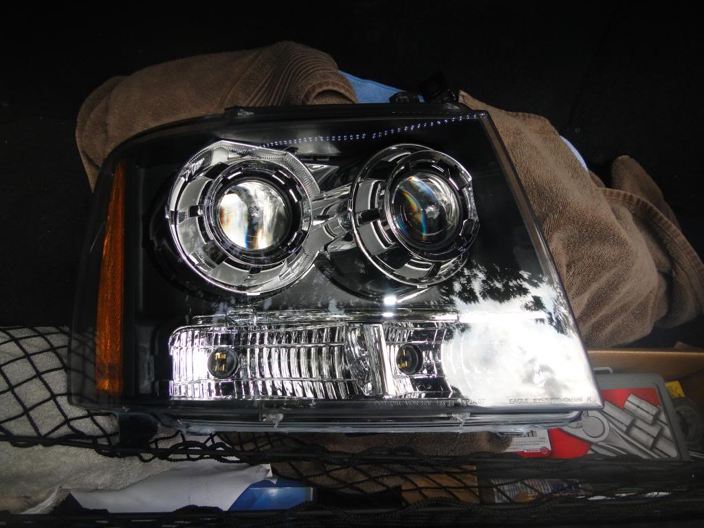

JB from Black Flame Customs really took care of me. I'll spare the specifics and just show the pics. The headlights are fantastic and the fit/finish is very good as well.
PICS HERE

Retro looks amazing, as if it were OEM.
Chrome bug deflector ... :(

That's the most flashy bug guard on the board FTW.
I do like the retrofit. Night time pics please
