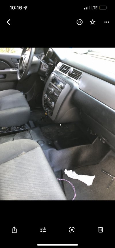

First Picture- Can I just strip out and sell these modules from inside the center console? I'm removing the center console soon to clean so I'll get a better look at them.

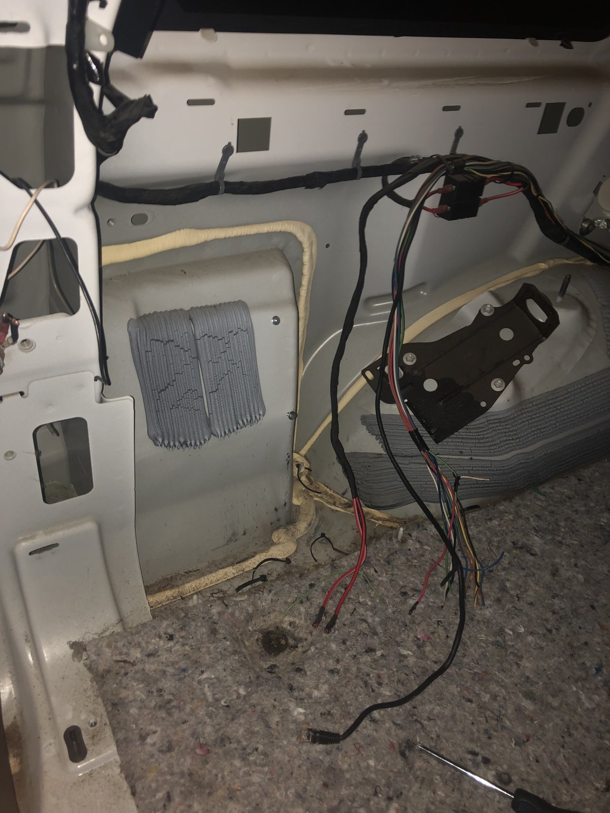

Second Picture- What are these wires in the rear of the tahoe/ where can I learn more about them? I removed the rear panels for cleaning and wanted to know what they were while I can still look at them.

Welcome to the forum, and congratulations on the new ride. You’ll be going through the first somewhat annoying phase of owning a retired police vehicle which is undoing all the mess left behind in the wiring. As you’ve seen they leave a lot of aftermarket stuff just cut off and abandoned.
Some people find uses for parts of that to support power for radios or refrigerators etc. In my case I removed nearly all of it. You can easily tell with a visual inspection what was put in place at the factory and what came later. Unfortunately there’s a myriad of different equipment that may have been installed and each installer does his own methods so there is no universal roadmap to figuring out the modded wiring.
Access to OEM wiring diagrams can be useful to repair things like headlights if they don’t work any more since the removal of the specialty parts. You can get those online with an inexpensive subscription to a tech service such as Mitchell.
Have fun with the project!

As @Bill 1960 mentioned, find the Chevrolet Upfitter Guide. It’s available on the GM website if you know to search for it by that name. The wiring diagram for the console area and left rear are super helpful.

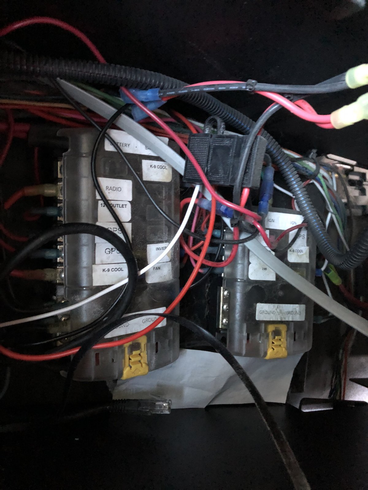

Labeled what I can remember from mine, The upfitting harness I labeled don't know what kit they used or cobbled together. 2nd photo is what I pulled from a friends PPV 2 monitor cables, 3 radio data lines, and ton of wires.
I would trace each wire and see where they go, Also Take a ton of photos of all angles of the fuse box note color wire to location. Also invest in a good Volt meter and see what can be removed (I.E live wire hits ground and now the car will not start due to upfitter tapped a module/Data line and killed a important Module/BCM/ECU/ETC). WORD of warning when messing with any of those fuse boxes/Wiring is to start the Tahoe each time you cut/remove wires, I have been surprised removing one lonely wire and now it will not start again.
On my Tahoe they tapped the Reverse lights wiring and shorted my main fuse box under the hood. Due to the reverse light relay is build into the circuit board the whole thing had to be replaced and programmed. Any question PM or post.

As far as all the extra wiring, an uncle of mine came by and tracked the power wires and where they'd hook up to, and essentially ripped all the extra stuff out. All the wiring gone in ~3 hours. Good with me!
