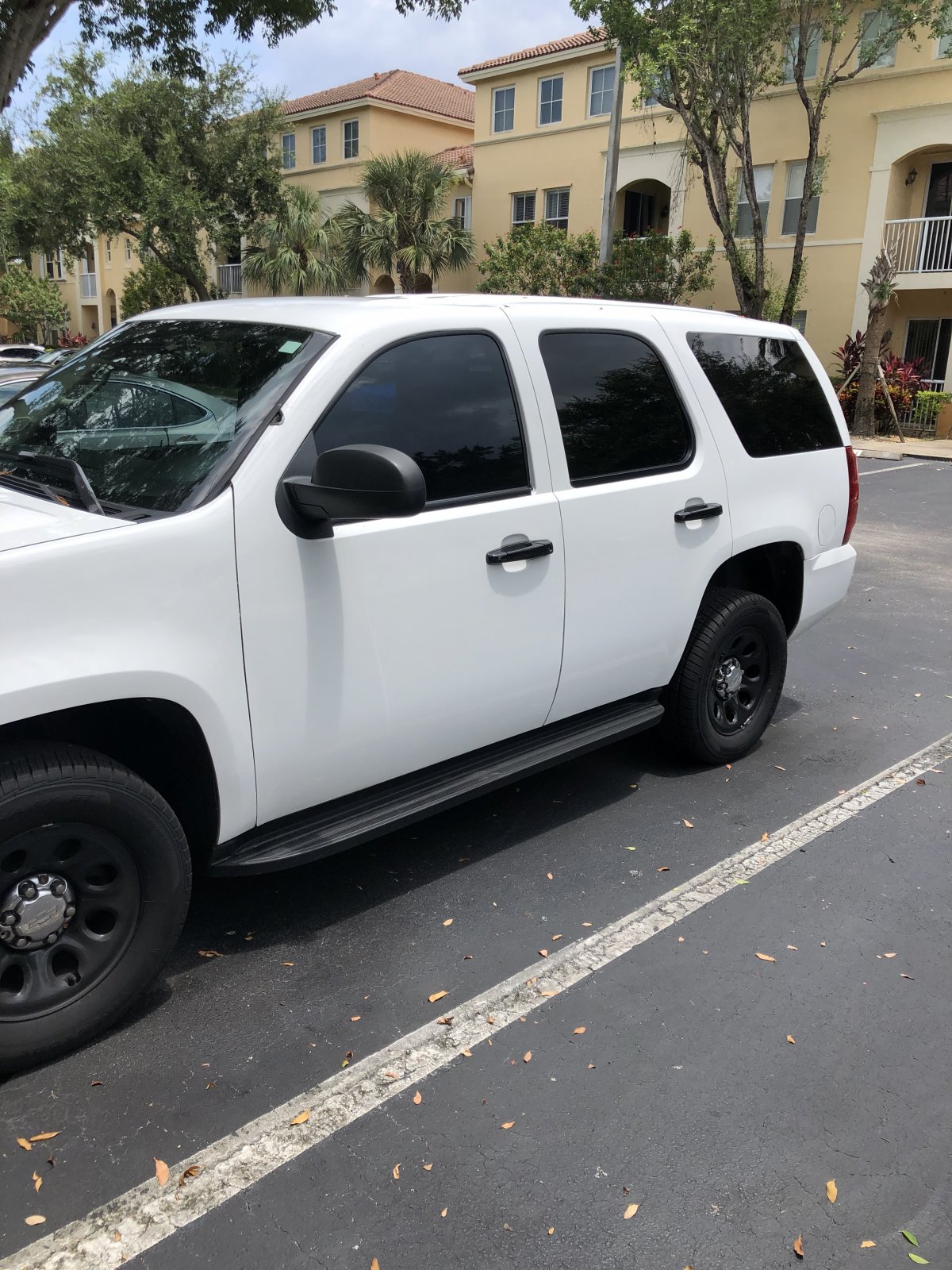

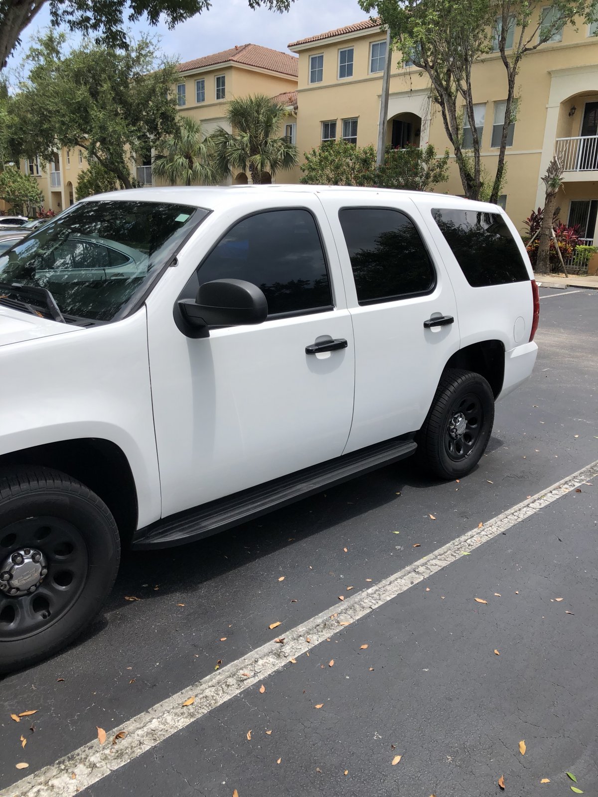

First a picture bc everyone likes pictures!
Rear height is higher due to heavy duty shocks for the tow package, which will be switched out soon, maybe Monroe maybe Bilstein, any suggestions help.
As I’m new here and just got the truck yesterday, I’m still figuring out the differences between civi and PPV.
Do all PPVs have the lights disconnected for when you unlock/lock the truck with the key fob? I am not the best with wiring so this one may be hard for me.
Do all PPVs have rear speakers disconnected? This may just be removing panels and reconnecting… not sure yet
Do all PPVs have non working rear door handles from the inside?? This seems as if the handle cable has just been disconnected from the latch. Gotta check it out.
also where do y’all find the dark grey pewter A pillars with handles! And center consoles!! Hahaaa been looking all over!
I’ll update when I figure these things out. Hopefully with some help from here.Can’t wait to be a part of this community!

You’ll get more feedback if you ask a moderator to move this out of the model year 2021 section and over to 7-14.
My education so far has been that different agencies and shops have their own methods of modifying the locks, lights etc. There’s not one universal way. You’ll need to open up those rear doors and see what is missing, or what may have been added.
On mine, they removed the lock actuator linkage and replaced it with a choke cable through the front of the door. Cut the cables for the inside door handles. You can get that cable from Dorman if needed. GM doesn’t sell it, just the whole door handle assembly.

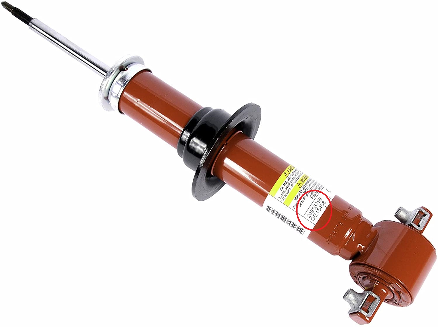

check your stock part numbers some have ZL1 suspension or police suspension see photo with red stock with circle. RPO code should tell you in your glove box.

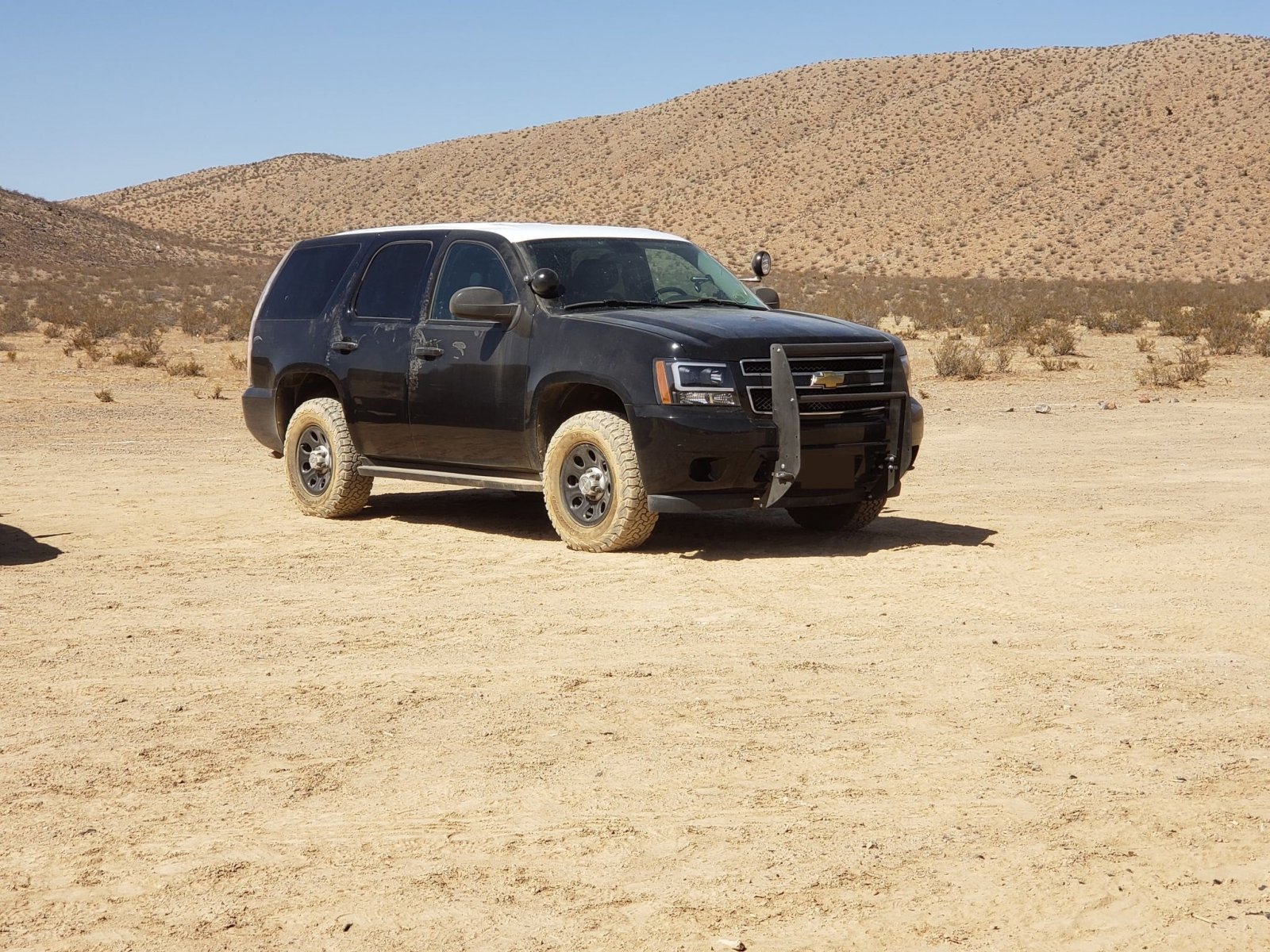

Before and after photos on the bottom. one of these day need to make a build thread.

So my rpo code does say z56 but I was told from who I bought it, that it was used for towing so it had heavy duty shocks/springs installed alongside with a tow hitch. It does sit high in the rear. I would like to at least get the rear to PPV height but not with the PPV parts as everyone says they ride rough. I’ll measure out each height above the wheel today.

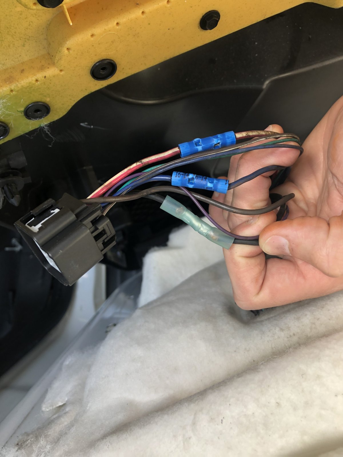

I did get around to pulling the rear door panels off and there was no cable or assembly at all. Also the speakers wires were plugged in already but still don’t work. (Yes I checked the fader lol) the back cargo pillar tweeters do work thou… The window switches were spliced for some reason. Pic below.

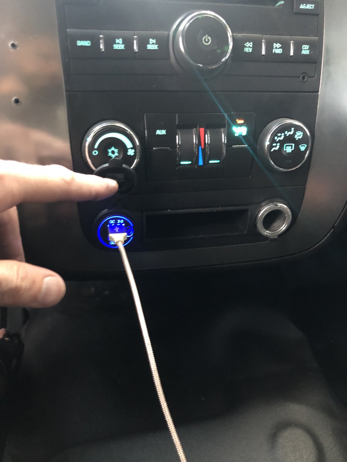

the only thing that has shorted out so far was the right 12v socket on the dash I replaced the left with a quick charge USB port socket. Next day I used the right 12v for a vacuum and it shorted out!

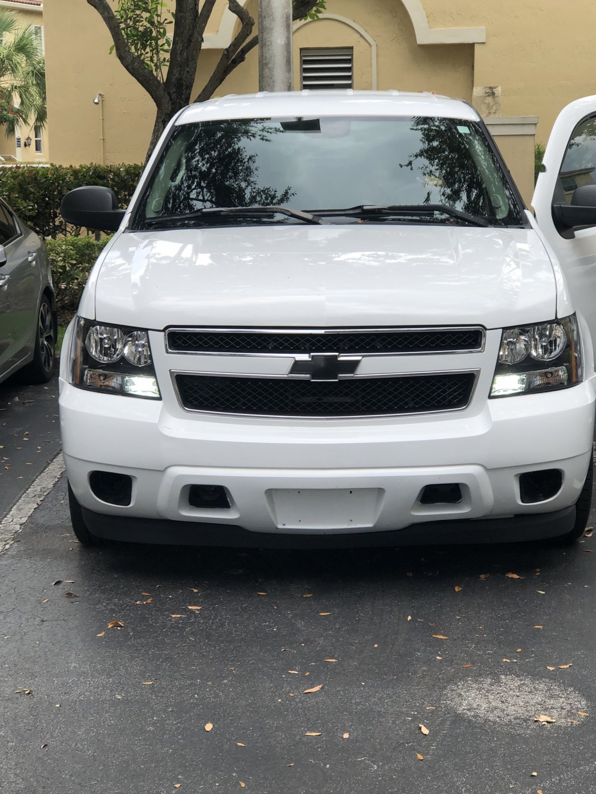

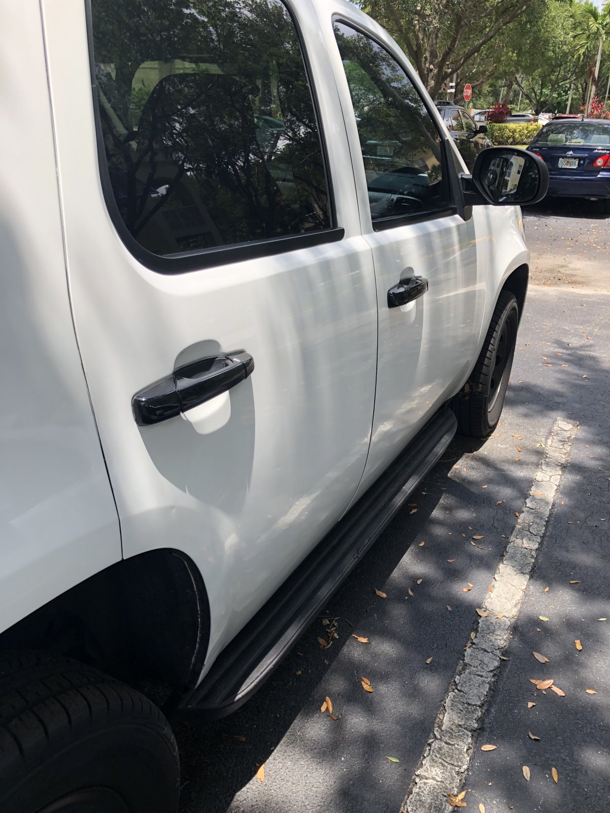

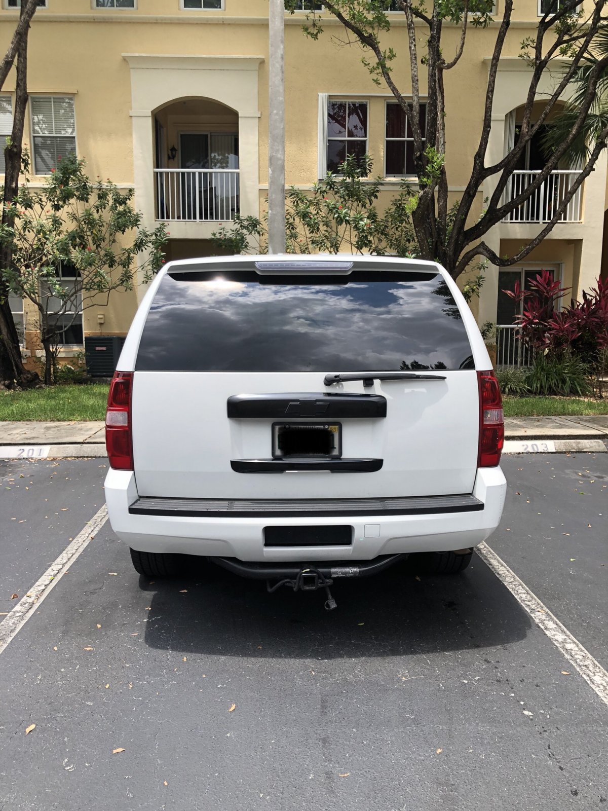

Today I added LED DRLs
Added some door handle covers, look better (good from far but tacky upclose IMO) but I’ll eventually get new handles and paint em gloss black. Drivers side and passenger are loose so they gotta be switched out anyways.
Before
After
I also painted the applique black the other day and added a powder coated black emblem, TAILLIGHTS ARE NEXT!

Nice job on the LED DRL and in the rear on the emblem plus the applique black. The third brake light looks like it was changed out by you also. Then maybe not. Door handles look good to me. I have a feeling you are going to tint the front 2 windows in the near future.
If you happen to need a honest independent mechanic for anything let me know. I have one in North Broward near Dixie and 10th Street. Exit 41 off I-95.
Before
View attachment 345797After

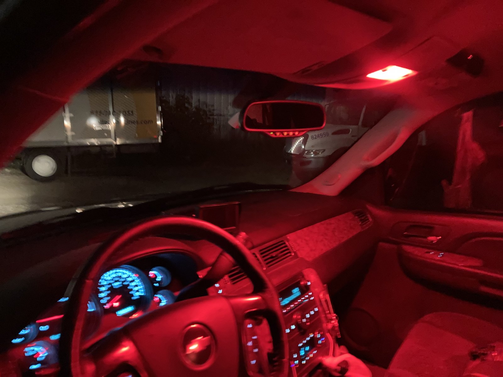

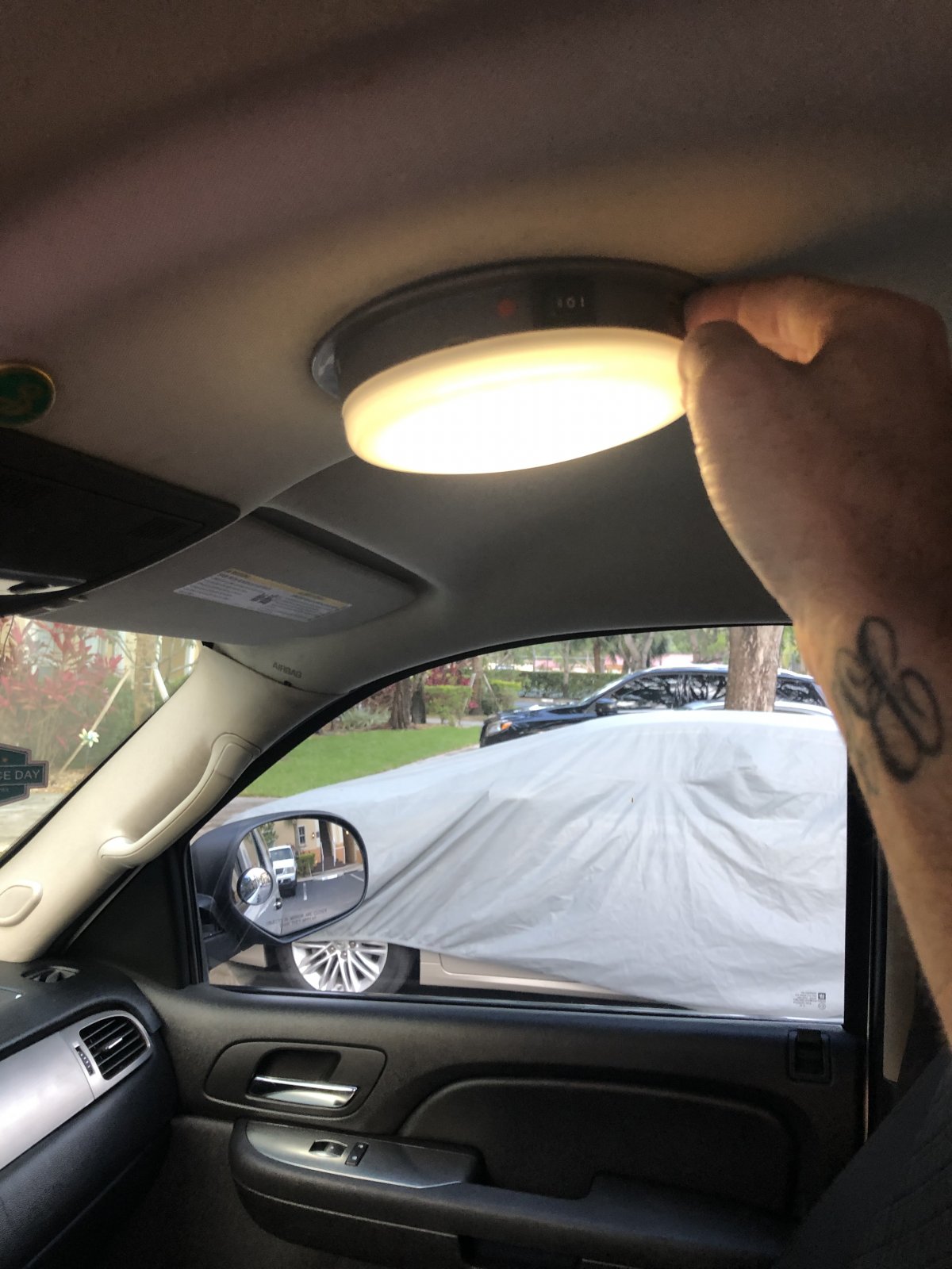

LEDs all around now, even interior!
Yeah the 3rd brake light I changed, LED black housing clear lens, a week or so ago, not sure if I like it yet…
front tint, Yeah definitely soon!
It’s got 177k, it’s from Lee County so I’m hoping it’s mostly highway miles.
