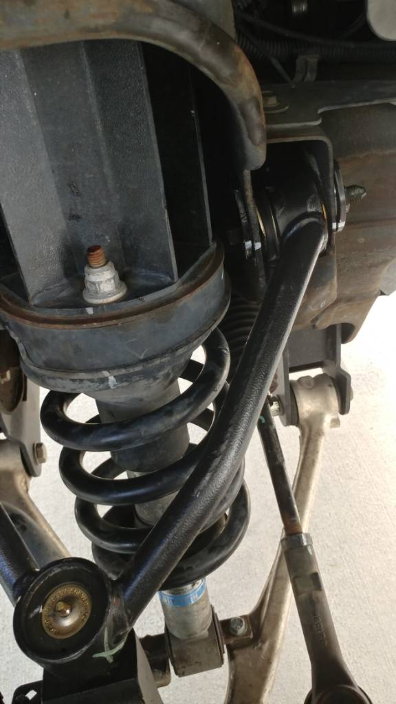

Ever since I installed the RC 7.5" Lift; the alignment has never been right when it came to the camber. I have the RC upper control arms installed. Everyone knows the ball joints are replaceble but I couldn't find anyone that has replaced the bushings. Out of pure gambling spirit I bought the belltech 4957 alignment kit with the offset bushings and they fit perfectly. Needless to say after all this time I finally have perfect alignment without having to buy a pair of new UCAs. This is for anyone trying to figure out if the bushings are replaceable for RC UCAs.

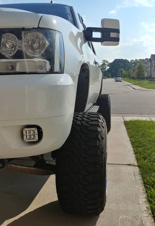

That stance is wild! What’s your set up? Lift is an RC 7.5” but what’s your tire and rim combo?! Also what mirrors are those? Love the flags!

It's actually the RC 7.5" plus a 3 inch body lift. Wheels are 22x14s with 2" spacers in the rear(to match front track width), tires are the typical 35x12.50r22.The mirrors are just the typical newer style tow mirrors that fit the 07-14s. I colormatched the caps on them and made the American flag that's on them.
