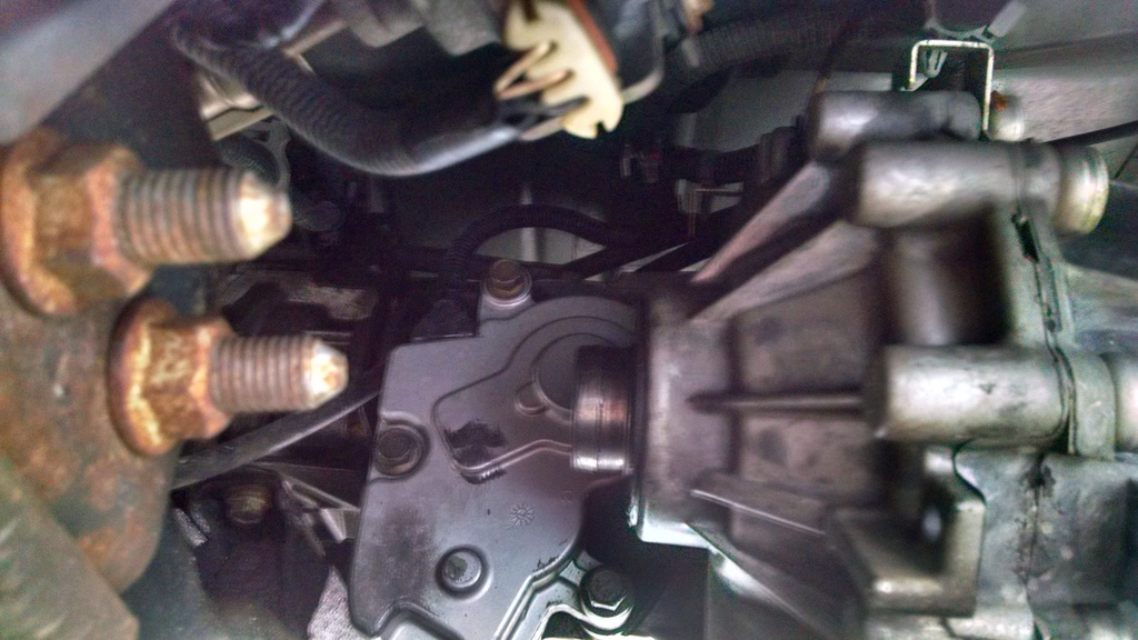

Looking back at the transfer case from the front
transfer case

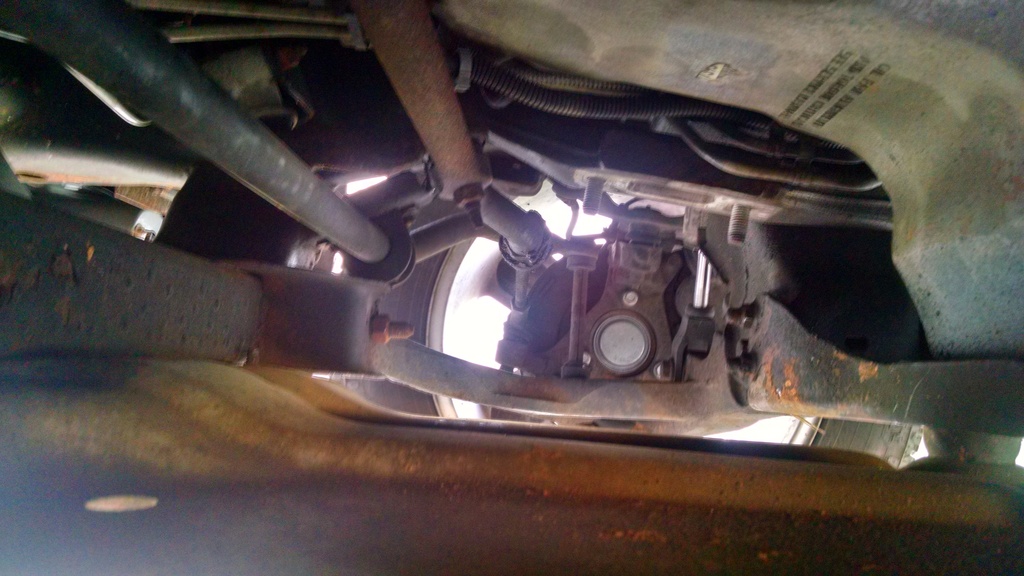

Looking forward where the front diff should be

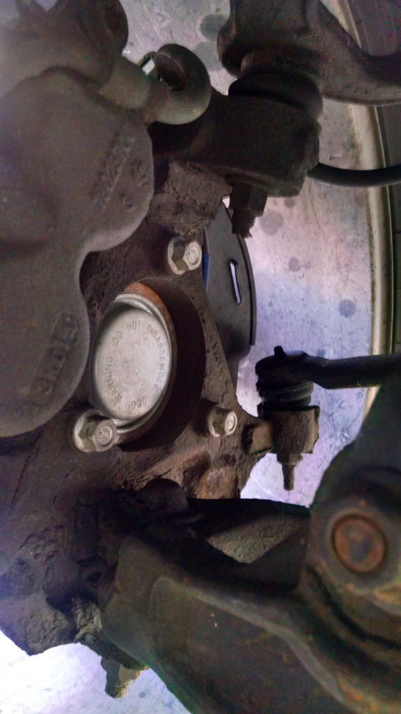

back of the driver's side spindle

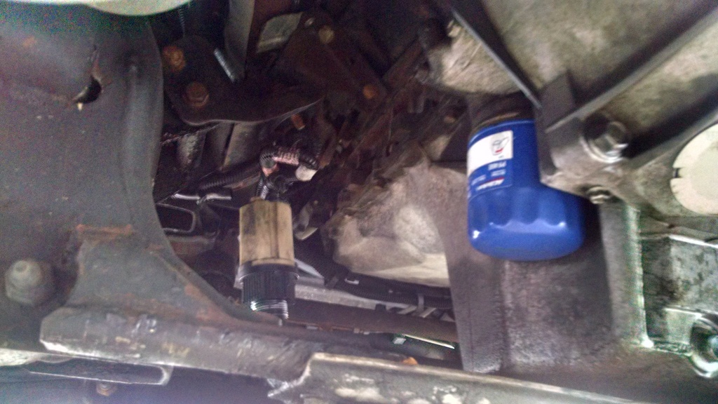

across to the passenger's side spindle

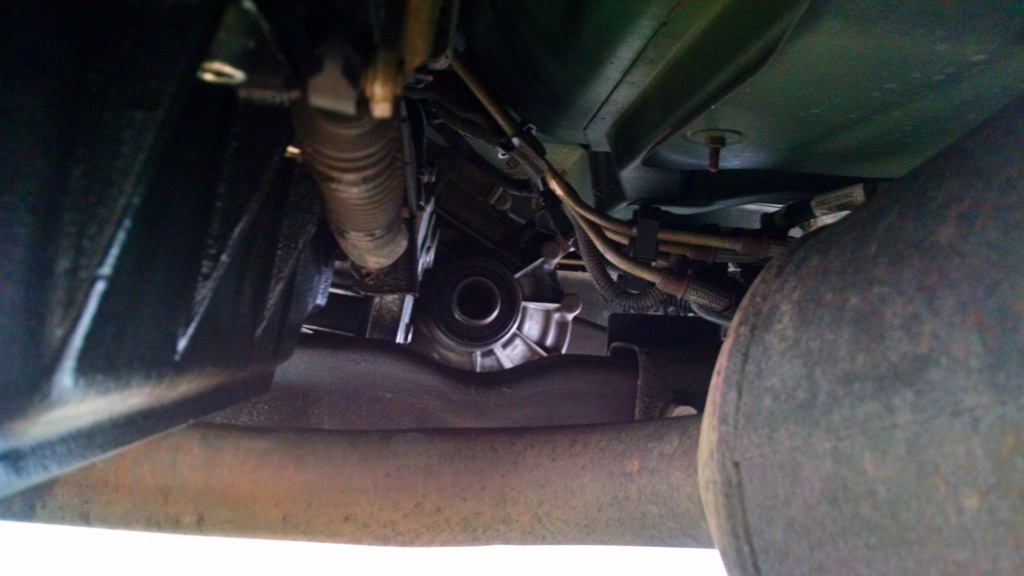

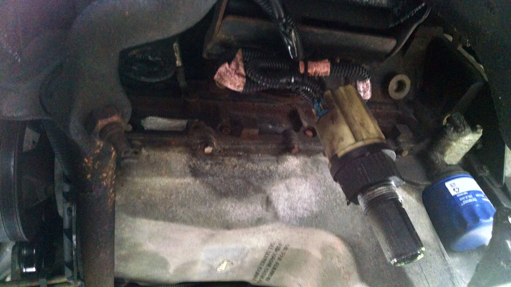

and the electronic something or other... Can't think of the name at the moment.

Any idea why the last owner took it all out ? I know you have a lot missing but don't rule out a transfer case problem when it's all back together. By the sounds of your list you should be ok. Best thing is to go to a wreckers and dismantle your self. That way you get what you need and know how to put it back together. Gear ratio should be in your vin and in the glove box codes
