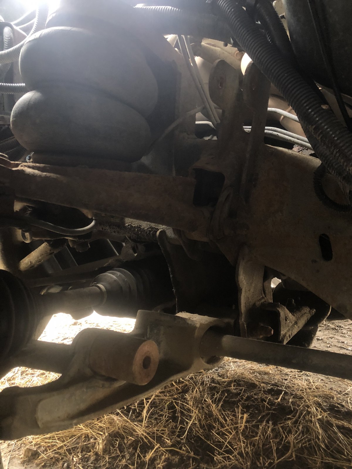

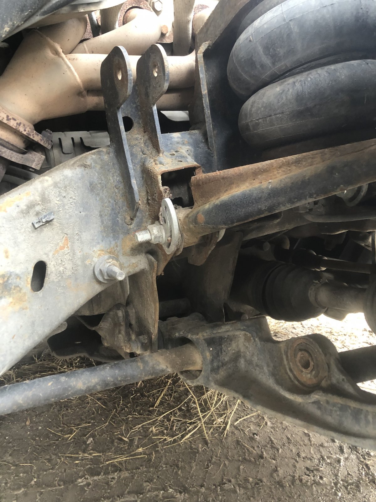

I just picked up this 2001 Yukon xl as a project
It’s got some issues
No front shocks
Rear shocks need replacement
Airbags leaking
For now to get it driving I’m wondering if anyone has any recommendations on what shocks to install
Pretty sure it has an airbag-it kit (chassis tech)
If anyone know what shocks I should throw on with which relocate kit
Or if anyone recgnizes this kit.
It would be a great help.

Cool ride. Never really played with bags myself. The bag is where the factory shock mounts at top. Left front has extension on lower shock mount to put shock outside the control arm. Thats a lot of leverage on the shock. Right side doesn't. Hmm. Will have to measure and fit custom length in there. Was the rear airride? If its bags as well you don't really need air shocks just a good replacement.
21,296
30,244
No idea on the kit but those bags are used in heavy heavy equipment. Take one off and bring it to a truck parts shop and have them look in their catalogs, Goodyear, Meritor, etc.
