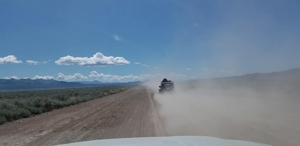

Yea, I am wondering if there is a easy solution.. I am hoping getting some of the dust out with a pre-filter will help.
This is what I drive through sometime for hundreds of miles on a weekend..
