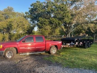

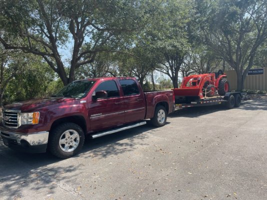

No, I meant a 10K pound trailer. My daughters pull dump trailers loaded with trees and whatnot with their 1500 Sierras with ease. We're in Florida where our hills are overpasses. They are the same as @buckwild27 but with 6.2 engines.
