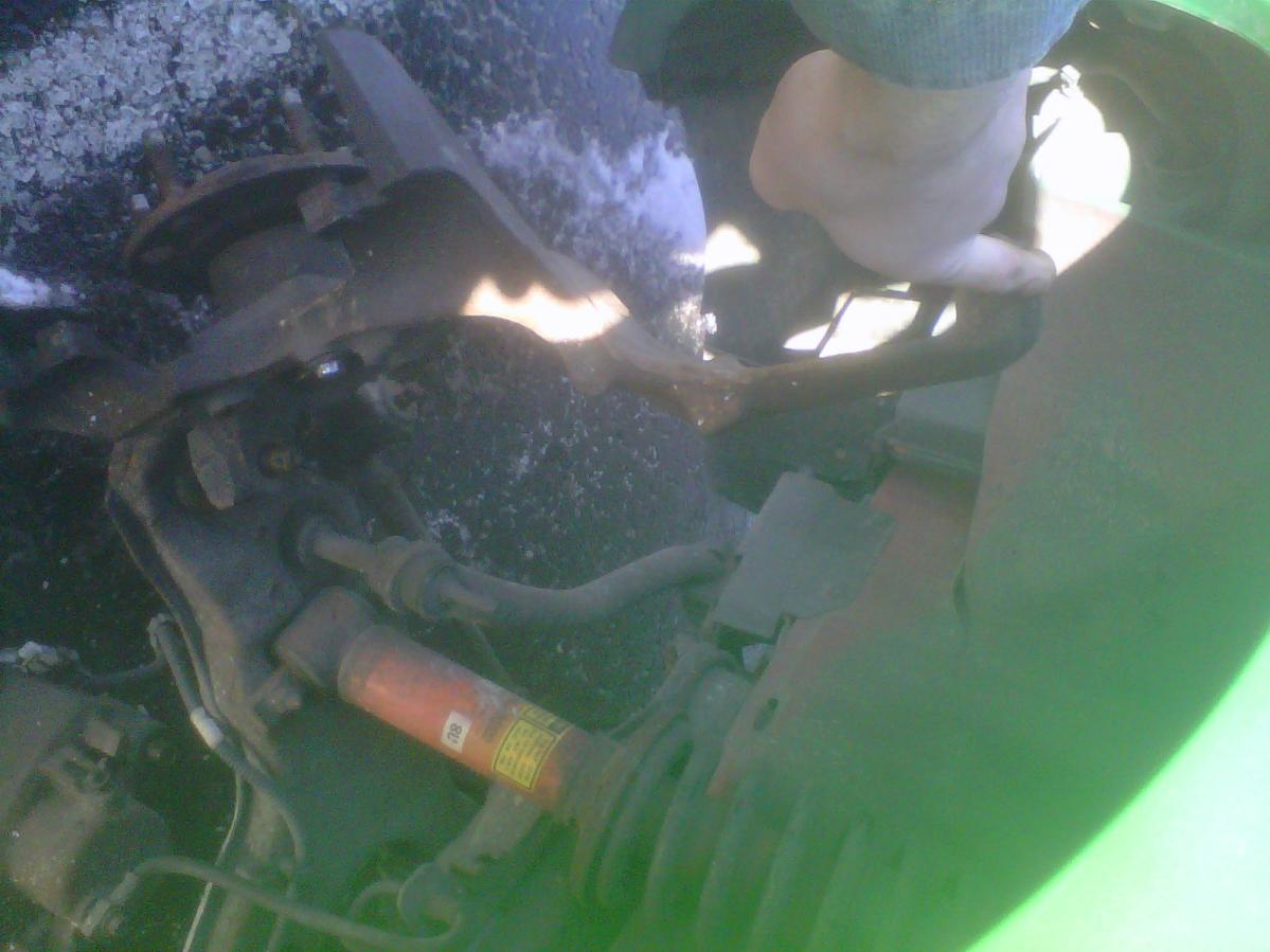

ight so i have ben beatin the shit out of this bolt and still ain got no where . . . still
need to get a file but im starting to doubt that idea now . . . correct if wrong but i got
the top of the a arm off i just can't get the tie rod off and the bottom part of the a
arm off it just won't slide off the studs . . . im scared to keep beating on that part
becouse i don't wanna tear somthing up

Well to take that Tie Rod off, take a hammer and hit the top of it down. It will just pop out of place. HOWEVER
Looks like you have a ton of room in there. Way more than what I was thinking. You sure you can't pound a socket onto that bolt and then remove it with a ratchet? Ask to borrow some tools if needed? If needed, try heating up that bolt. Heat usually breaks bolts away
Vise-Grips will work to. The biggest ones you can get. Make sure it's nice and tight on the bolt, and put all your effort into it.

well i beat the tie rod still no give i need a bearing splitter but iv ben smacken the
extractor sockets on that bolt and just when you think its gonna give it just spins off
so i don't know but i also beat the crap out of that bearing and i popd off something
like a splicer gear that was just behing the bearing but any ways i started hiting that
bearing reall hard thinking i could just smack it out of there but it didn't work . . . but
hears the complete messed up part . . . they tryed to tow the car since it was sitting
on jak so guy told me to hurry up and put it together and just move it for the day well
i did and wen i did nothing happend as if there was no problem with the dam thing in
the first place . . . i'v ben driving it and there isn't no thumping or rocking so ima take
it to the shop sometime and throw the torch on it and go head replace the part im just
mad i spent all that time and then theres nothing wrong mabe the bearing was just out
of place and i put back in when i started beating on it

Did you shake the front tire down and feel any movement? If you grab the tire at the top and bottom and shake it, you'll feel some play. Have someone watch and see if you see any movement on the upper ball joint, lower ball joint or wheel bearing.
preshus
preshus
Dec 1, 2011
151
washington,IN
ya theres no play at all except when the wheel is of the disk has play but
i was told thats the way its suppose to be . . . still don't have any problems
so far so im just holden my breath for now . . . i got the computer hooked up
to it becouse abs inop came on i had them clear all the codes becouse it
was my fault that light came on i took the little gear off that the sensor runs
off of lol so other then that its fine . . . its got some tranny slip but i don't
think that could of caused the shakeing . . . i guess i just need take it to
dealer when i can afford it lol
