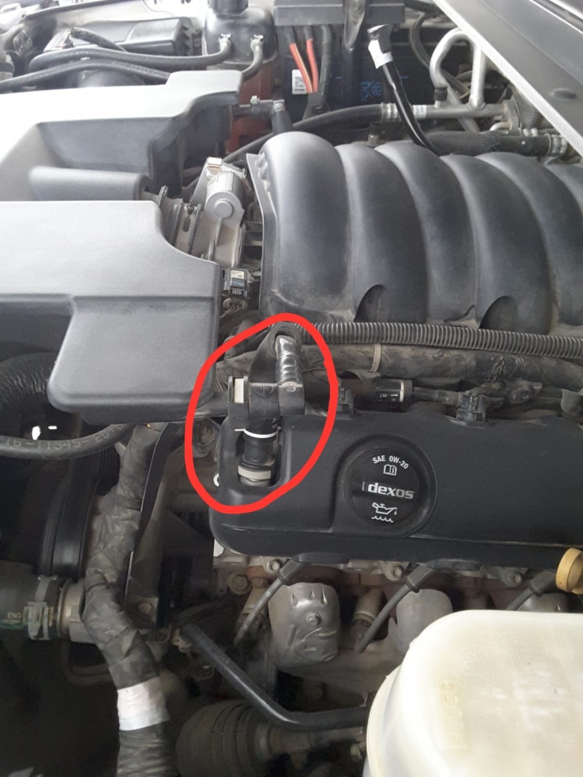

Hi,
There is fuel smell comes from this part, see photo, what is the problem? I need help, please.
tom3
Jul 15, 2019
1,411
2,467
Check your oil, see if the oil on the stick smells like gas.
30,552
48,014
Hi,
that is part of the PCV (positive crankcase ventilation) it could smell like oil at best (normally)
if you suspect fuel in the oil then you can take a oil sample and send it to blackstone labs and they can give you a report on what they find in the oil (including fuel and many other things) they charge $35 for a oil test.
