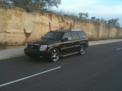

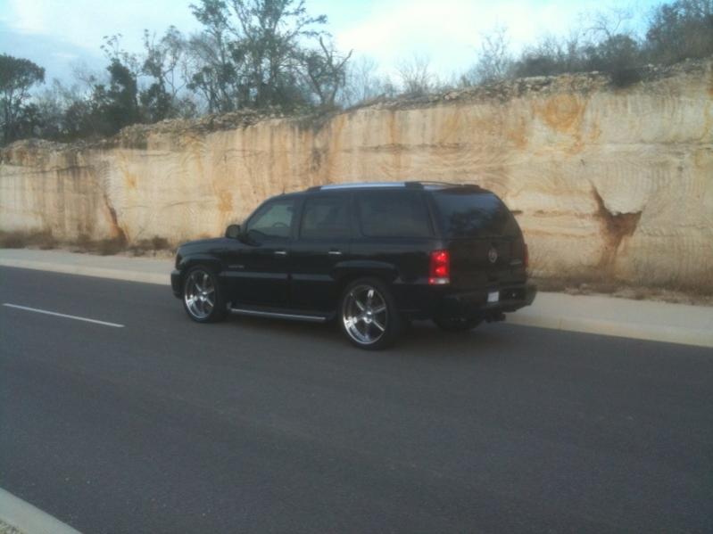

Hello everyone I am new to the forum and SUV world....I have an 03' Turbo Escalade built by Livernois Motorsports. They done a 3-4 Ground Force drop on it with the air ride back in 05. I got the esc in December and the truck has a very bad sway wollow or whatever you want to call it when you hit dips or bridges. I know it is not going to ride stock but it shouldn't handle like this either. I ditched the Air ride set up and went with HD KYB shocks in the front and it cleaned up some. Then I decided to replace the rear and now I have the problem with the bottom out issue also. The shop that installed them are going to try the lowering shocks because they don't think it has enough travel. I was tempted to buy another complete kit and re-do everything with coils and all. Should I atleast raise it back up to a 2-3 drop instead of the 3-4? If anyone knows any tricks please hit me up. This is a vehicle I bought for a daily driver because I just had a kid. My new Z06 is not baby friendly plus I was racking up miles. This is my first SUV of any kind so I am having to start learning from scratch. Just don't know to many go to places here in S.A. moved here from Dallas...I love my new toy but there is know use having 500+ horse power if I can't enjoy it I am fustrated as hell :emotions122:

Thanks for the quick info and compliments! The pics under my post is how it sits right now. I will have to climb under later and get pics of the suspension. But I do know it is supposed to be a 3-4 drop kit from Groud Force with coil springs, sway bar spacers, and keys. I added the magazine article link it was featured in that has a full write up on the truck.
