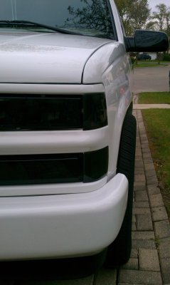

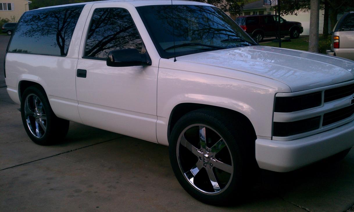

Hi guys, new to this forum, I just bought some wheels for my 1997 2 door Tahoe with out really knowing anything about offset. Now that they are on there, I'm not happy at all with them because the front wheels stick out about a half inch past the fender, can anyone please help with way offset i should go with because i want them to be flush and not sticking out? Thanks everyone.

tell you the truth i like it like that and im digging the storm trooper look
tire rack says Offsets of less than ET20 will stick out of wheel well.
992door
Apr 30, 2009
1,589
20
Greenville, NC
Positive offset when you want to tuck wheels and a negative offset will push out more
