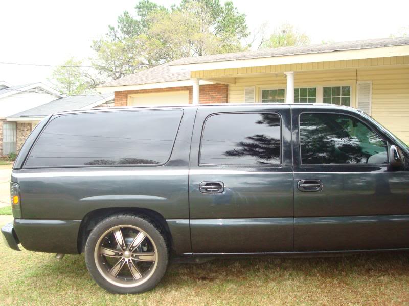

My wife has a 2004 GMC Yukon XL lowered 3-5 with 22x9.5 305/40/22s and SSBC 14" brakes all around. The problem is that is rides EXTREMELY rough. I did the free travel mod and it is still very stiff in the back. My question is it the coil or the shocks and if it is the shocks what are good ones to try? I have gone from stock, to Doetch Tech, to the DJMs that came with the kit. If it is the coil what is a good option to make it ride a little more like stock? Thanks

do u have a pic of the vehicle.. i would love to see how the 3/5 looks... sorry a lil off topic

Look on my Photobucket under the same user name. The pictures aren't that good but beats nothing.
