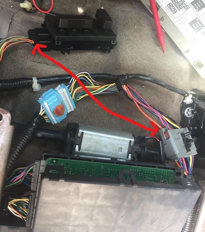

I've made some progress. The image attached shows that if I run a jumper between these to points the seat works. The main harness orange wire carries 12.4 volts, but the orange wire voltage is only 11.5 at the switch. Any insight on what the problem may be?

You are halfway there. Keep going in that direction, but quit jumpering power before you find problem. You already knew motor works. Test each pin in each switch position. Then test pins when memory reset. You are trying to decide if its the switch or BCM not allowing seat to move. Figure it out. I doubt both have failed.
