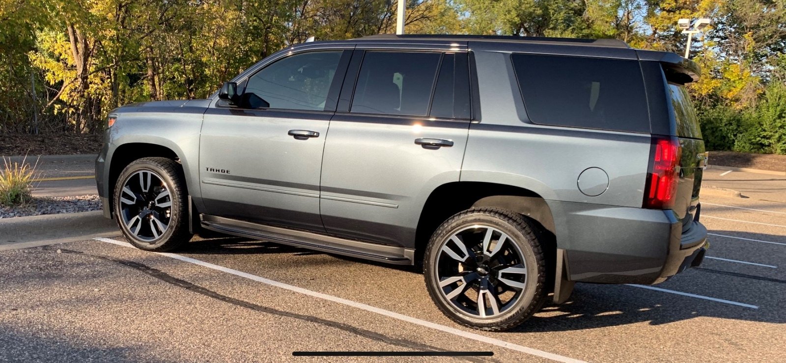

You could go to a 285/45/22 tire which is a little wider but shorter in overall height by about 0.8". The previous 2015-2020 Tahoes/Yukons with 22's came with 285/45/22's on them. I traded my 2019 Tahoe RST for the new Denali and you can tell a major difference in ride quality. Probably has a lot to do with the air suspension (the Tahoe did have air suspension in the rear but not all 4 corners like the Denali) and independent rear suspension but I imagine the taller side wall helps as well. I was debating going to the 285/45/22 size myself because there are a lot better tire selections in that size and nothing that great in the stock 275/50/22 size. I am hesitant because, like you, I do not want to sacrifice ride quality.
But, to make a long story even longer, you could go to a 285/45/22 if you are looking for close to stock sizing lol. Attached a picture of my previous Tahoe with the stock tires. Would like to see this size tire on the new body style trucks.
Should note your speedo is going to be off due to running the smaller tire height.

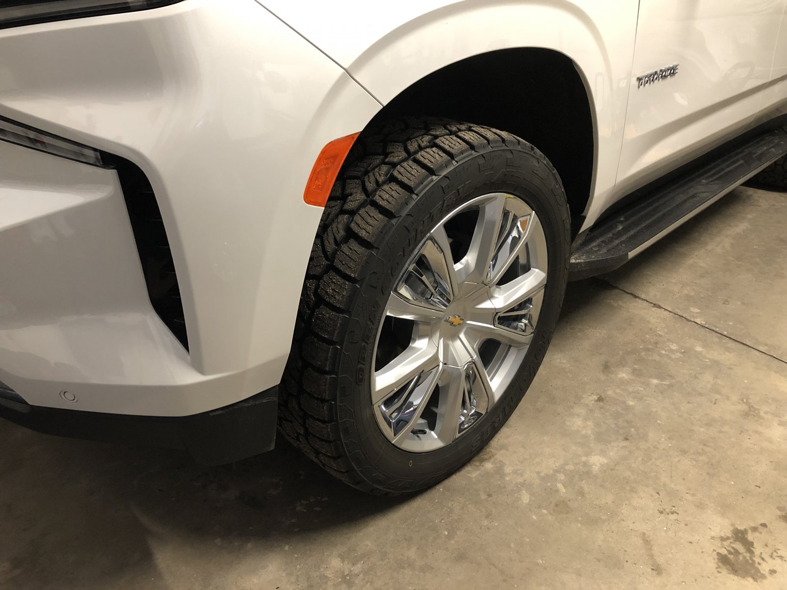

a 305/45-22 is the same tire height withing a tenth of an inch of stock, and many have already said no fitment or rubbing issues.
olyelr
Mar 19, 2011
1,889
968
Elk Rapids, MI
Yep i put 305/45/22’s on my wifes high country and they fit just fine. Ride like stock.
