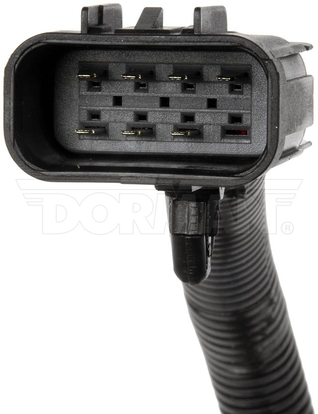

The (NVG246?) TC connector -- it's the one with 8 positions but 7 pins (wires)? I forget which end has the pins...
EDIT: this one (sorry about the big pic)?

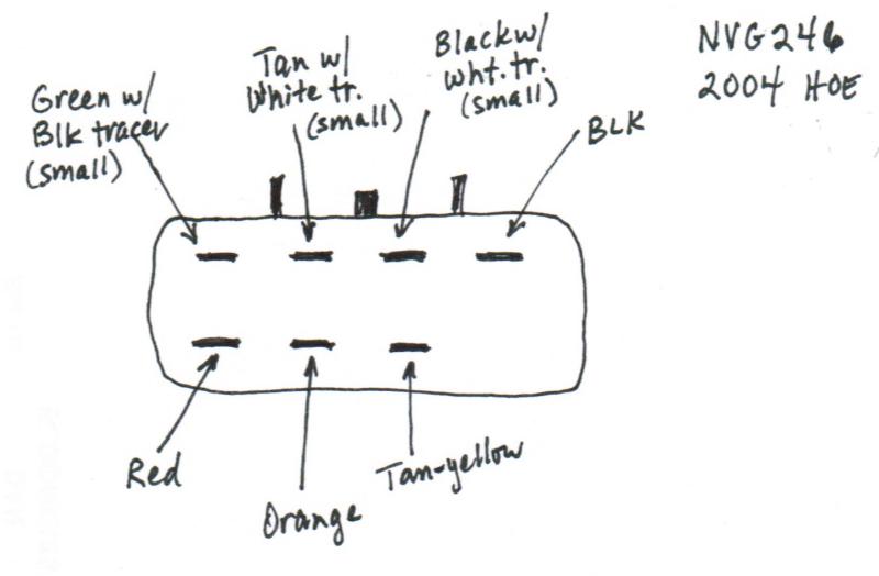

@******.sixty9, here's how my reman AC Delco encoder is wired. Not sure if the wire colors match up to your encoder motor, but it's worth a try. I couldn't decide on a color for the "tan-yellow" one, it seems to be a hybrid, more tan than yellow. The ones that don't say small on them are larger gauge wires.

@Fless Thank you for the info!
It was the 7 pin for the trailer/camper hookup that I needed the diagram for.
As for the encoder motor (thanks for reminding me of the name) I need the harness for the motor side. Reaching out to see if someone has a bad motor laying around that I could get the harness from. As for the truck side harness, it is full if mud and debris but it is intact. I need to get back under and confirm what case is there.

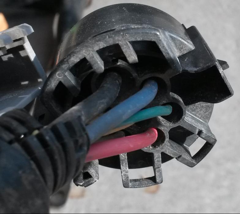

Thank you! Unfortunately this doesn't show me where pin 1 is.
Being in a circle they could all be off a pin by the same amount.

You can look at the part that protrudes out from the plug and go from there. Not sure what it’s called,the thing that makes sure the plug goes into the hole correctly. Locator lug? The thing that sticks out by the blue and green wires. If you can’t figure it out from those pics you shouldn’t be working on it IMO.
