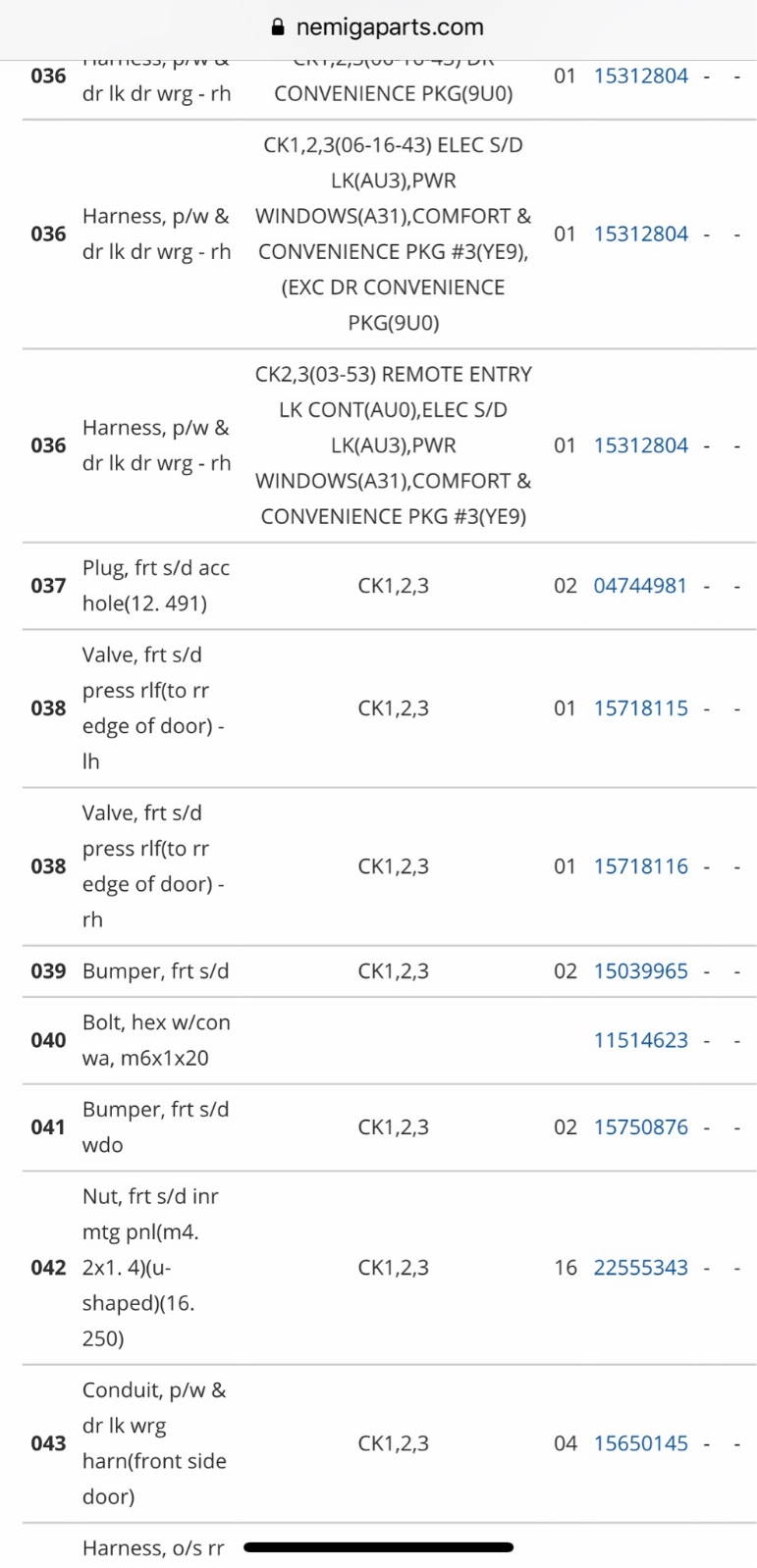

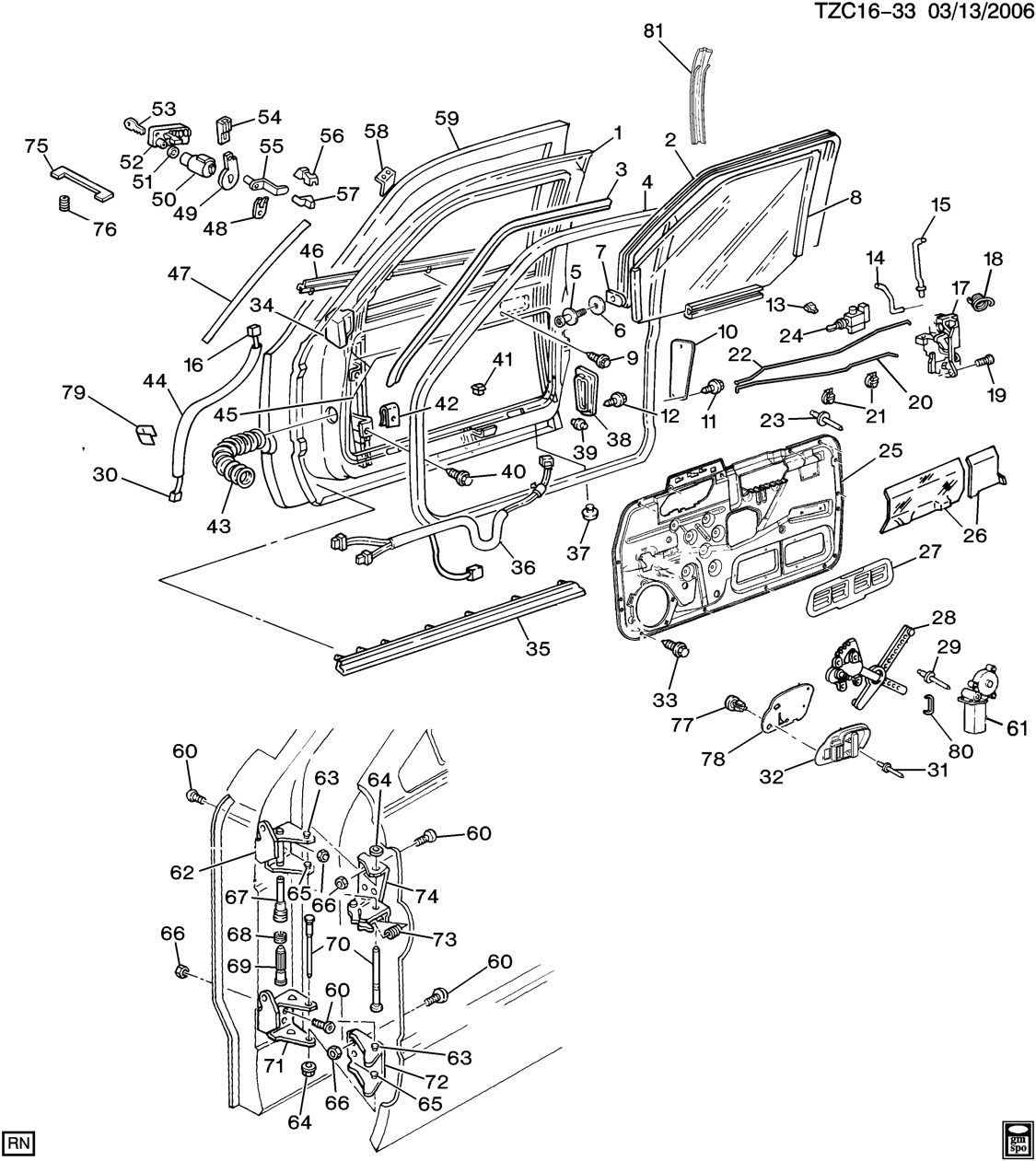

It looks like #38, GM part numbers 15718115 and 15718116.
I don’t think you can order from them, but they have the parts diagrams which are helpful.
https://nemigaparts.com/cat_spares/epc/chevrolet/54c-k/16/tzc16-33/
