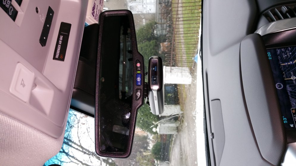

Just did it! Thanks for info ,very helpful. 2015 Tahoe LTZ

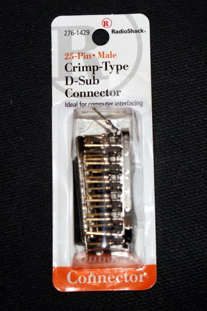

You can make your own power cord with smaller pins, what you need is in the picture below (from radio shack). Just solder them on to the red and green middle wires of a telephone cord, and they go in much easier than the invisicord.

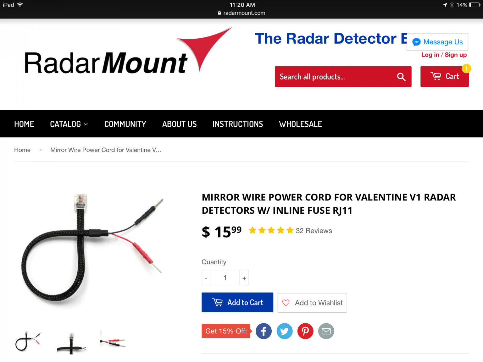

Another huge thank you to Hosseface and powderbrake for their detailed posts & photos. Made my V1 install a 10 minute task instead of an all afternoon adventure. I used the Mirror Wire Power Cord from Radar Mount (https://radarmount.com/products/3005201v), only $13.60 shipped to my door after 15% off discount code. Works great, looks great, and is the perfect length.
