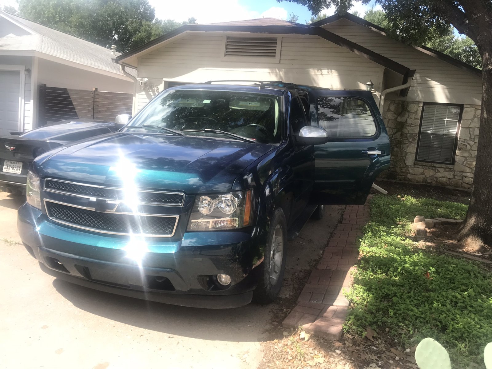

2007 new to me Tahoe
Kind of high mileage, has a few issues in the Liftgate area I'm trying to get resolved.
Trying to find a common denominator between these issues if anyone has any ideas:
-Power liftgate WILL open but WILL NOT close on its own (neither using button on liftgate, fob, or interior headliner switch)
-Rear lift glass actuator will not open glass (does not work on fob or button on rear applique)
-Back up camera not working (screen reporting check surroundings warning)
As this is a new to me Tahoe I am not really sure if this might all be related (ie wiring chaffing at liftgate hinge) or if its just coincidental that all this stuff isn't working because the modules, etc, are bad.
Any ideas or troubleshooting I could try?
