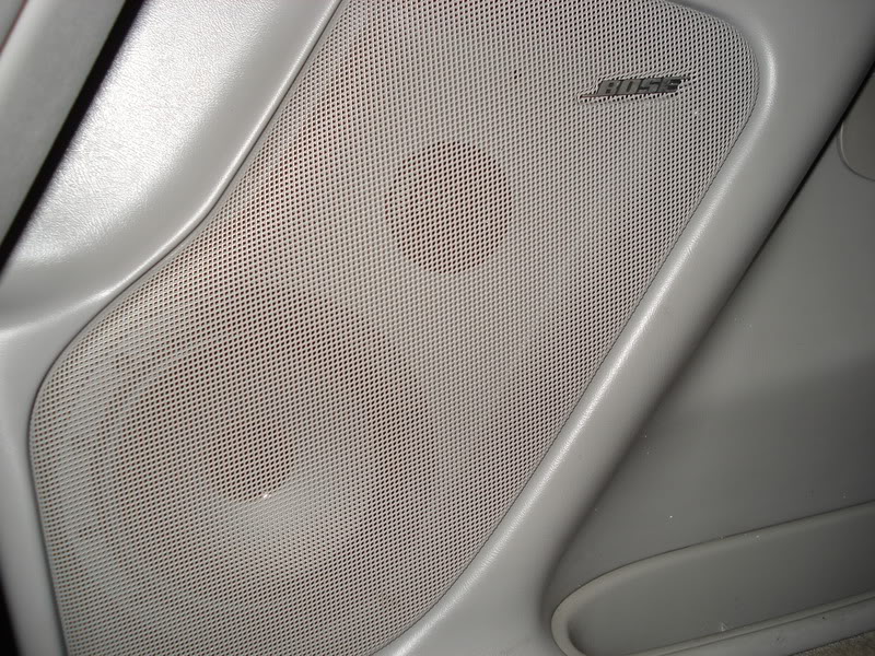

gtbigup01
Sep 12, 2009
326
Columbus, GA
I have the RS components in my truck, sound great and took about an hour to install. I stuck the crossovers behind the glovebox.
Is that your tweeter you installed right next the main speaker? Another question any mounting bracket is need to replace the speakers or will 6 1/2 mount where the Bose was?
Max
Mile High
May 3, 2009
3,570
33
Denver
Mounted right up where the stock speaker was, I think I used one of the supplied plastic brackets but it wasn't an issue. Yes the tweeter is next to the mid.
