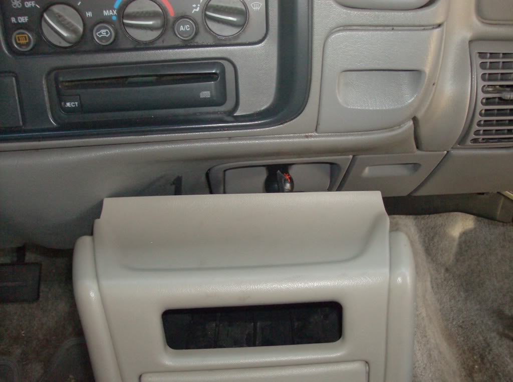

thats not mine. lol someone elses i stole picture from. Looks like an NBS silverado console, and the front piece was made of wood then fiberglassed then painted..
Just have to make templates outof cardboard first then transfer everything onto wood

Looks Good! it fits the dash better then i thought it would with that little bit of trimming, glassing it would be easy to fix the right side of it.
looks like i have something else to look for at the salvage yard!

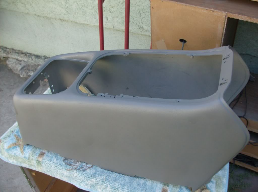

So here it is... It was shea in color no mounting bracket, no Electronic components.
After removing about 12 or so screws, its completely part.
I placed all the plastics in the tub and gave them a good scrub with some dawn dish soap. this is an important step before painting.
Here I simply hung these pieces up with sum fishin string.
I used 3 cans and put on 3 coats, this stuff worked great and its very inexpensive and its available at any auto store.
after the 3rd coat...

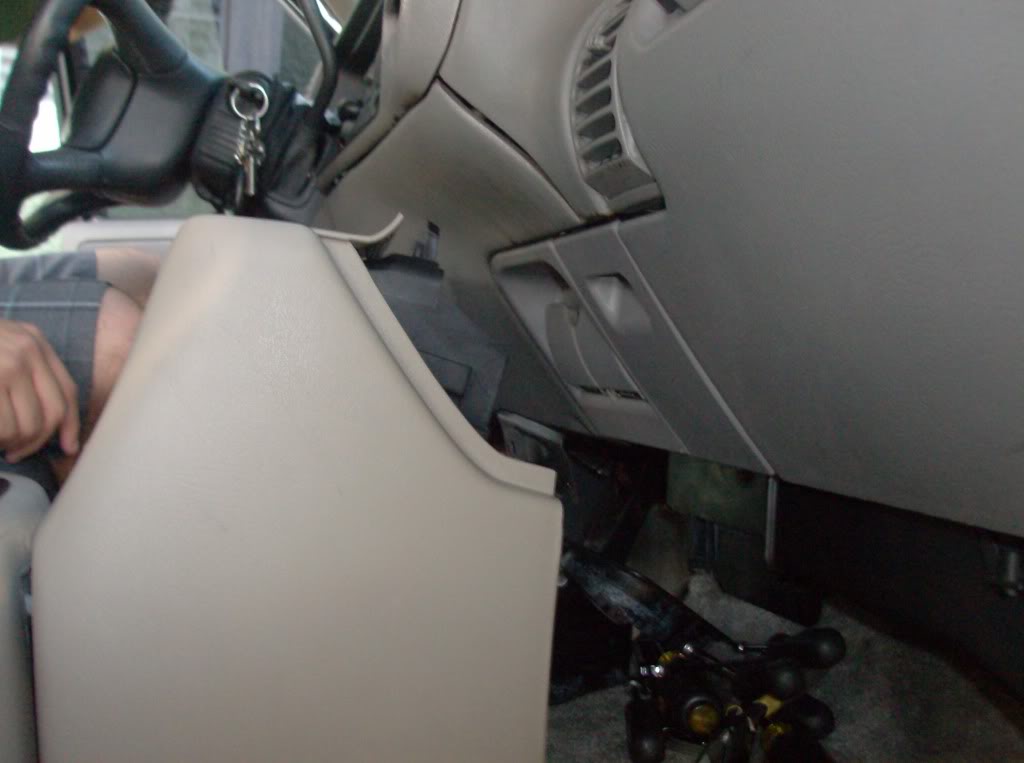

now here this bracket will not sit flush against the lower dash of the obs so some trimming is in order...
before trimming
After trimming... *note the 3rd pic* the console will not sit flush to the dash on the passengers side so some fiber glassing is going to b needed to make this look correct also you will have to rigg something so that the small compartment pockets are functional... To brace it down I used some simple L brackets and bolted it down to the floor and thats all... there was really nothing to complicated about this upgrade i seriously encourage every1 to give this a shot... If theres n e thing i can do 2 help please let me know and ill try to do my best... i hope this thread will atleast get u started of on the right foot...
