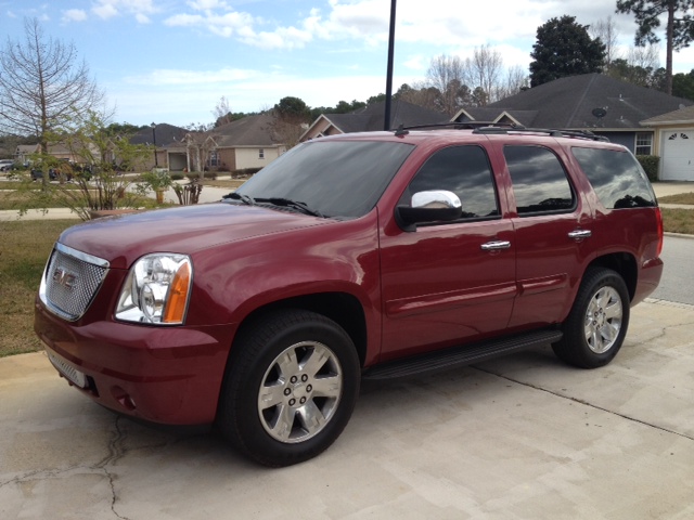

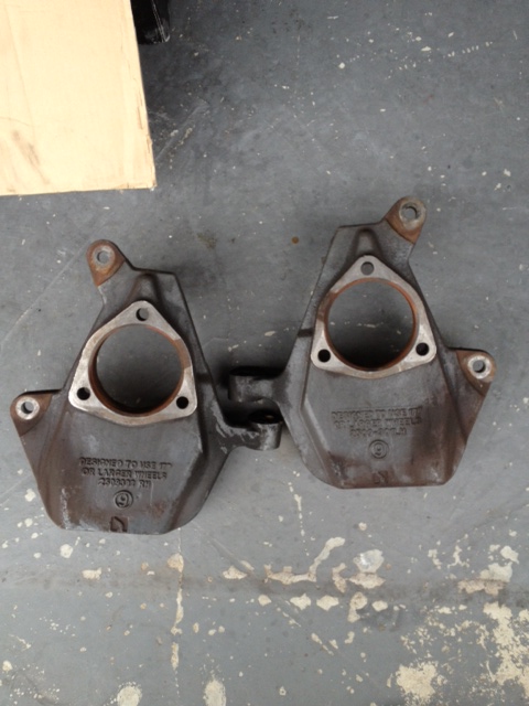

Got these today... gonna clean them up and paint the spindles. Hopefully install sometime this week...

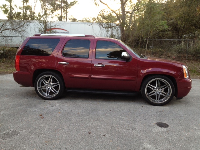

man it needs to be lowered... just haven't had time.

Will look great w/ the drop. I really didn't like those wheels off the car, but they look really good mounted. Nicely done.

Thanks. I saw the rims on a vehicle and that's what made me like them. Drop gets done tomorrow :)

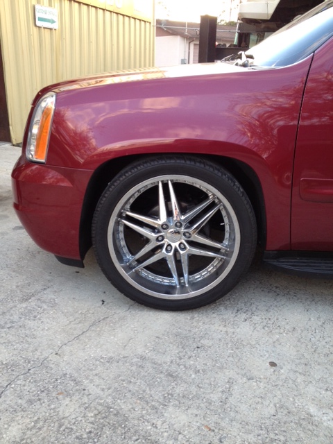

Did you get to the drop over the weekend?
:secret:

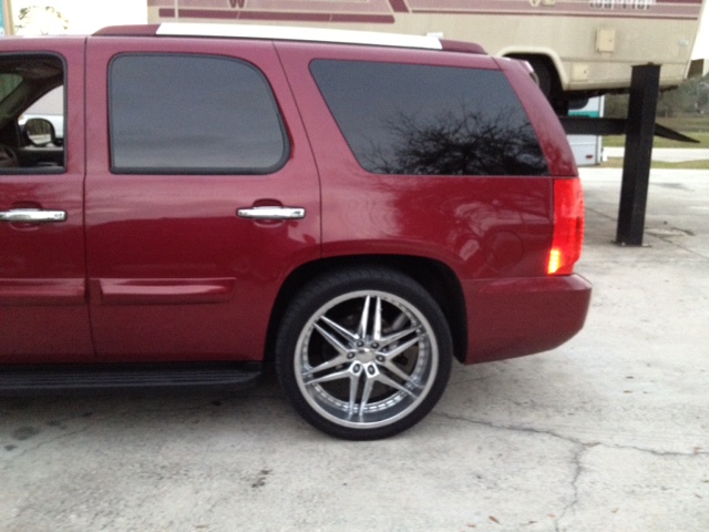

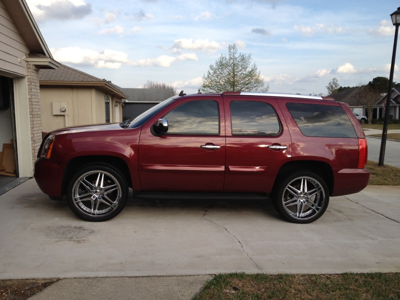

little teaser pic...
Need to see if or how much it settles. It looks ok now, but will look sweet another inch lower in the rear... I've been talking on the phone with Tony about it already...

you dont have the djm rear hardware kit in there huh. I can see how tires are sucked to the front of the truck.
rub it in Tony... rub it in...
Within the next week or so I'll be taking care of it.

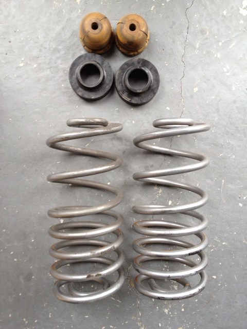

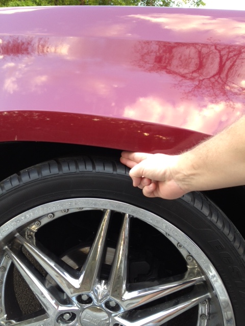

Front - 32.75 inches - Belltech 2" drop spindles & Belltech drop struts
Rear - 34.5 inches - Belltech 5323 Springs and Belltech shocks
Going to have to raise the front up a bit. I can't turn without major rubbing. I also want the rear to come down another inch. It's the difference in the 5305 (which I need) and the 5323 (which I have). I'll be ordering the rear kit and the 5305 springs in a week or so. Going raise the fron up a half inch or inch till I stop rubbing as bad. I'll also be heating the plastic, but heating it now won't help at all...

So I need 2 new tires anyways, so I'm going to do 295/35/24 for the front 2 tires instead of 305/35/24 and raise it just a hair, up to 33" and see what happens...

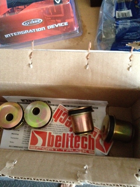

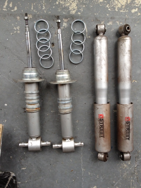

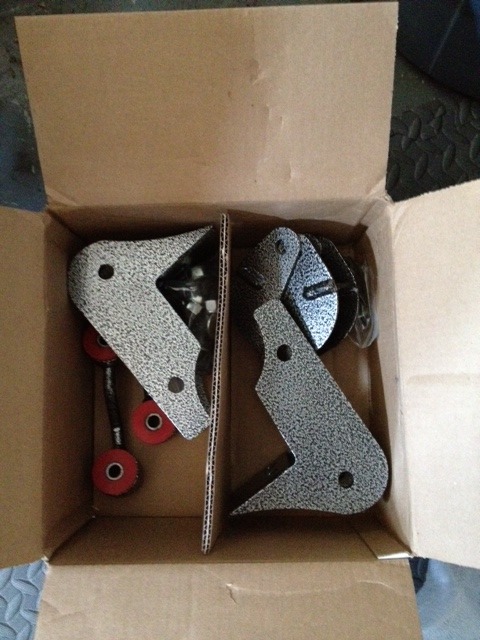

Haven't updated it in a little while. I got the 295/35/24 tires up front, still a little rubbing, but I'm waiting for my 5305 springs to arrive to finish up the suspension. Then I can cut/trim/heat the areas I need to.
Also bought:
DJM Rear Hardware kit (Trailing Arm Relocation Brackets,Shock Extenders, and Swaybar Shorter Endlinks)
Air Lift Rear Air Spring Helper Bag Kit #60769
Belltech Front Camber Kit
