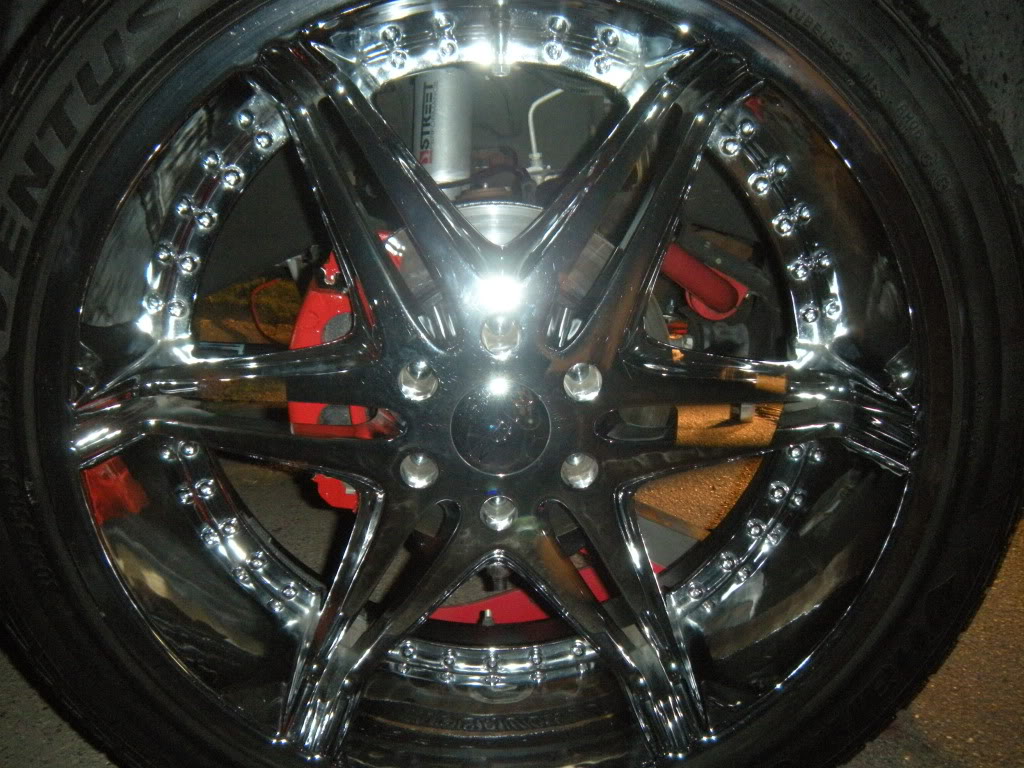

Finally had time to do my mods hope u guys like the pics

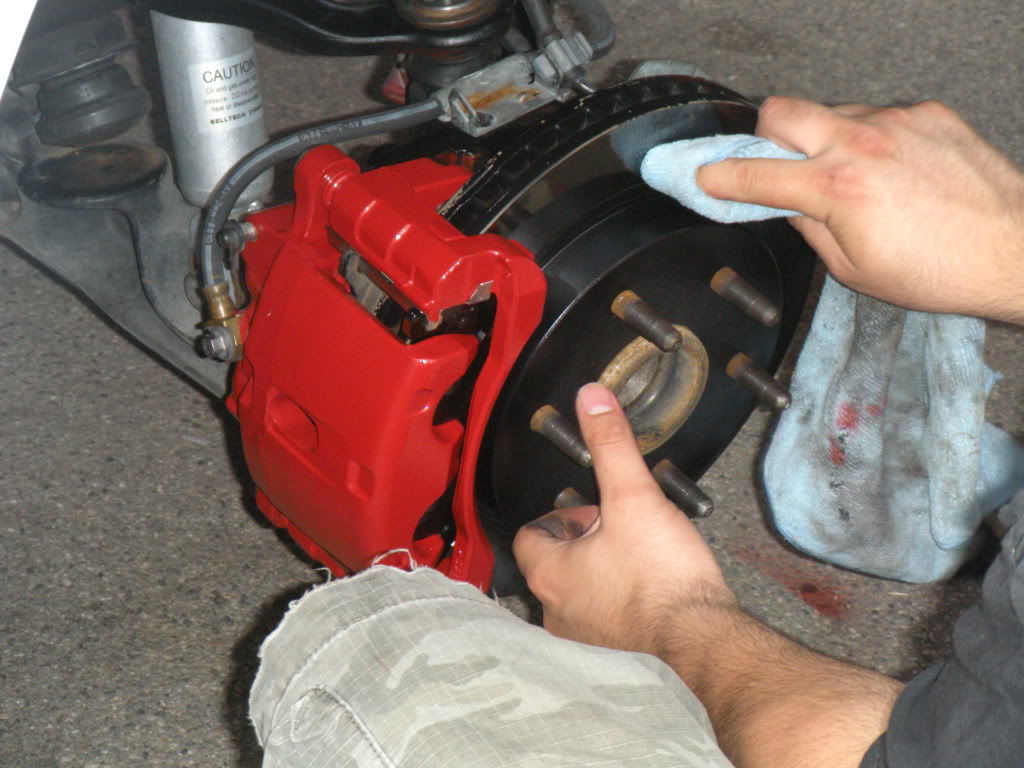

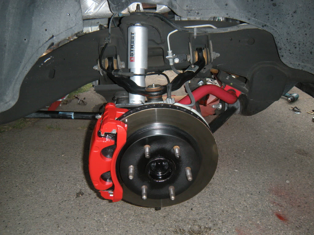

painted my calipers red Rotors black
Cleaning the rotors
Freshly painted
and what it looks like with wheels on

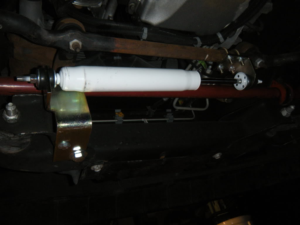

and finally got around and installed my steering stabilizers. This thing was definitely worth the upgrade, now i don't feel all the imperfections on the road, I'm quite impressed with the ride quality now..

x2 on the pic. Looks good man, also how did you do the steering stabilizer?
All that needs to be "modified" is to drill a couple holes in the frame where one of the brackets mount. The other end uses the u-bolt to attach to the centerlink.. Make sure the wheels are straight, mount the u-bolt/bracket to the centerlink but don't tighten the bolts all they way. Set it so that the shock shaft is about halfway out, then tighten the bolts. Turn the wheel all the way lock to lock while someone is checking to make sure the dampener shaft isn't pushing or pulling the cylinder when it's in full lock to lock positions
I just drove today to work and i notice a big difference im quite impressed on what this little damper shock could do...

Did you take them off and paint them or leave them on and brush the paint on? What product did you use?

Looks sweet! I'm about to paint my calipers white. X2 on the did you remove them to paint or just paint them on the truck?

Did you take them off and paint them or leave them on and brush the paint on? What product did you use? Looks nice. I love white with hints of red
I completely removed the OEM Black Paint, I used a wire brushed with a drill made sure their wasn't any black paint on the calipers, I used break cleaner one can on each side, lol sprayed on the red
duplicolor caliper paint this is the cans that i used .. about 3-4 coats on each side
Good work bro. They look really clean. Some people don't realize how much dirty/rusty calipers/rotors take away from the looks of big wheels.. Keep it up!!!
Yes sir Thanks bro
I completely removed the calipers from the rotors..

Looks great! I just bought the brush-on kit and plan on doing mine this weekend.
make sure you clean up the calipers real good with plenty of Break cleaner and degreaser, even sand them down a little bit so the color could grab and you wont have to do it again for a while

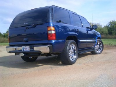

sorry about the wait guys i haven't had a chance to do the rear calipers but i did take a cell phone pic of the current stance and look for the truck sorry for the blackberry pics FTL !!
