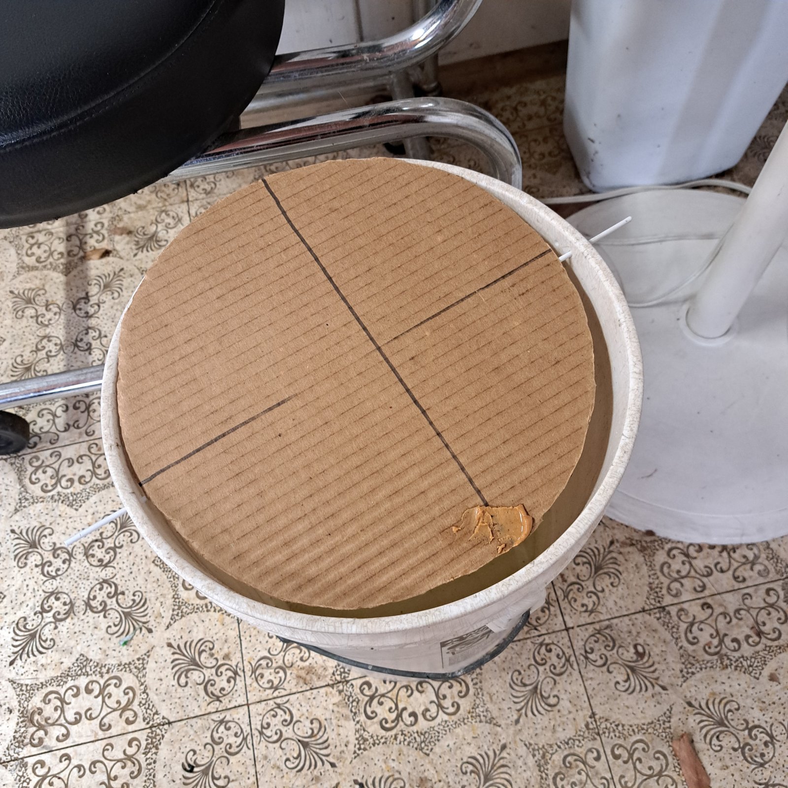

Making one of those traps tomorrow.

Made one this morning

Well, my home made 5 gallon bucket/water and peanut butter flip over round cardboard rodent trap is done. Had not caught any rodents and this morning a little chipmunk was on the front porch railing and he sat there while I drank coffee and talked to him. Just looked at me. I can't take the chance that the trap would drown him. Just can't. Will see what the rodent deterrent does, that I put under the cowling and in the blower motor housing hole.

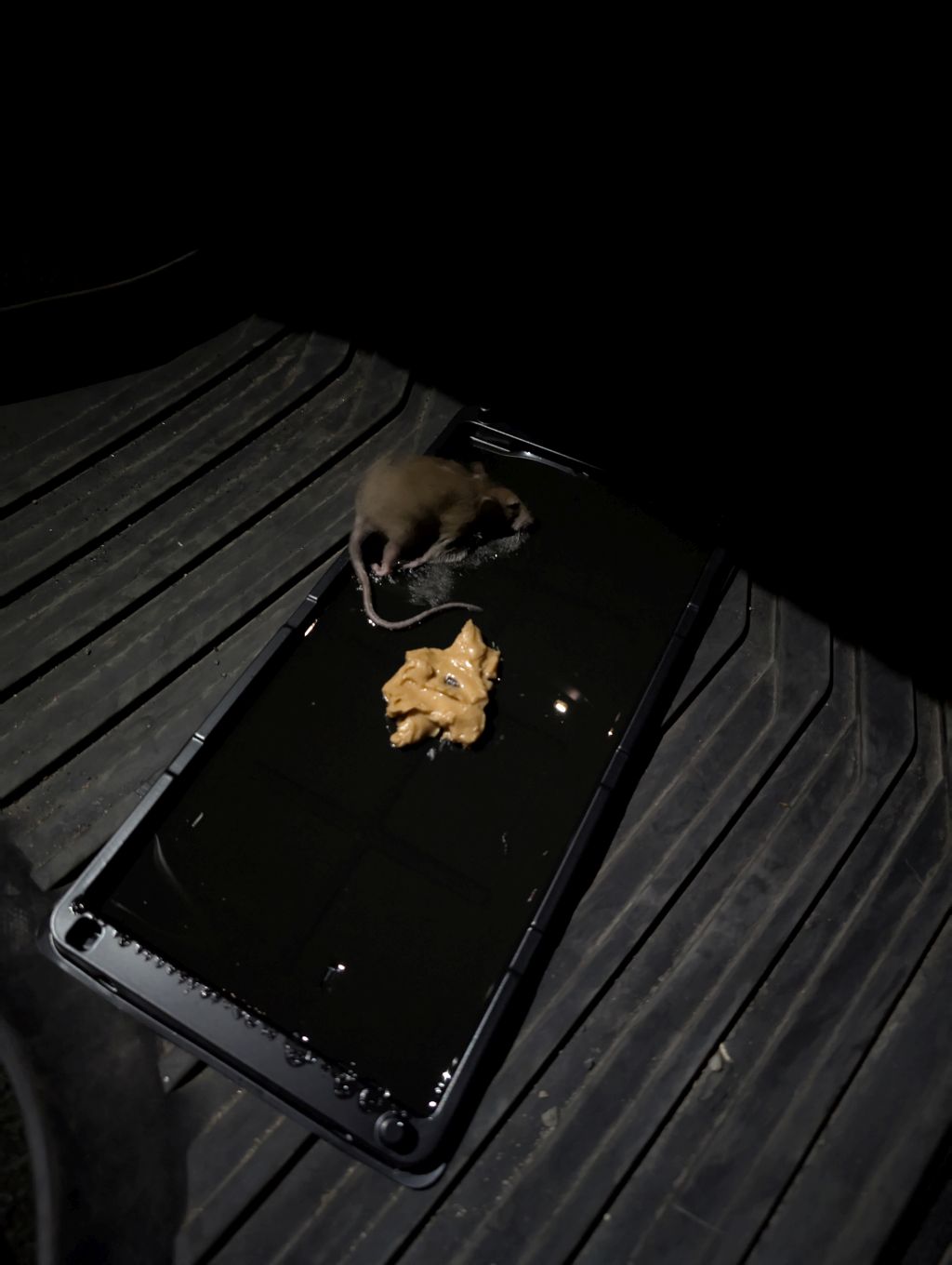

the wife told me the day before yesterday something was still chewing on her "snacks" in the suburban, so I put a regular mouse trap in overnight and the little sucker ate the peanut butter and didn't trigger the tap so I knew then it had to be a small one so in that case sticky traps always work, about midnight went out and checked. mission accomplished.
