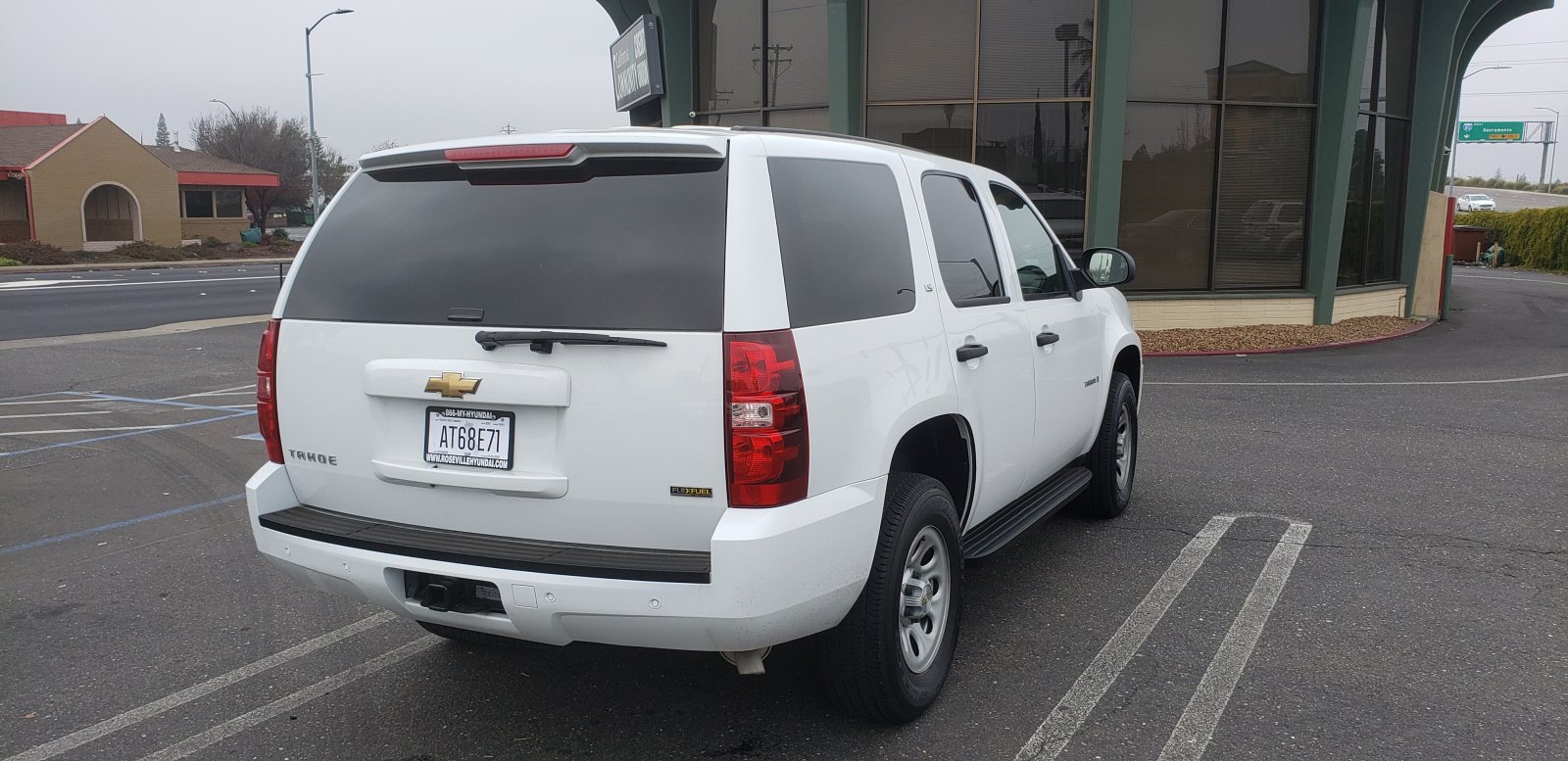

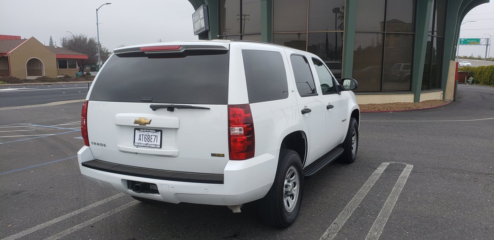

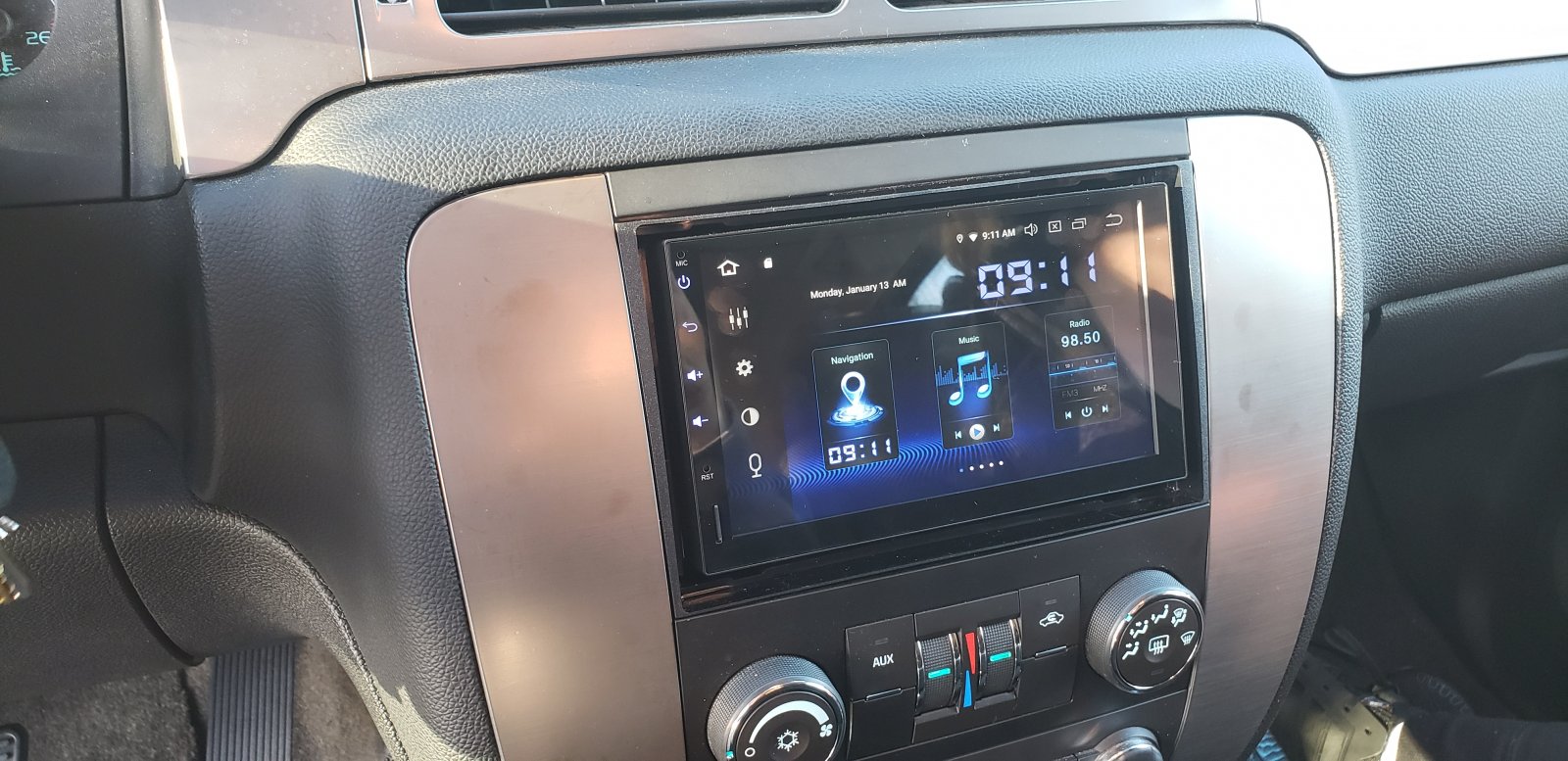

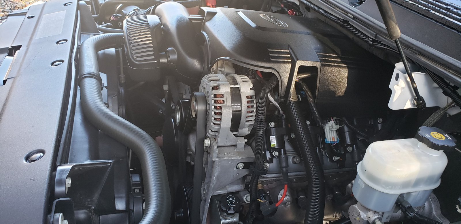

Ok so here are a few standard pics the day I got it. So thanks for the feedback, I'm definitely gonna look into black bear.

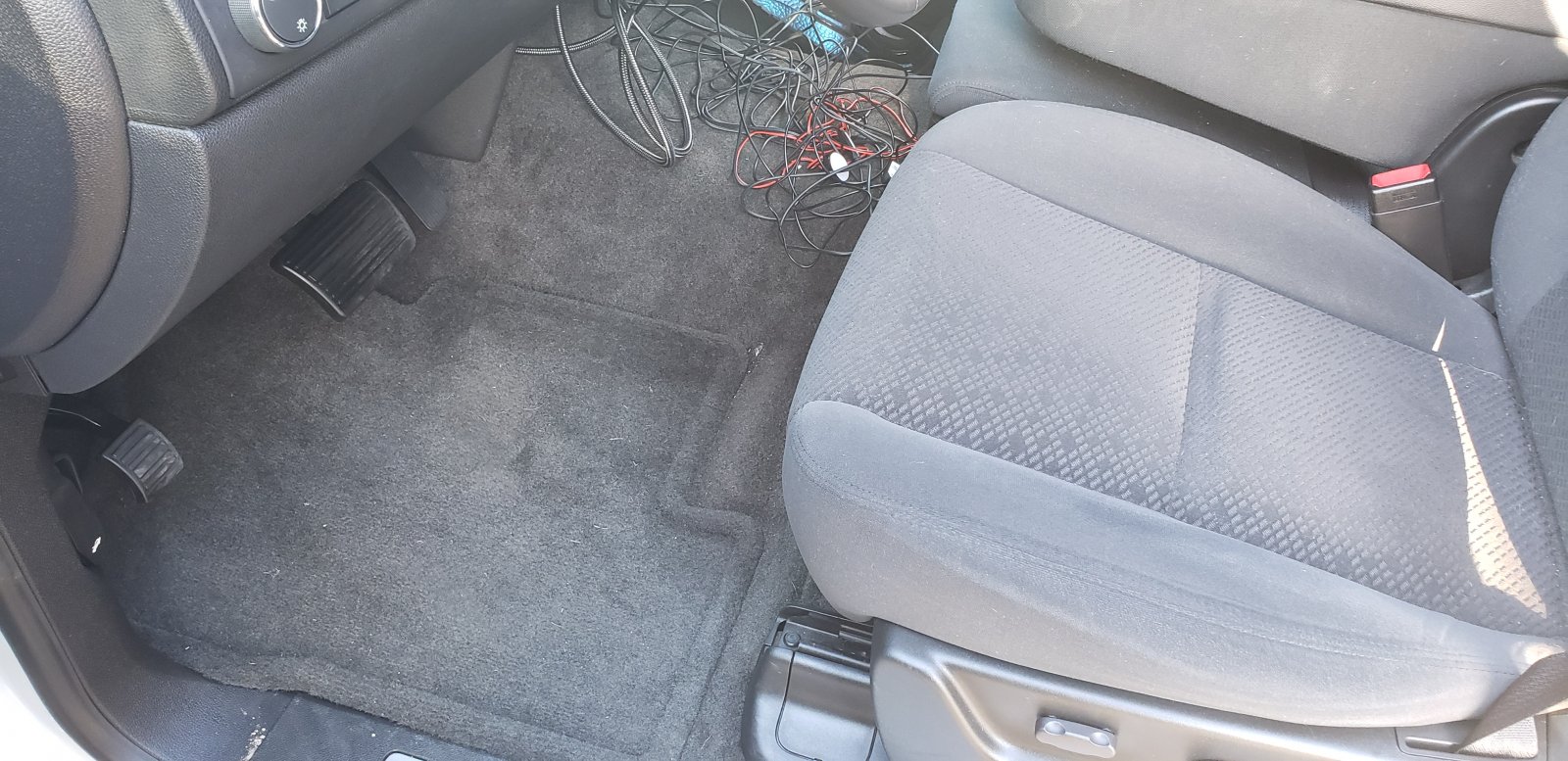

As for today's achievements I installed a premium jump seat, it orginally had no center console/seat. And installed a Dasaita 7" android touchscreen today. I most definitely recommend it, these android head units are amazing. But on the flipside the GM wiring harness kit sucks and it's way expensive 130$. But none the less I'm still happy with it.
Tomorrow's goals will be wiring and hooking up the backup camera, and maybe my weather tech mats will be in.
I looked at all the belts and hoses, they look fresh, no cracking or weathering. I will try and get underneath and inspect if the weather permits. Northern California is in for a week of rain.
I am curious about the leveling kit, any brand recommendations?
And i will get some more pics up
Cheers

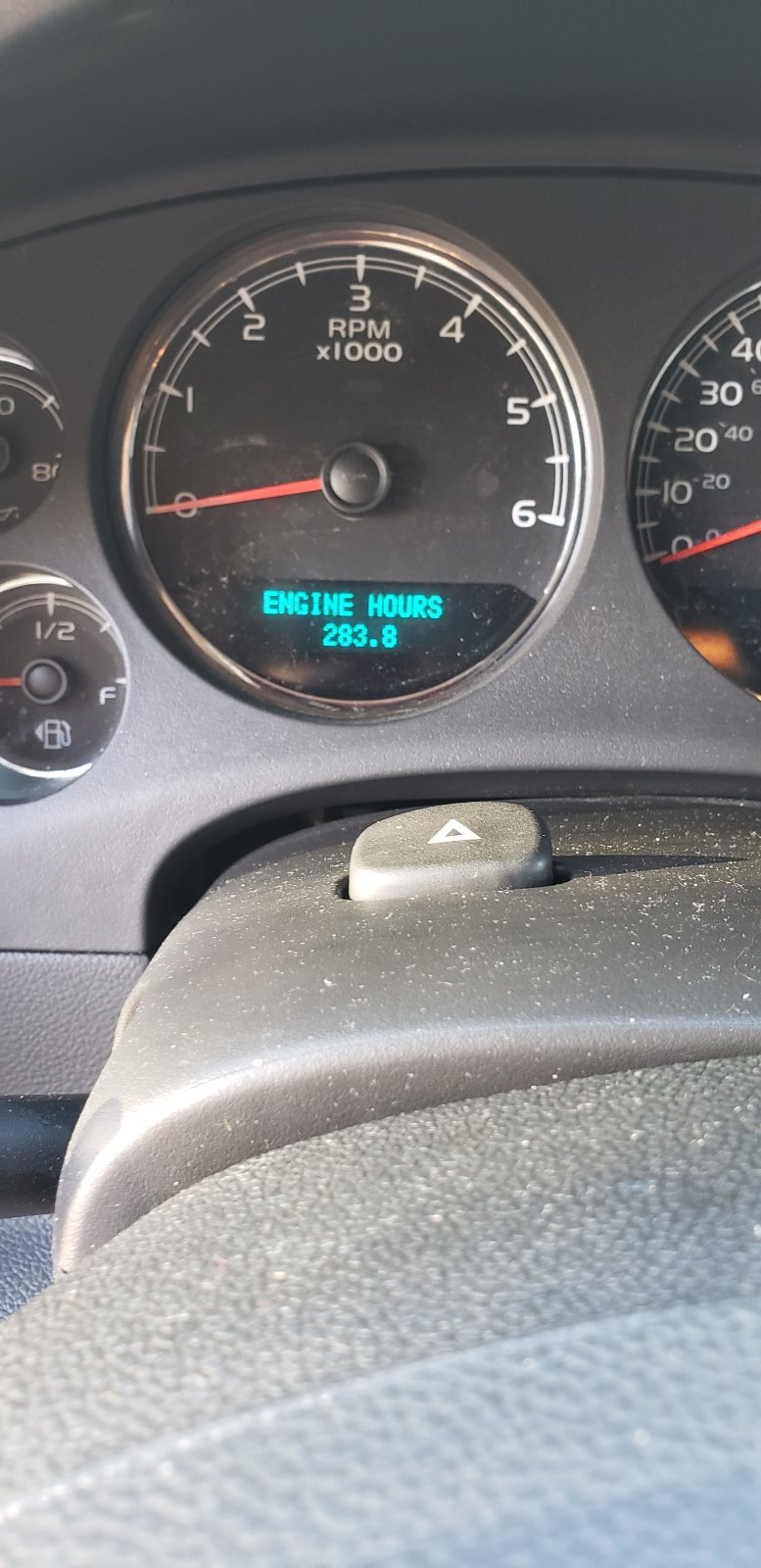

Do the DIC switch mod ASAP. I’m really curious what the engine hours are.

Pretty sure it's an SSV and, with those hours and the mileage, it's like its only purpose was to make a few highway runs ever so often. Lots of PPVs/SSVs can have low miles, but they tend to have high engine hours from extensive idling. Yours has low miles AND hours. No DIC switches, no center console, no body molding and those wheels all point to it being an SSV. Cool score.
