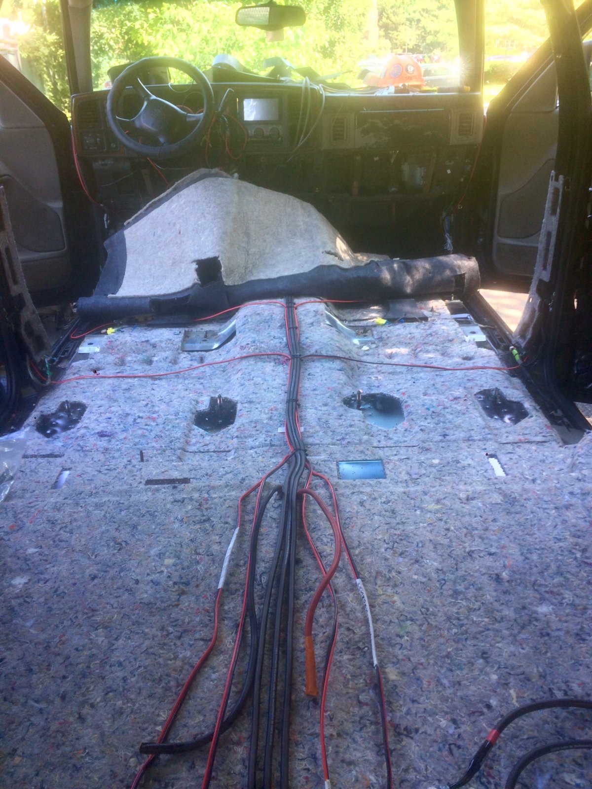

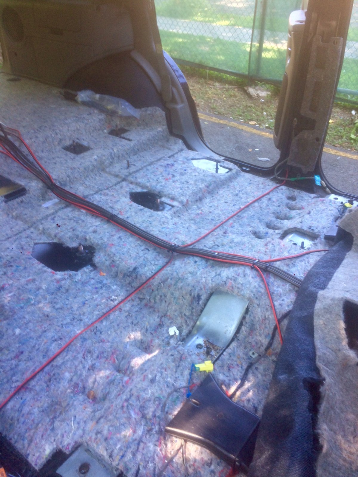

great job! it's sure nice to be able run clean wires that way! :)

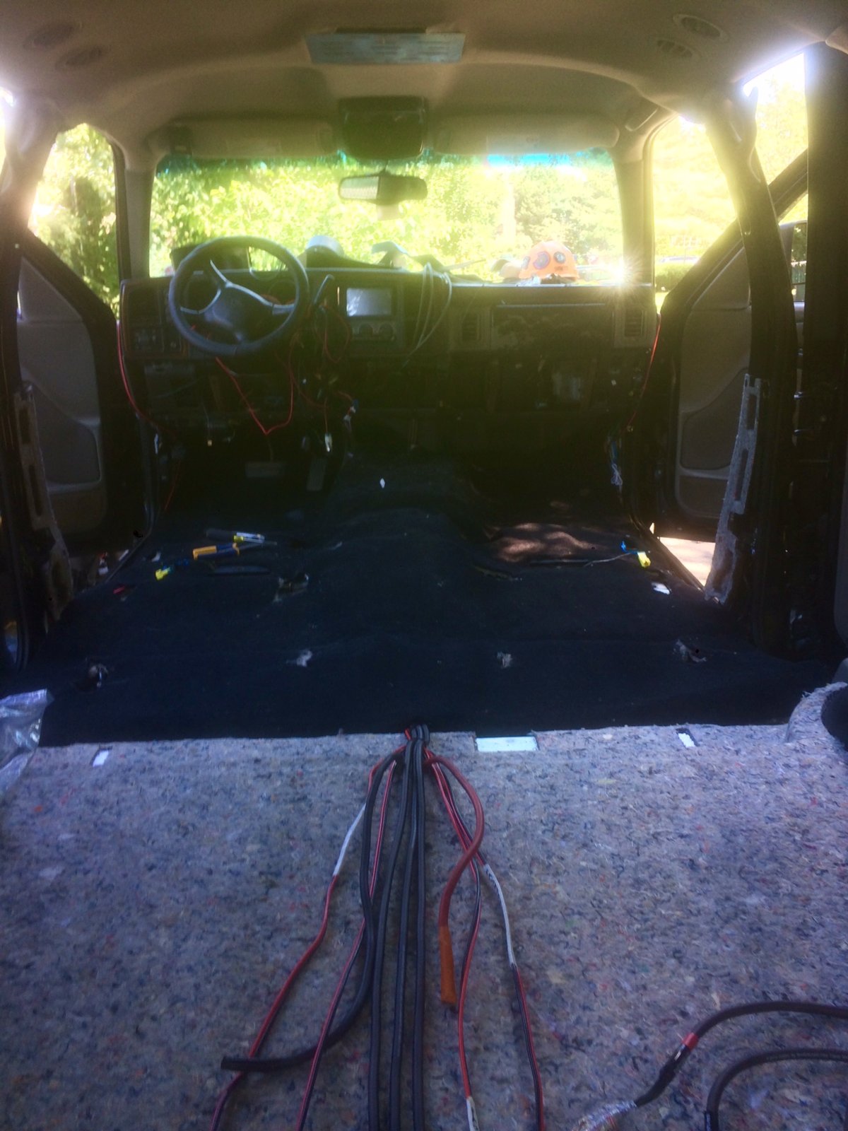

Thanks brother, I couldn't wait to tear that nasty carpet out and run everything nice and neat right down the center. My old man always told me, neatness is 90% of your grade... hence my OCD lol
Best part is I didn't have to fight to fit 3 sets of 2 awg RCA cables and 4- 12 awg speaker wires along the sides under the trim pieces...also, I was able to keep all the wiring away from the power wires to eliminate the possibility of getting any type of engine whine through the speakers

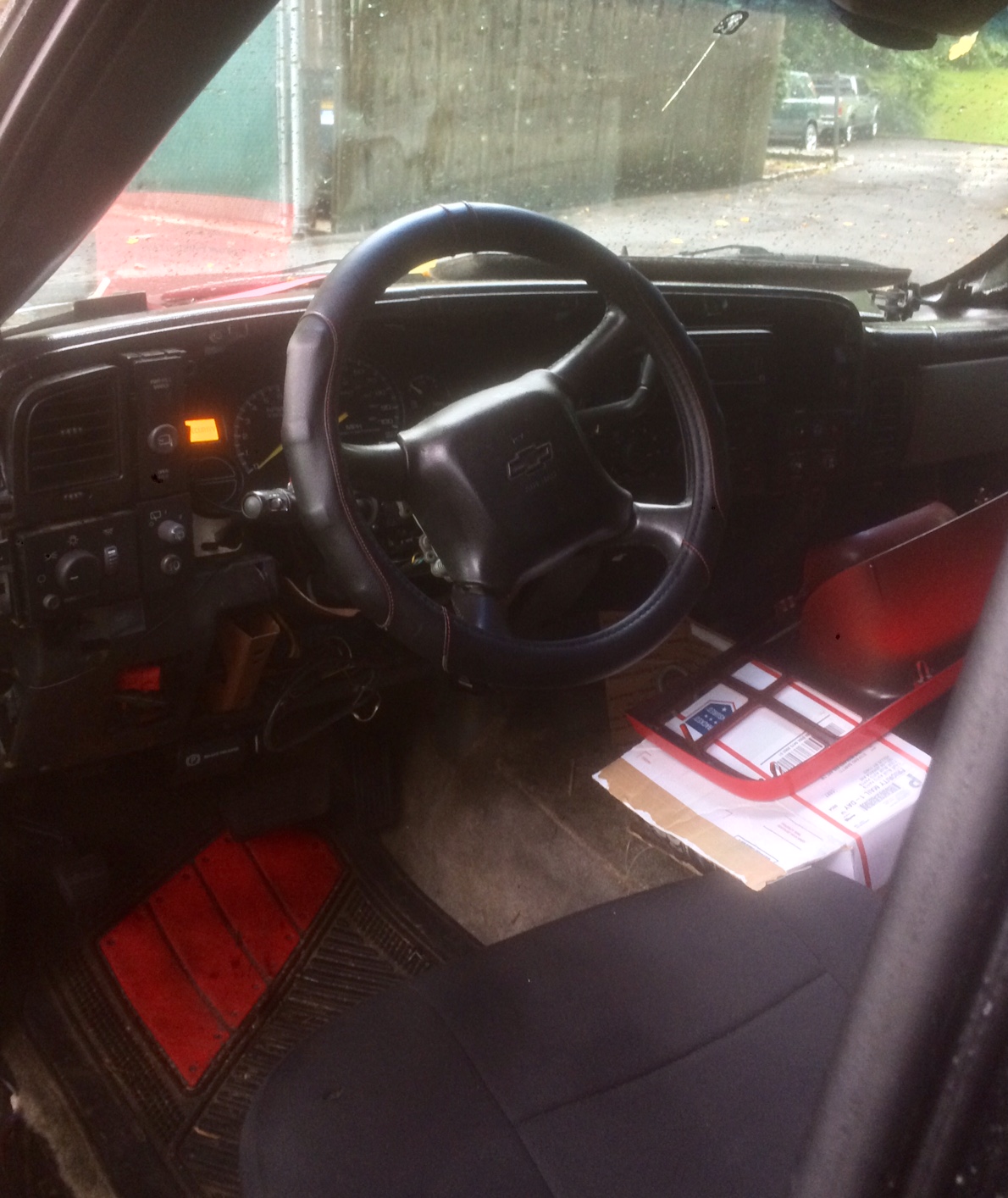

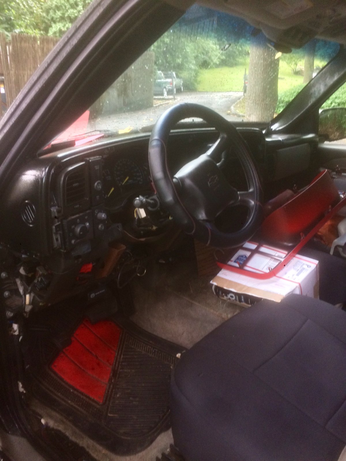

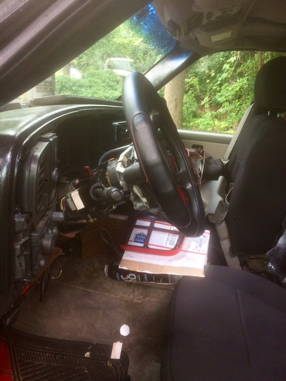

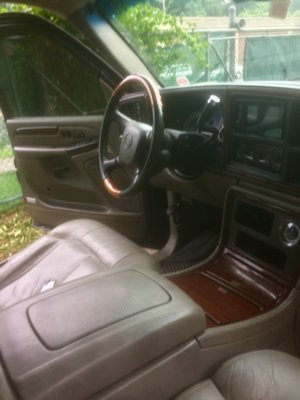

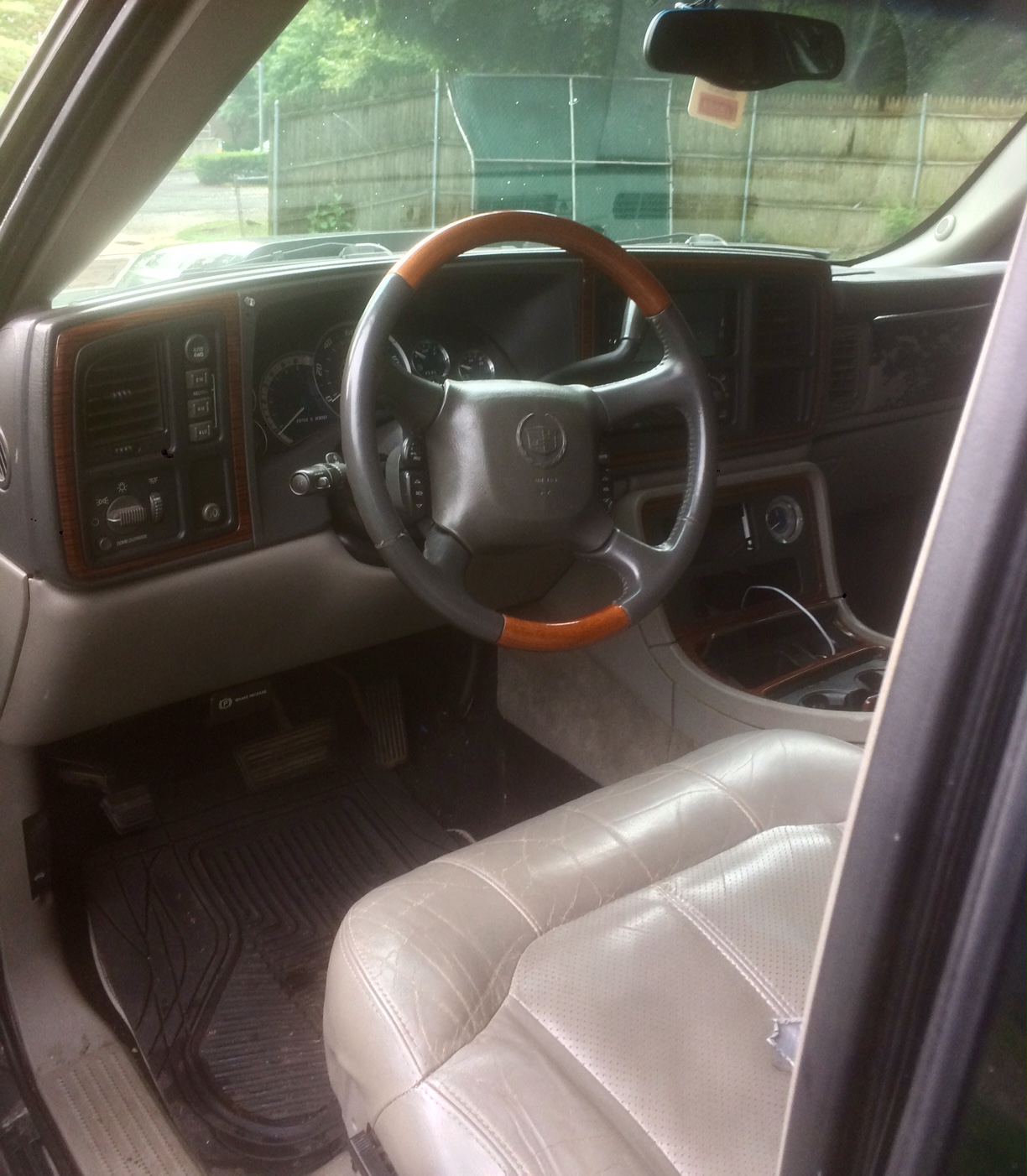

I finally figured out how to swap out the steering wheels and column shifters...took me about an hour to swap out both, another pain in the ass mod lol

I personally would've kept the Chevy airbag, but that's just me. Everything's looking really good though!
Thanks brother, the Esky steering wheel really ties in the full interior swap, the old steering wheel just looked out of place to me. The Hoe is now all business on the inside and a party on the outside! lol :head3:

Nah gotta go full out on the swap. Outside just a tahoe, hop in and every piece is Cadillac. I love it..:peace:

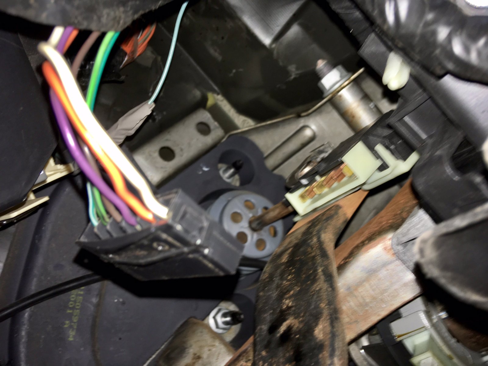

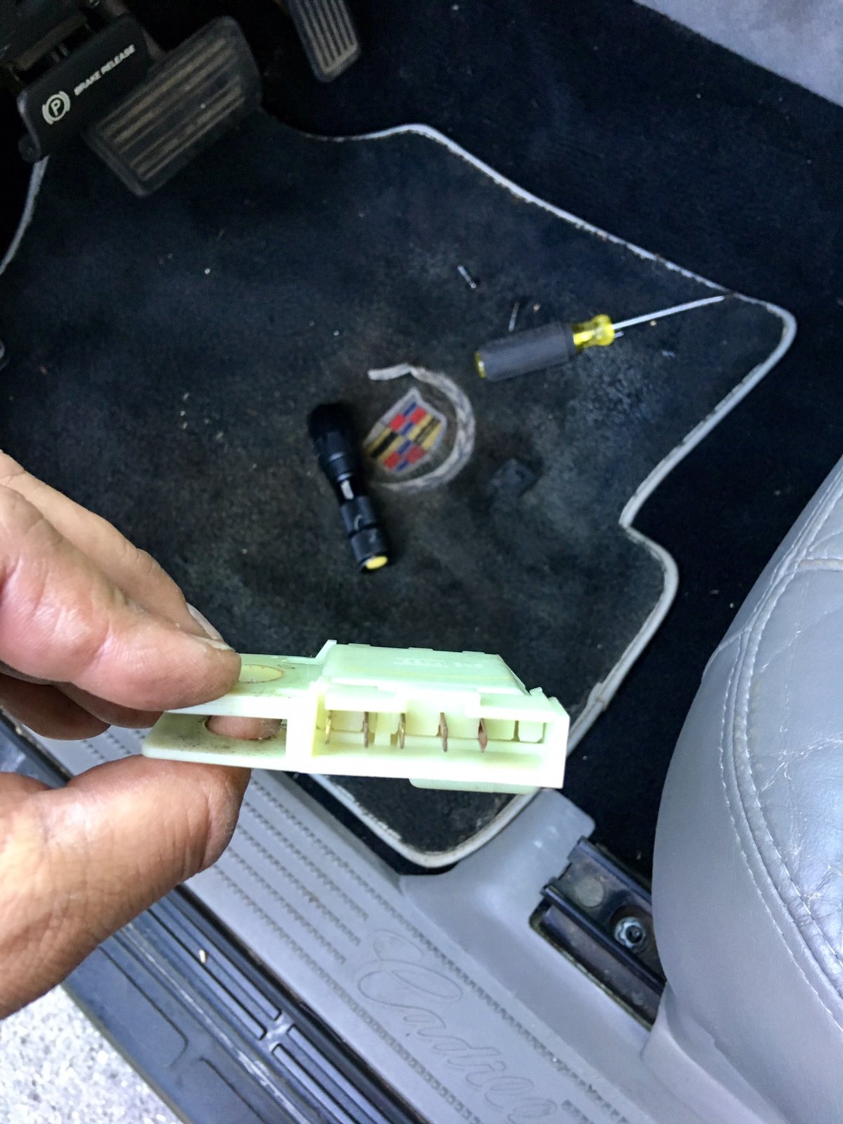

Back to my theory that the car wash guys may have damaged the brake light switch wiring while cleaning...I noticed as soon as I disconnected the plug from the switch not only did I have no break lights but all the parking lights, mirror lights, and blinkers stopped turning on while pressing the brake pedal
This is where I cursed GM for a good 2 hours!:fca5278d::fca5278d::fca5278d::mad3::mad3::mad3:... I'm 6'3 265 lbs and couldn't for the life of me get myself into that small ass area under the steering wheel to disconnect the brake light switch which is attached to the brake pedal...I had my neighbors kid get in their to try and get it out but he kinda broke it removing it
We were able to remove the brake light switch from the Escalade since theirs no interior but it didn't seem to fix the problem...not sure if they're different from the Tahoes???
