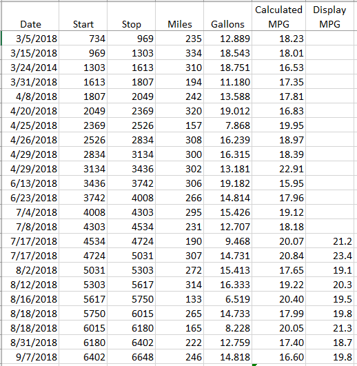

Jan 31, 2018
15
I bought 2018 Tahoe rst with 6.2 and 10 speed transmission need feed back on mpg please suggest . My mpg in city driving are at 9 mpg is it because it new . And it city driving with flow of traffic not stopping for ever.
I have a 2018 Yukon Denali with the 6,2 and 10 speed. I have tracked my mileage since the day I got it. I saw a slight improvement around 5000 miles. You cannot go by the MPG display on your instrument panel. I started tracking the calculated MPG against the displayed MPG and found that it is rarely even close!!! My spreadsheet is pasted below:
