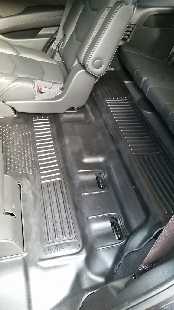

got the 3rd row liners in. If you guys are interested in the husky kit just hit me up. I can save you over summit or jegs.. or anyone else. The rear is fully covered so should help out with my kids dropping stuff

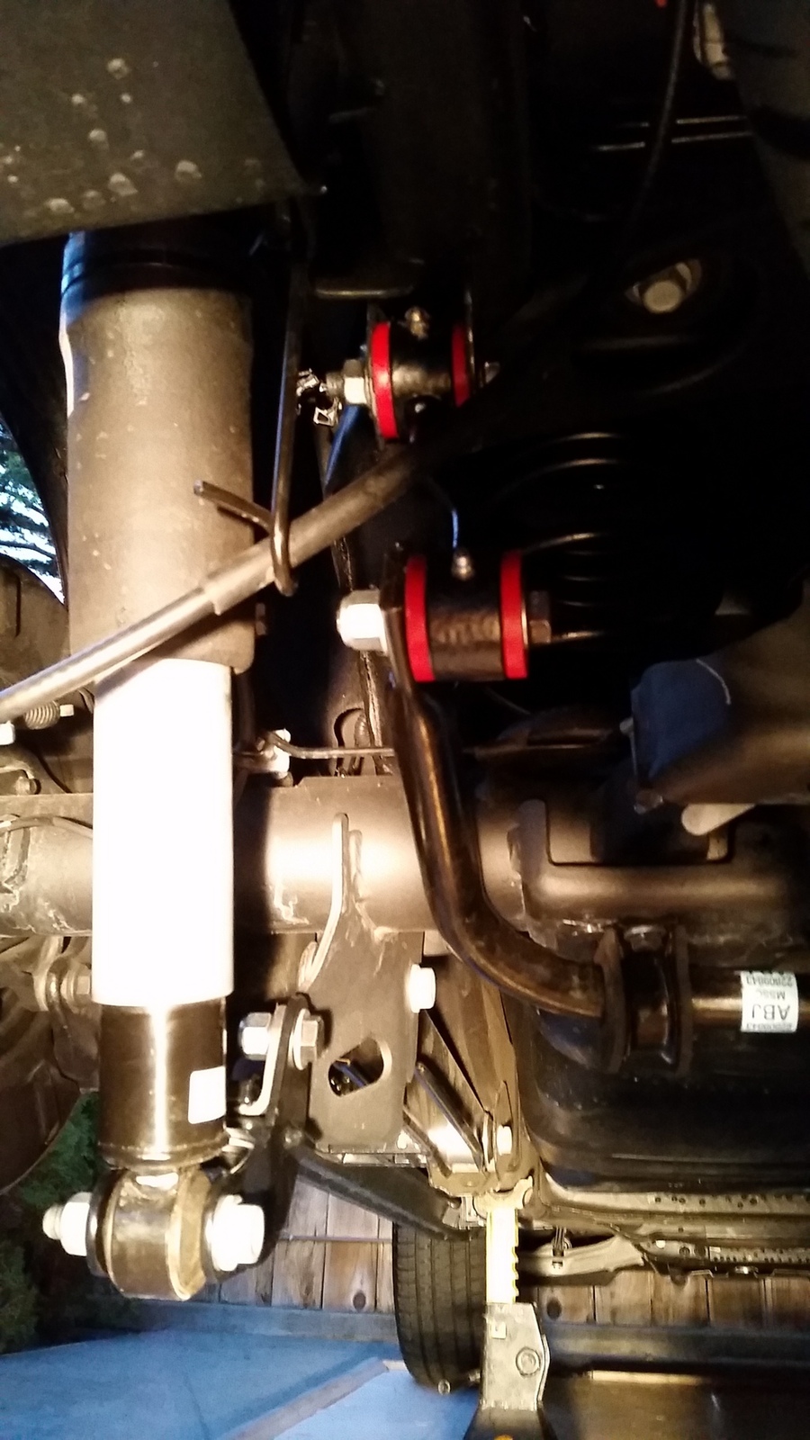

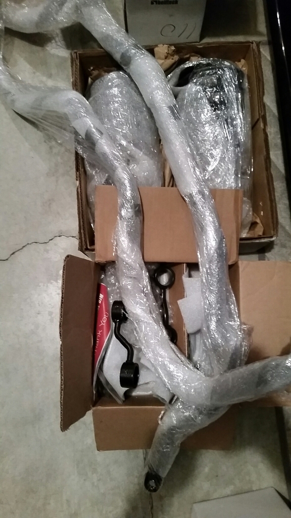

i ended up buying front/rear energy suspension greasable swaybar endlinks. This makes it cake to grease it all and i will offer it for my ultimate cornering package for the 15 up gm suvs and yes ocd taking over i will be getting the brackets powercoated to match the bars.

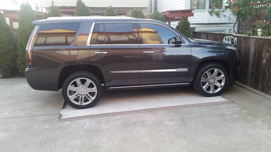

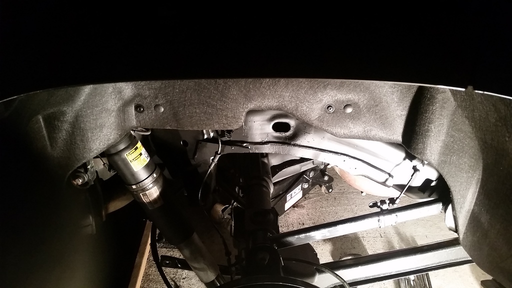

so worked late today but got few things done.
Truck was at 35.5 front rear comes in at 38 1/4 ground to fenderlip
Did the free tavel mod on pass side bracket cut off which gives 3 more inches of travel finish up drivers side tomm. Ill prob go back to grind it smooth to the frame but for now just want to get it dropped
insulators on these things are big. I just wrap heater hose on top and bottom coils on them but the oem ones give the truck a 13/16 lift
Belltech 5305 coil left vs oem spring right. Yes i had the belltech springs coated to match oem. OCD strikes again
NORCAL SS
NORCAL SS
SUV SUSPENSION GURU
Jun 9, 2009
8,744
610
Finished cutting the drivers bracket put the belltechs in along with the djm links. Rig rides nice and came down 4.25 inches..... but its not low enough for me Ill post up pics with the rear dropped tomorrow. Im planning to do the swaybars and front drop this weekend. I have a feeling ill be putting in my custom spring in rear and getting rid of the autoride to slam it.
