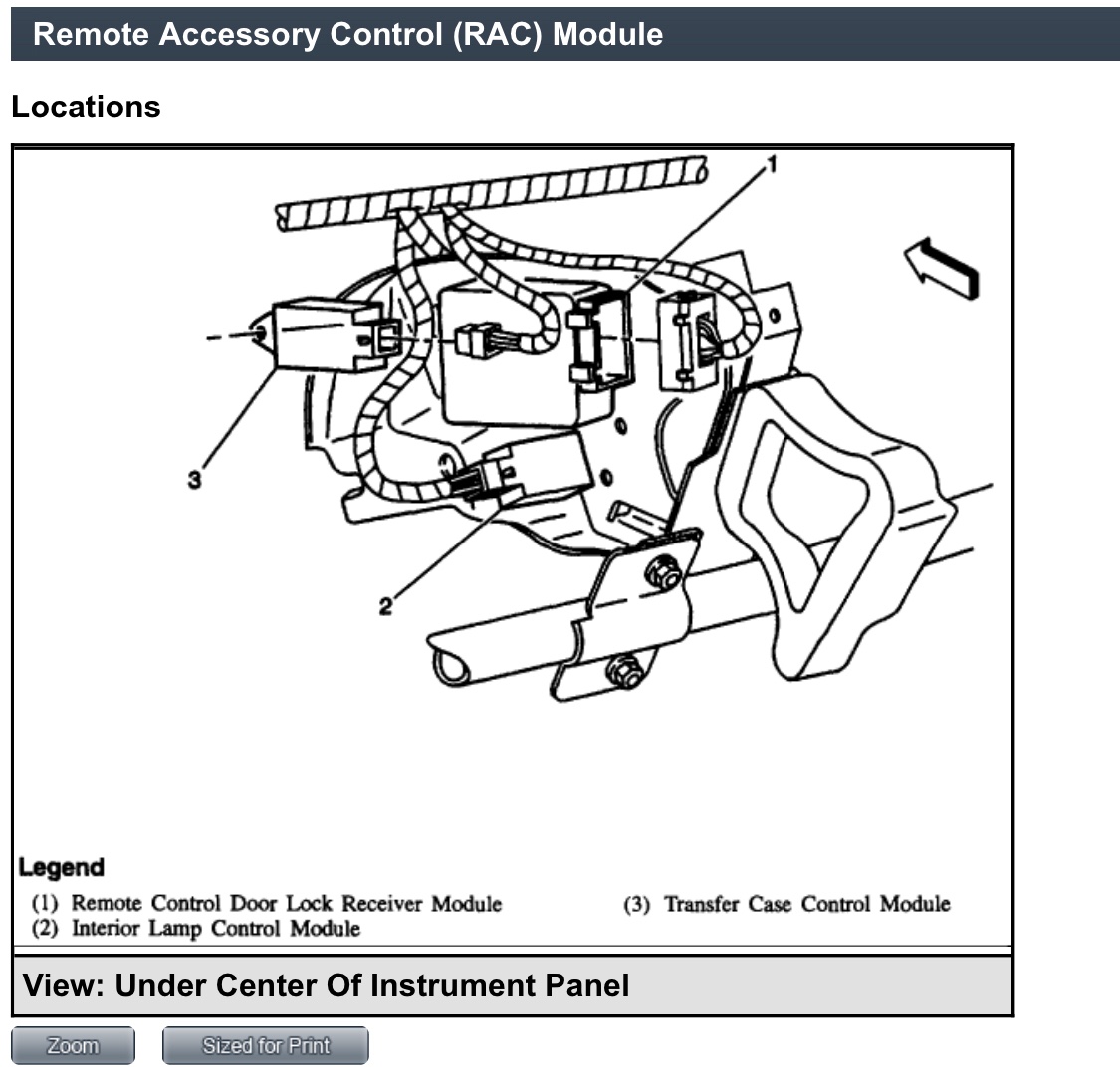

Where is the remote receiver located? Can it be tested?

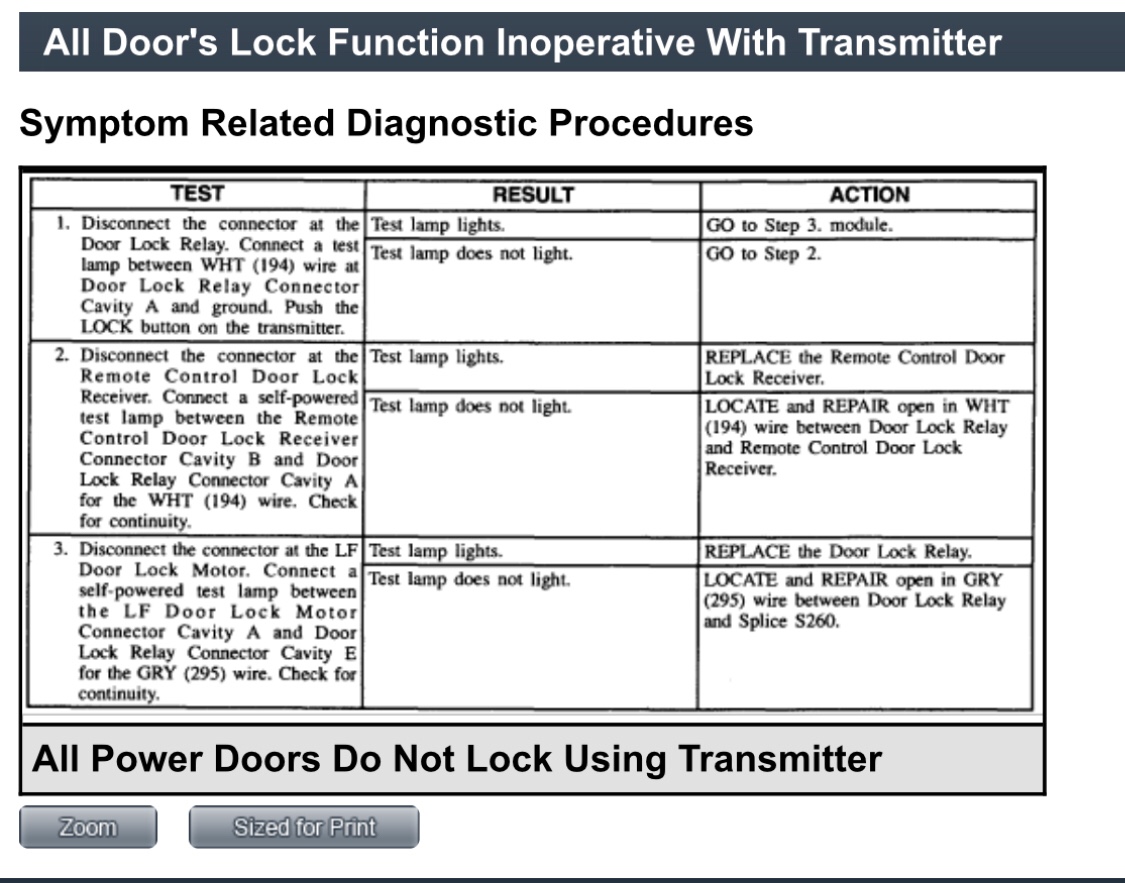

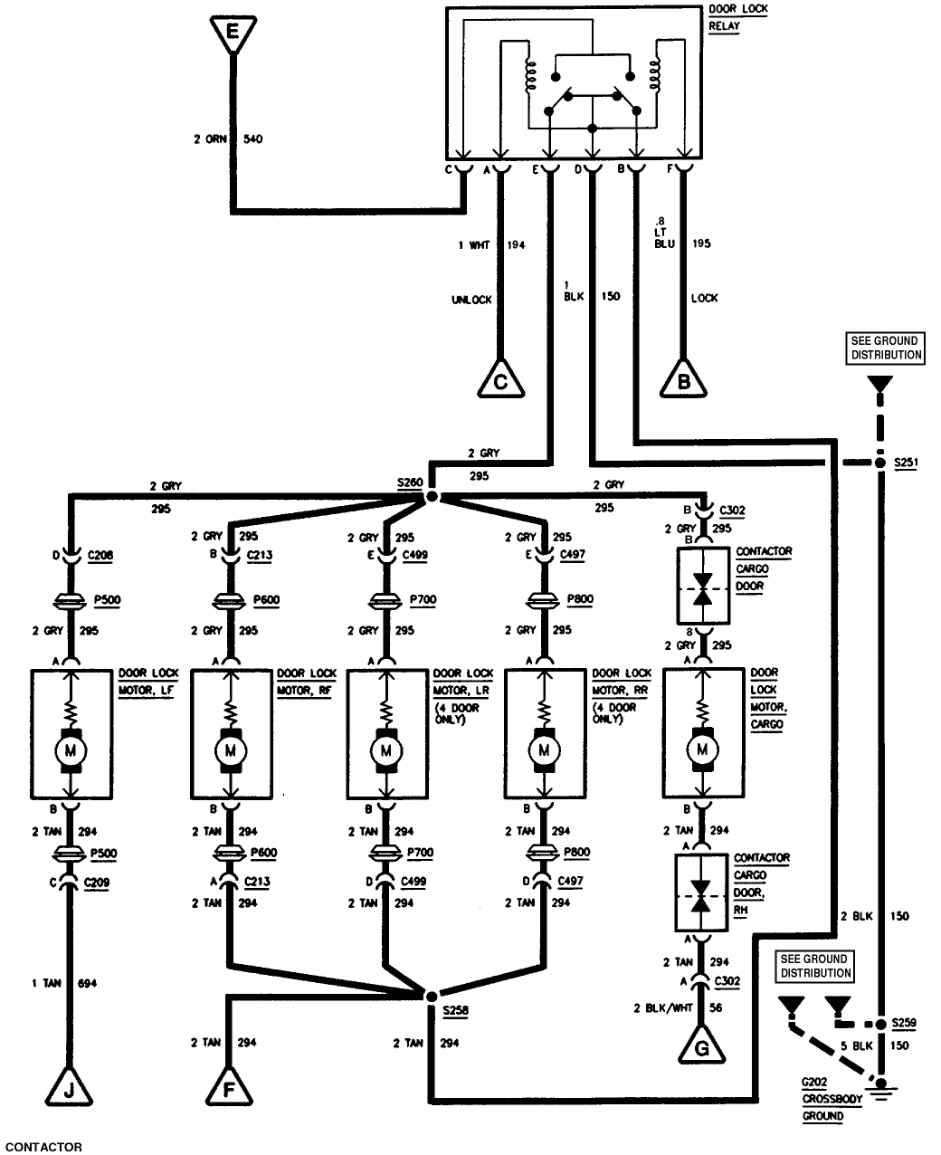

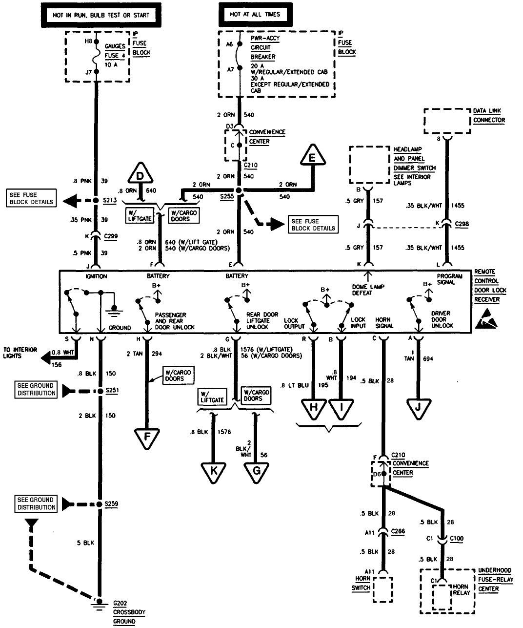

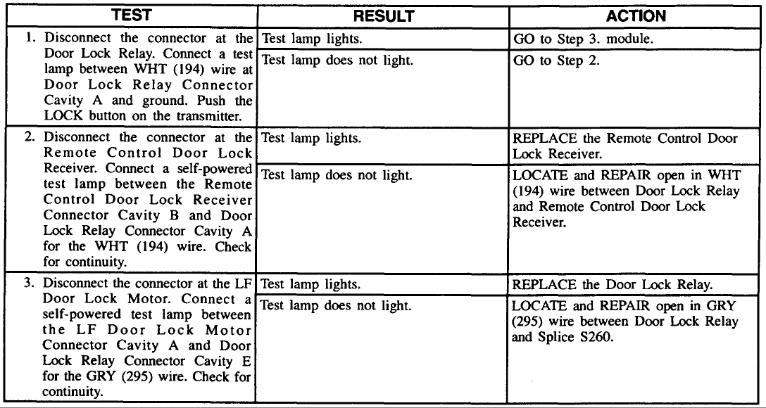

Here are the diagrams as it relates to keyless entry, the thinking being that it would be more likely to have an issue there instead of all actuators at once.

I swapped out the relay with no change.
The drivers side still consistently works with both the remote and the button on the door. Though sometimes the drivers door doesn't always snap into locked or unlocked position.
The pass side never works, with the exception of the pass/rear door which will unlock once every 20-30 or so cycles. Pass/front never works... though I can see movement, just not enough. Some days show more movement than others but never more than a 1/4"... maybe 1/8"
