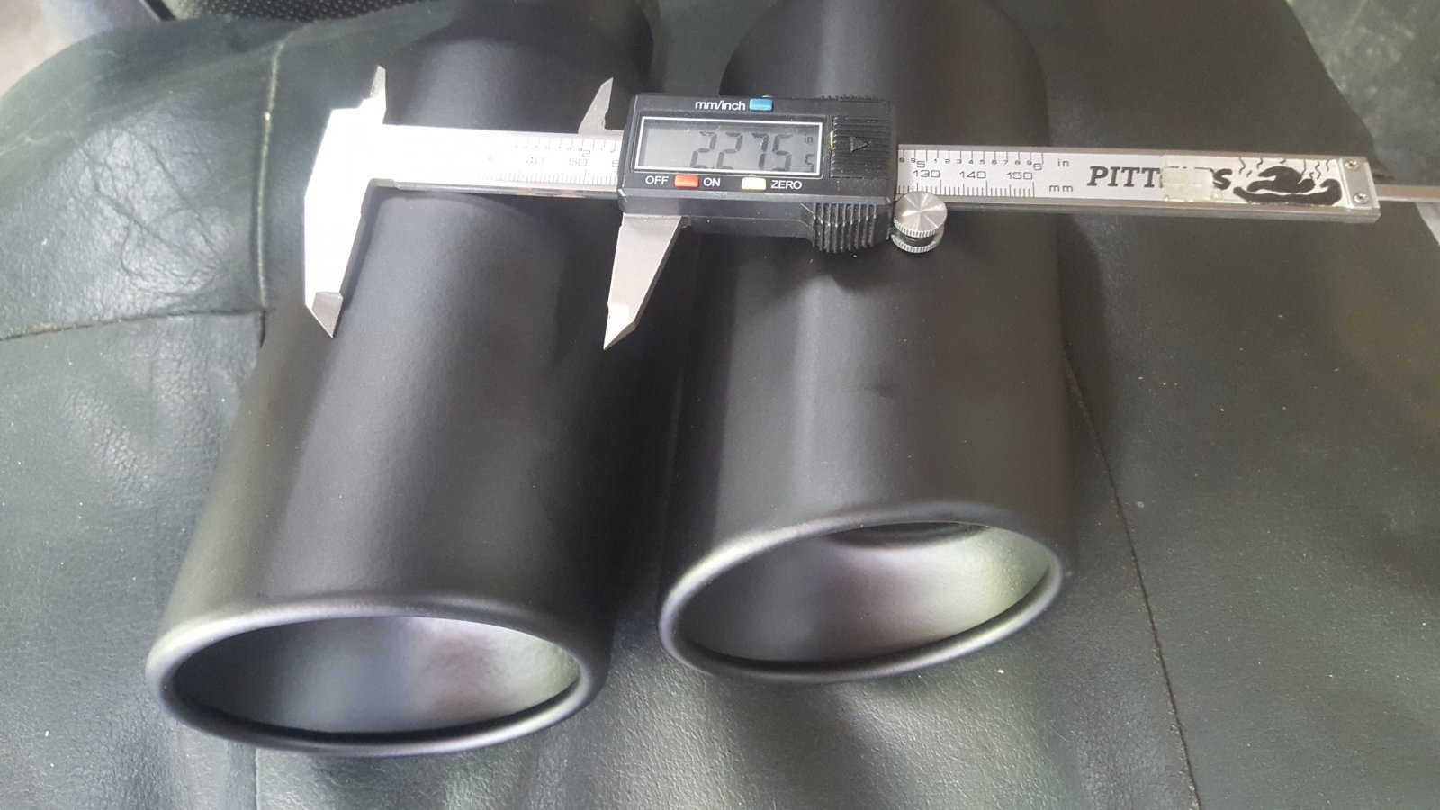

......during my process, I learned that they use the same "can" for the Ford 2.7L turbo V6 as they do for the Ford 5.0L V8 and the GM 5.3L V8.
Found this one on the market book yardsale 3.5hrs away in Knoxville. Initially blew it off when I discovered it was bought for and installed on a 2.7 F150 for approx 1500mi. He said it wasn't loud enough(I though what would be on a 2.7L?) But it was so pristine that I kept going back to it. After enough times looking at it, I wanted to know why it couldn't be made to work for 2011 GMT900? What was different about the muffler? **Because the rest is just stainless pipe, it can be made to go on a lawnmower if you wanted** After closely comparing the two diagrams below, I was curious enough to call Borla and find out. Three calls later and I offered the guy a ridiculously low number and he said yes immediately. Said he was tired of stepping over it
