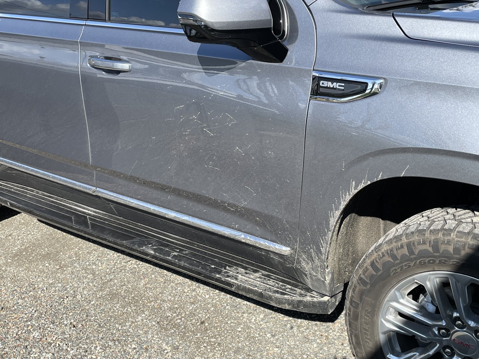

We have a '21 slt with fixed running boards and I can tell you without the splash guards this rig is ALWAYS dirty. The tires kick up everything from the road (or in my case a gravel driveway) and it shoots all over the side of the truck and covers the running board. I recently bought weathertech guards but haven't found an extra 10 minutes to put them on yet...

Every vehicle I own has Flaps PERIOD. Saves the sides of the vehicles so much from rocks and tar and everything basically. Unless it is a sunshine weekend vehicle, get appropriate flaps on ASAP!

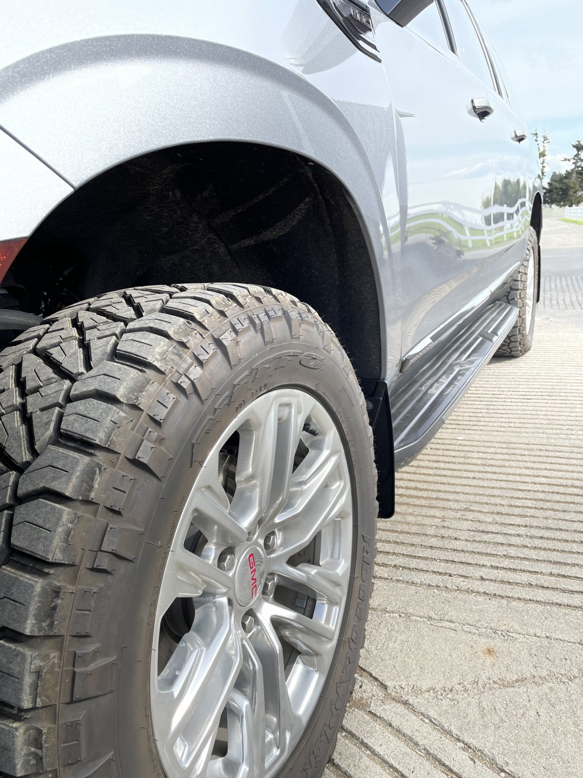

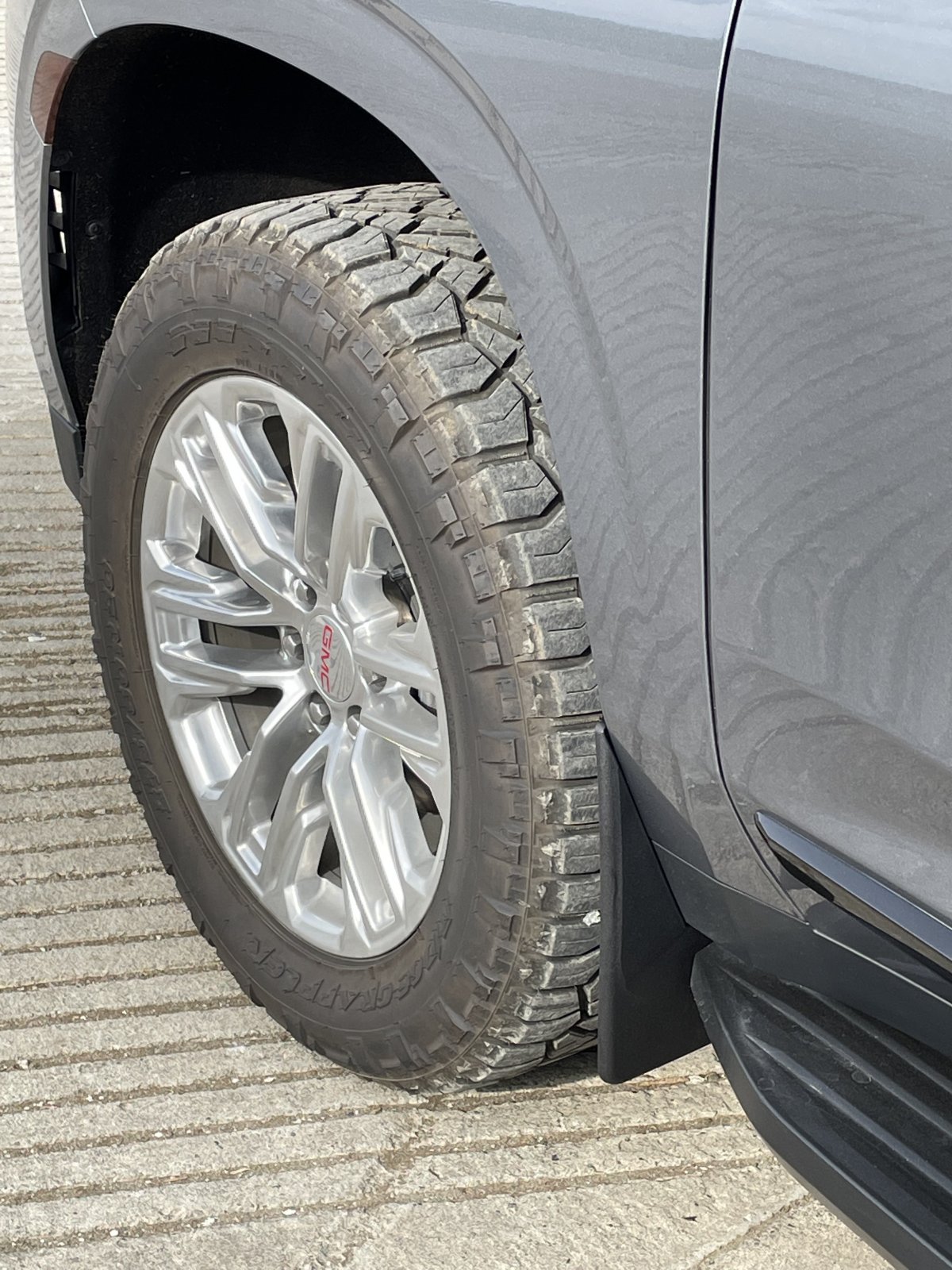

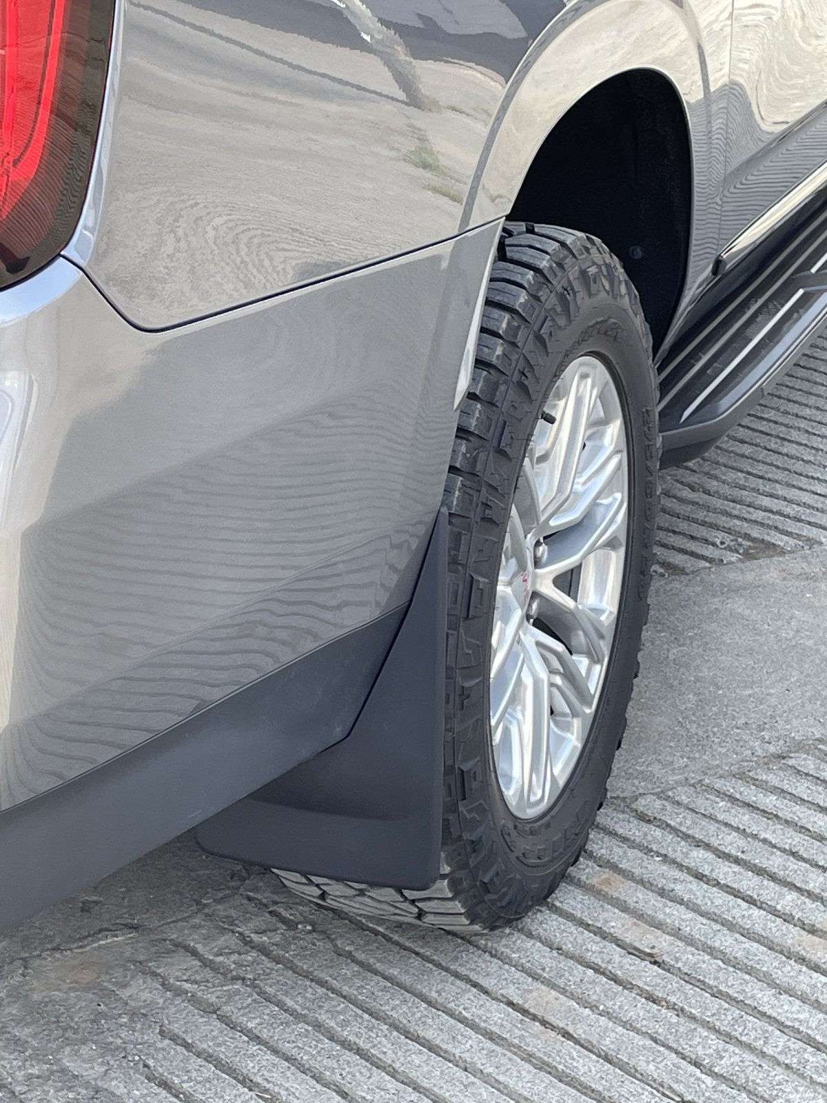

Installed my weathertechs yesterday and it did not go as planned. I'm not sure what the deal is but the holes on the rears were not in the correct spot to easily be screwed on. I thought I was crazy at first but ended up having to drill out the middle holes into kind of an oval shape in order to get all 3 screws installed. I'd be pissed if it wasn't an easy "fix" but still annoyed as I spent probably 45 minutes screwing around with them when this should have taken a fraction of that time. They look great installed and fit the bumper contour very well.
The fronts took literally 5 minutes to install both sides. It's raining today so will get to see the difference after coming down my driveway that makes all vehicles filthy.
View attachment 369320View attachment 369322View attachment 369323
Funny you say that because I had the exact same problem in the rear with my Husky flaps. They work great and I think look better then the Weather Tech but the rear holes were a pain.

Luckily my weathertech's lined up, cause I'm terrible at improvising and I'm not at all mechanically skilled. The fronts gave me the most "trouble" just with torquing the furthest bolts trying to get around the tires (even with the wheel turned) but overall took me an hour or less. After a few drives I snugged the bolts and screws again just to make sure they stood tight and so far so good after a few weeks.

My weather techs were a little difficult to install on the rears, but was fairly easy to resolve..the threaded clips under the rear bumper in the back just needed a small reposition and that solved it.

These have made a world of difference stopping the mud and crap the tires were shooting all over the side of our ride. They’re not stopping 100% of it but doing a really good job. Should have got these on day 1
