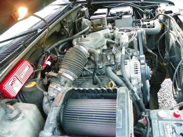

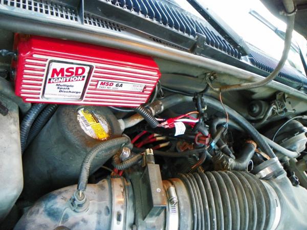

Here's a couple of installed pics. I didn't get a chance to install the coil today. I'll try to get the shop to install it. :)
I can't wait to try it tomorrow in DD usage and see what happens...Holidays are over...sigh...
