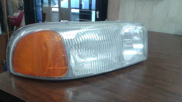

annoyed! The '03 Yukon has clear set of headlamp and daytime running lamp on Pass side, then like this set of old/cloudy OEM head/corner lamps on the driver side. I would like to replace the set on DS to match the nicer lamp lenses set on PS.
Do the cheaper knockoff units on eBay match the factory setup? Or do they look different? If anybody has a set for sale, please DM me. Needing the DS side SET.
Furthermore, will polishing the dull lamps give them a clear luster? It just seems to me they are the originals & possibly manufactured that way.
I'm beginning to think I will have to buy a 4-piece set if I want it all to match.
Pass side lamps are clear as ice.
The driver side lamps look like this.

I think it'd be much easier to buy a new full set than to try and find a match, but it will be a little more expensive.

Meguiars level 2 fine cut cleaner, mixed with some elbow grease, should clear up as good as it's gonna get... 2 coats are better as you will miss small spots in the first go thru...
Wax pad, big glob of stage 2 fine cut and go to town, don't be gentle as it's the only way you'll take the glaze and yellowing off the headlamp. And it's great for other uses, but I have it mainly for all my lamps.
And from looking at the light, you wont get those lines out of there, but you will clean up the outside like new, which will help a little, and it's great for the biannual wax and detail.
Good looking lights help bring personality to the truck.

I agree, the clearer lenses make the truck look better. even photos of old trucks I see on the web have these same dull lenses. and the photo above isn't my headlamp, its just 1 I pulled off of Craigslist that is identical. My concern is that trying to polish the original lenses will not necessarily bring them to a clear luster, if they were never "clear" to begin with.
