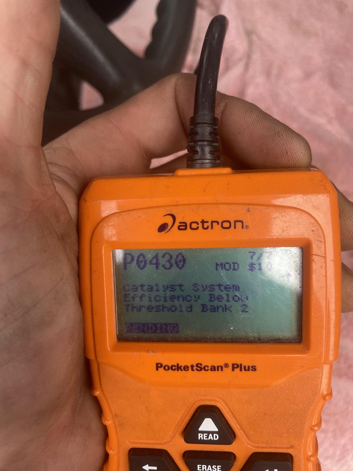

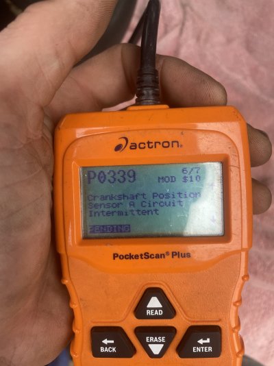

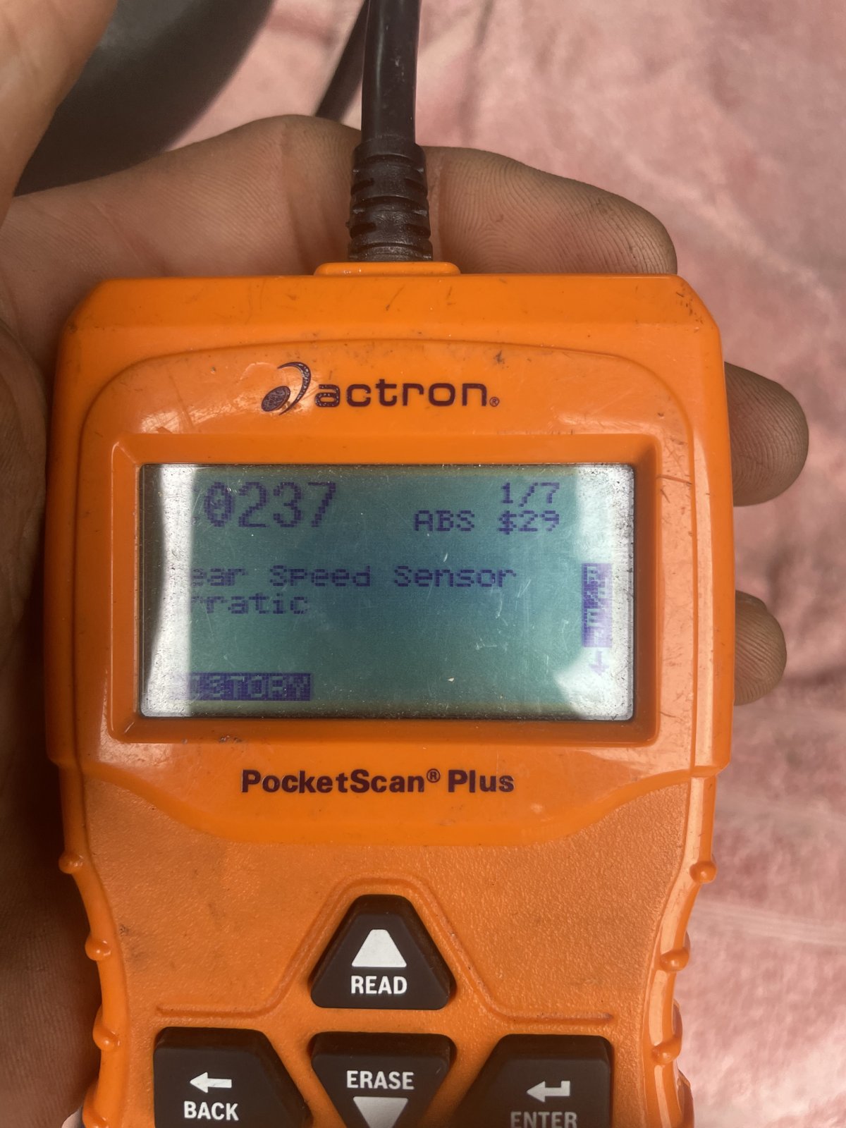

1999 5.7 ppv.
Changed cap and rotor plugs wires and at times it will run like total garbage missing a backfiring.
Other times at 55mph and up it will almost studder or hesitate for a second
Plz help

AEE245E6-C871-4C4F-8303-779EC2FE571D.jpegI’d say so smh

Any P0300's or P1345?
Have you updated the engine grounds? You are running two posts now. Coukd be connected.
OR VietVet
Multnomah Falls
Oct 8, 2014
15,855
22,843
Willamette Valley
Vacuum leaks? Cat convertor problems? O2 sensor problems? Did all those codes come at the same time?
exp500
May 14, 2017
1,693
1,473
Post #5- Not sure that issue fixed yet. Could be connected.
C
Cpurp31
Nov 7, 2021
8
I think it could be connected. Idk if the ppv’s came with a push button start but this one has one. I’ve ran new wires since then. I’m going to check body grounds tonight
C
Cpurp31
Nov 7, 2021
8
Yea all codes came at same time. Could be a vacuum leak. I’m just hoping it doesn’t have anything to do with injectors
